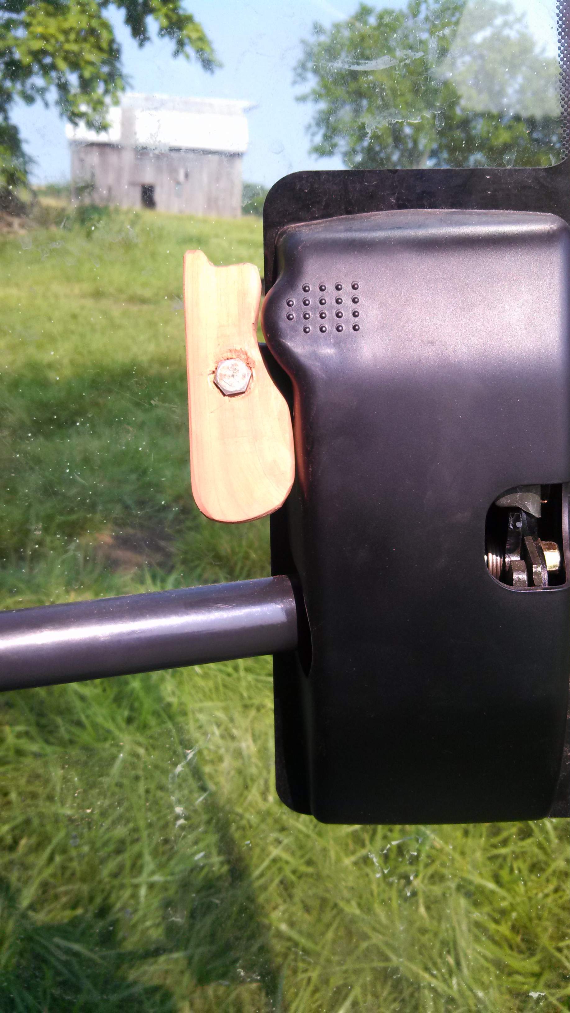

The right inside door latch has been hard to open for the last year. The little latch has to be rotated and pulled to open and if the proper rotation is not apply the latch doesn't work. Bolted a piece of wood to the latch and is a breeze to open now. IMG_20150704_100155_306.jpg
