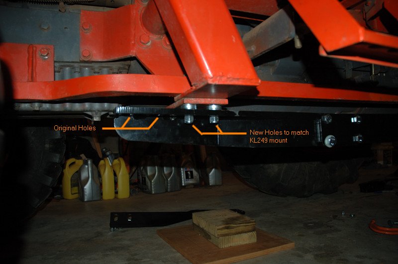

I have the same tractor and loader you have. I found a Craigslist deal on a woods bh80-x backhoe. I bought the 4-point sub-frame mounting kit,(woods #1011025) it does not bolt up directly to the loader. I drilled holes in the front arms, and added some spacers to make it fit. The 4-point is a better mount in my opinion. I can take a close up picture if you'd like.

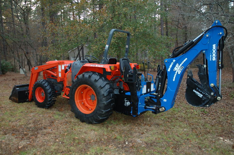

Just an update on what I finally did on my DK45. I ran across a great deal on a Woods BH90-X. Not in Orange but in New Holland Blue. My wife has already nick named it "Ole Blue". I did get the 12" bucket since I will mostly be digging stumps and trenches.
I ordered the 4pt subframe 1011026 and must agree that it seems the best way to go. Only takes about 15 minutes to remove or put on the backhoe by myself.
Woods did say that technically it would not fit.

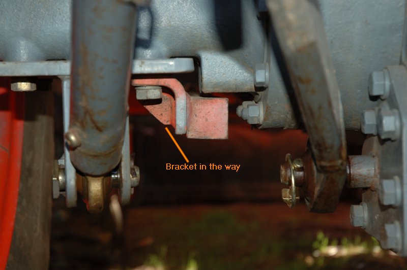

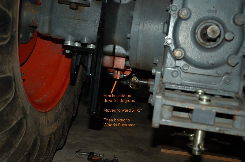

My thanks to Bonz for the tip on the front bracket. I have included a picture of that. In the picture it shows the oversized washers I used initially to get the spacing. I have since made some spacers out of scrap steel.
Woods had said their subframe would not fit because of the bracket on the support arm for the KL249 loader where it bolts on at the rear of the tractor. My solution was to cut the bracket off the support arm, rotate it down 90 degrees, move it forward 5 1/2" then weld it back to the support arm. That allowed the woods subframe to slide into place and still allowed me to bolt the KL249 support arm to the woods subframe there at the rear of the tractor. See the attached photos.
I've only done a little digging, practice off in the woods so I didn't draw a crowd of laughter. I see lots of time together with "Ole Blue" doing some digging. Being a novice I also like the control to slow down the swing.
