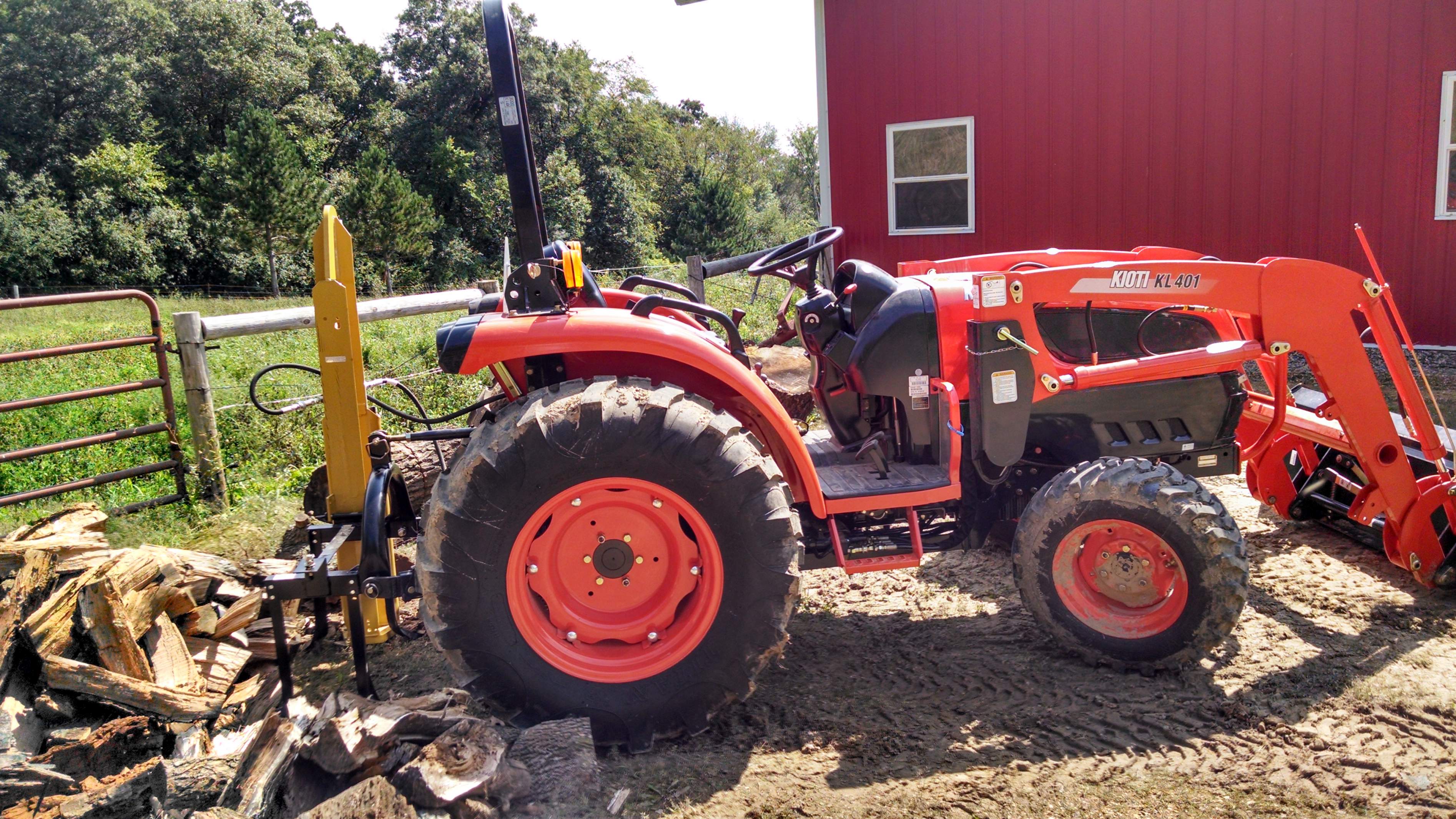

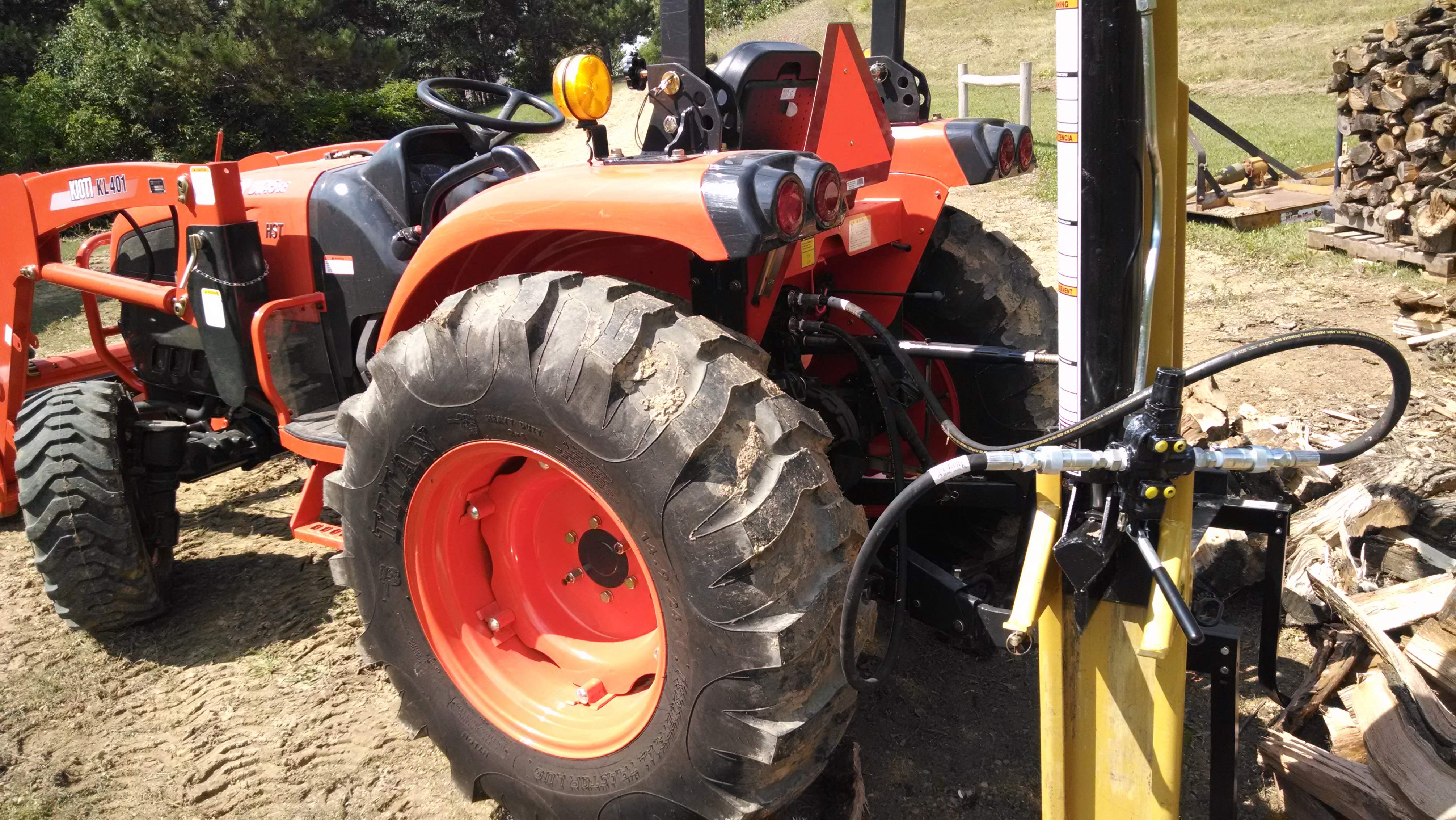

Thanks everyone for the help. I was able to figure it out after some trial and error. I am dead tired but was able to put up a lot of wood today. Thanks again for all the help and that is not only on this issue, but I relied on your posts as a vital part in my decision on buying the Kioti DK45se HST. I am now 30 hours in and it has exceeded my expectations. The work that you can do with these is truly impressive. Here are some pic's:
Easy Does It
-Dan
