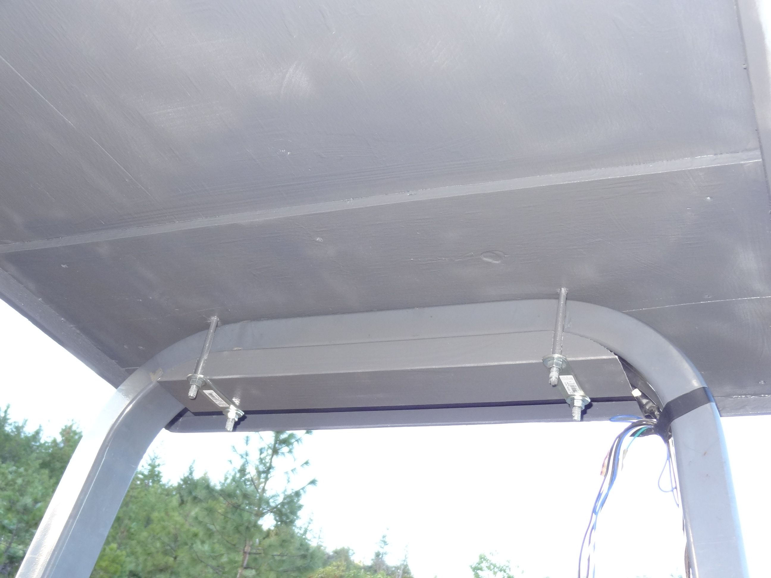

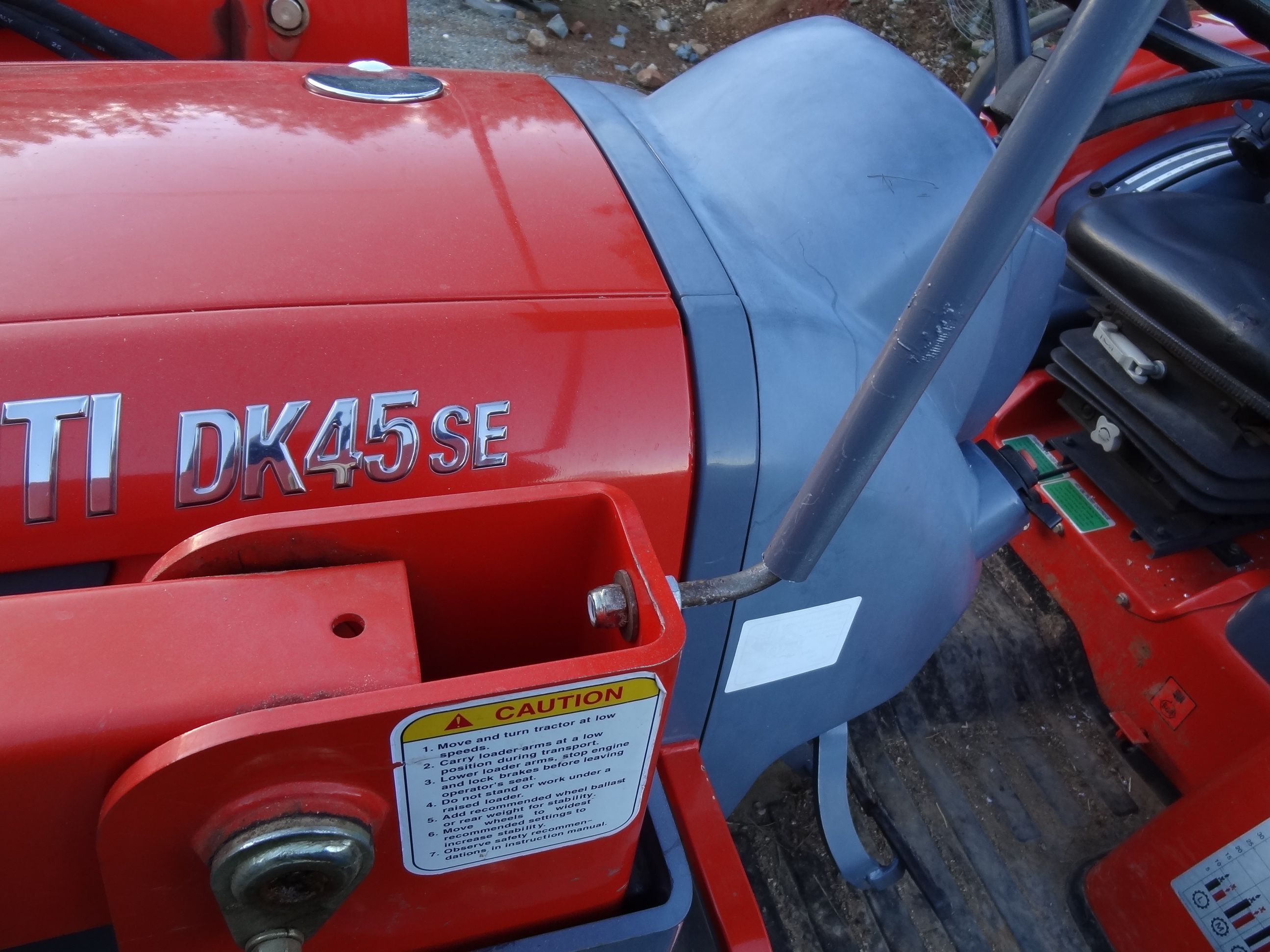

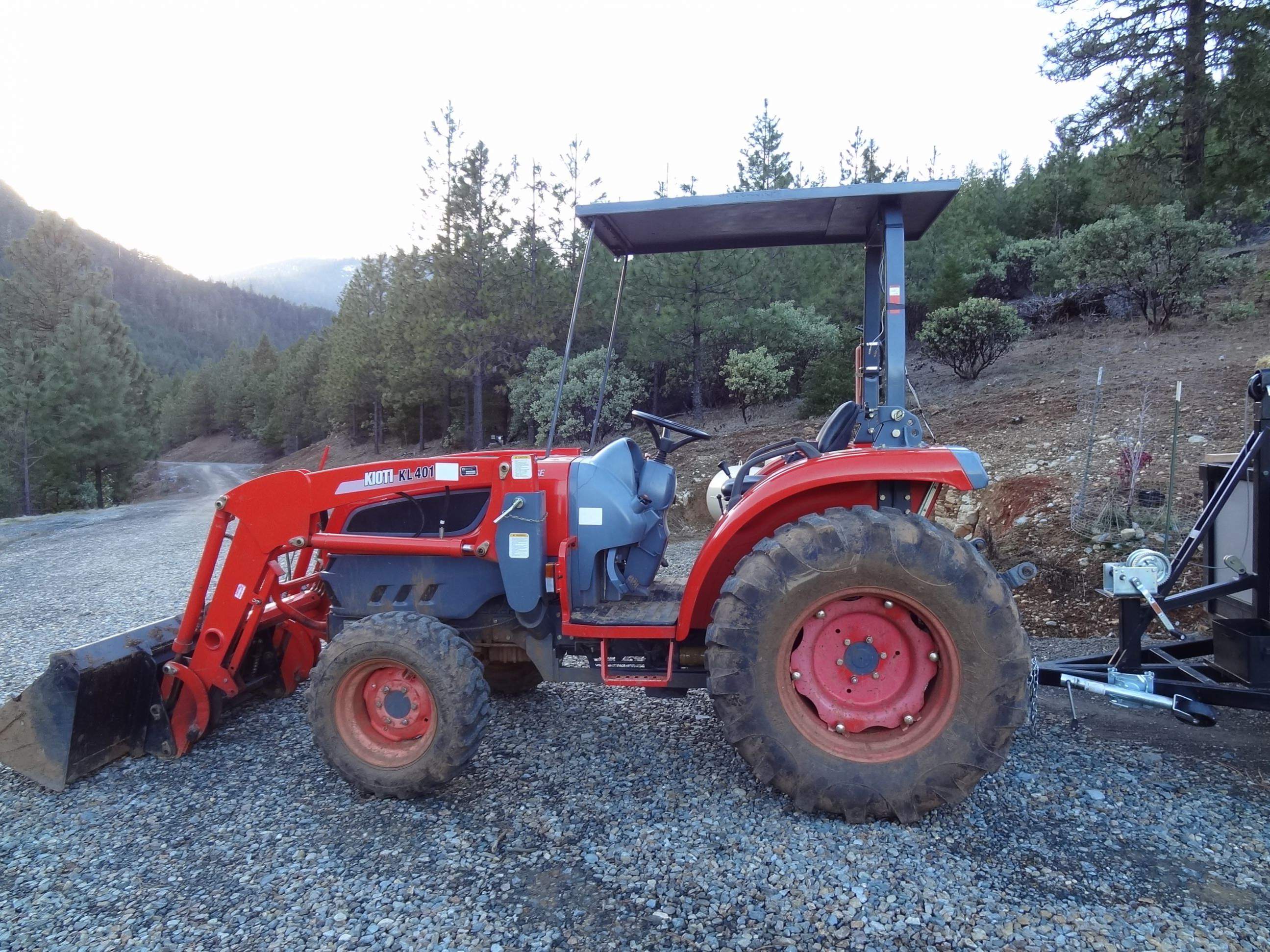

Why don't you make your own? I have a DK45 and built mine from U-bolts, plywood, elastomeric waterproof paint, EMT conduit, etc. Sounds a little redneck but it was cheap and works great. You can attach the front to FEL mounts and the back to the ROPS. Here are a few pics:
