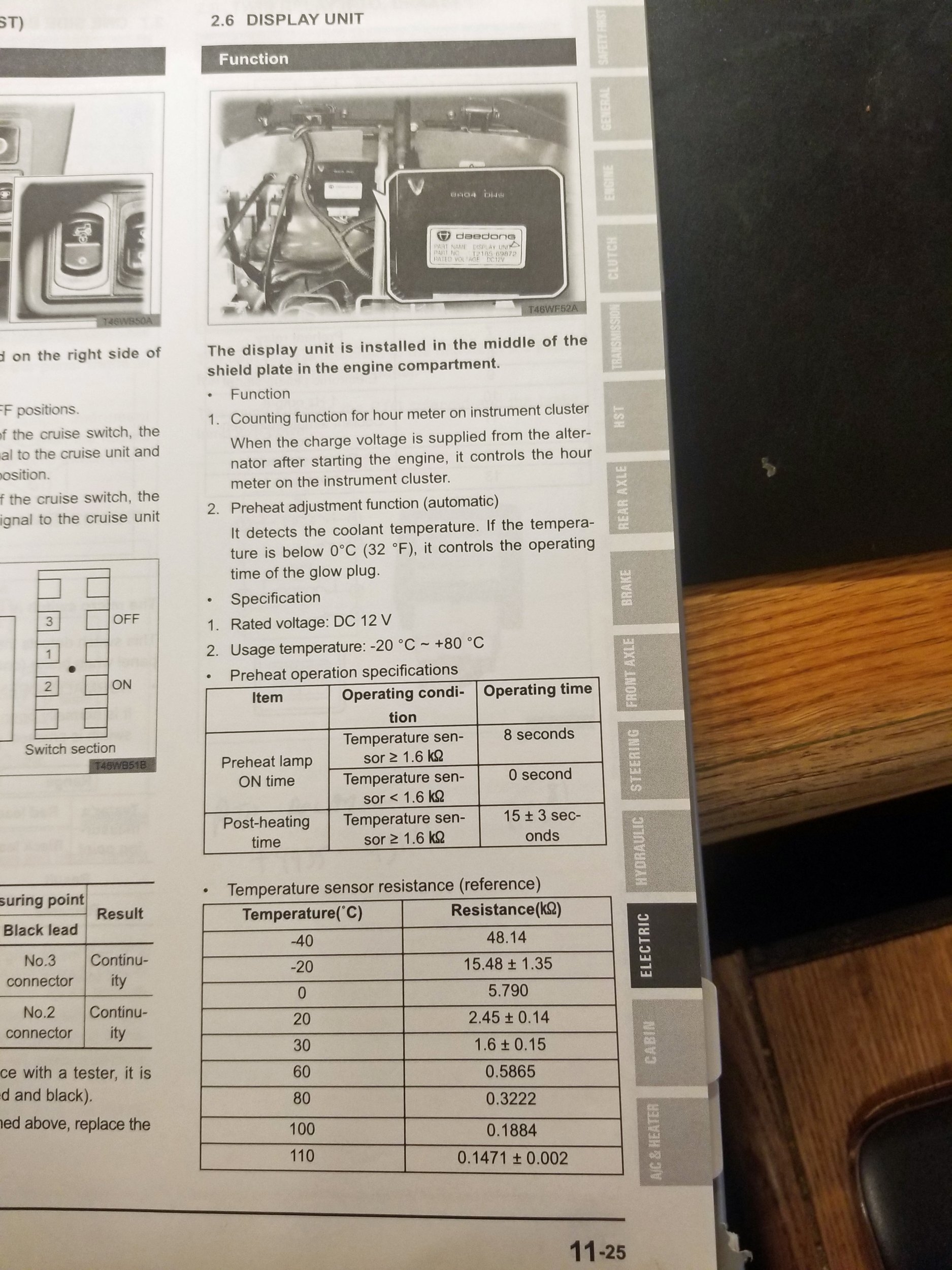

I believe thats controlled by the tractors computer box. I forget what the actual name of the unit is. I had mine replaced during warranty for some issues when tractor was brand new. I think it was called the display unit
edit: i did a search. Apparent kioti uses a glow plug timer relay. Not sure where its located. I have a 2010 model dk45 cab maintenance manual in the shop. Ill see if i can find out more about it.
