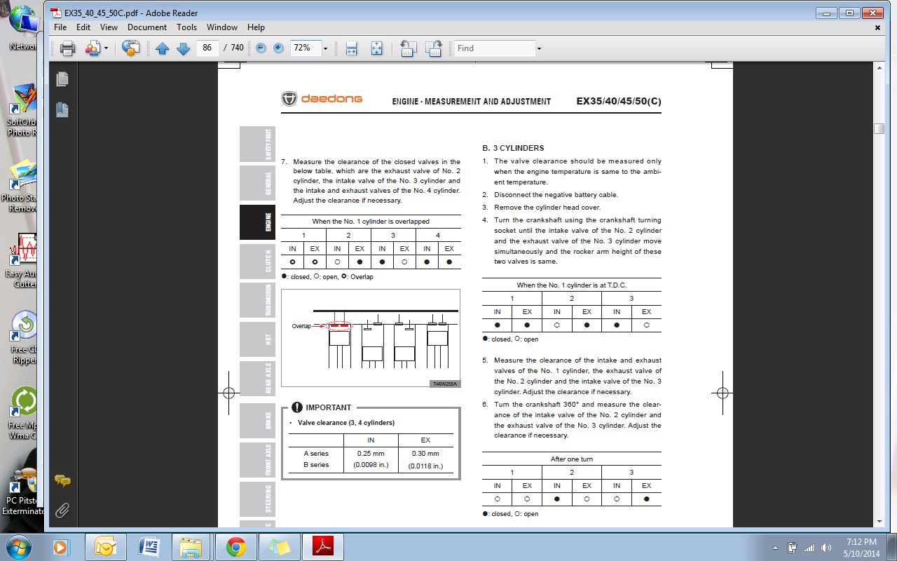

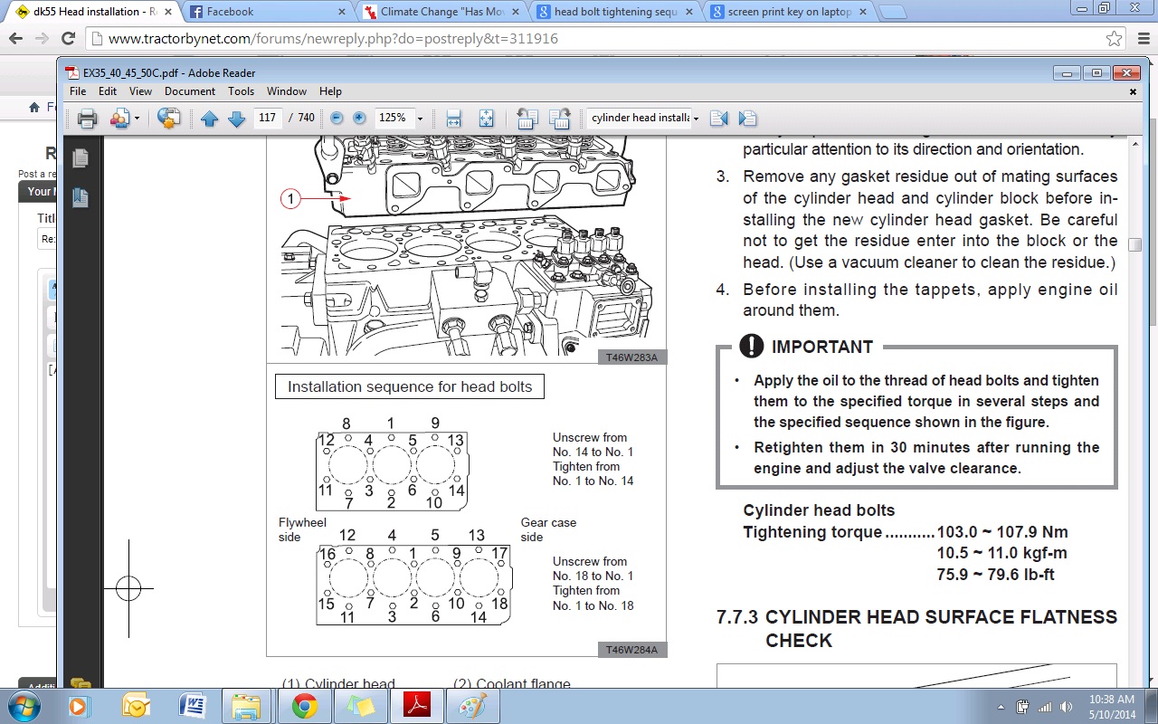

Doing the replacement of the factory headgasket this weekend. I have the new ML headgasket and bolts. Only issue is i do not have the sequence for torquing down the head bolts. Does anyone have the sequence? I was told 75-79 Ftlbs.
Thanks
   / dk55 Head installation #2

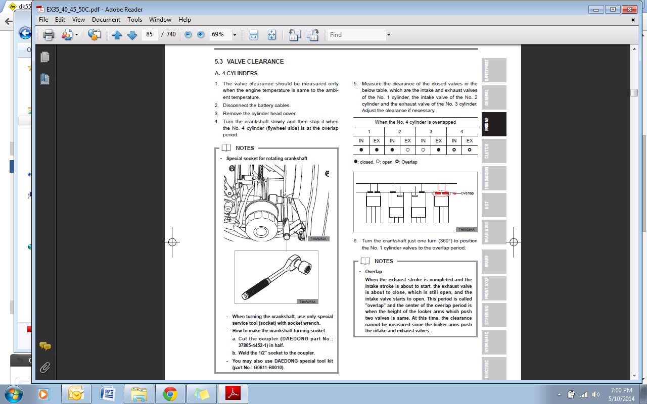

This is form the "EX35/40/45/50" shop manual but you can be assured the sequence would be the same as it is on all simple cylinder heads.
   / dk55 Head installation #4

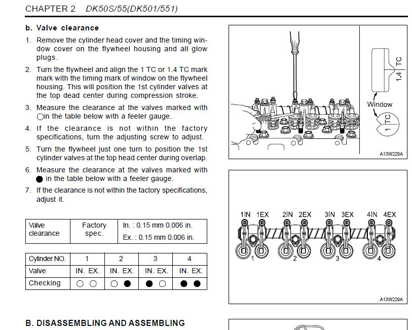

Not a DK55 manual.
