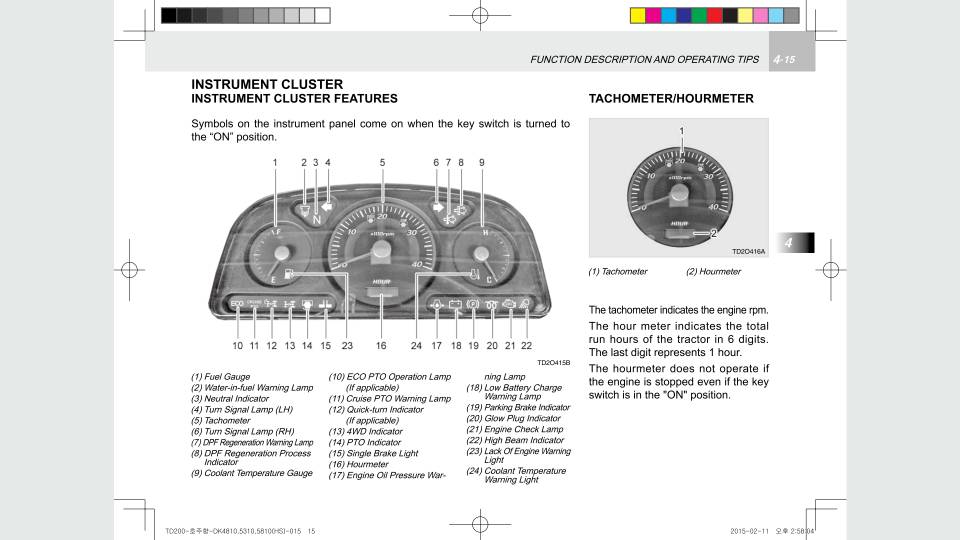

Just upgraded to a dk5810 hst and according to the manual there should be a regen switch, the dash only has blanks where the switches should be so I am wondering if mine has regen or is it an automatic function.
   / DK5810 question #2
Kioti Australia does a great job making all the Kioti tractor owners manuals available free online for download. I looked at your DK5810 manual, and your tractor has the same DPF/DOC emmissions as we have in the States. Upper right on your backlight dash, should be the DPF regeneration lights. These lights stay off until a need for a regen is detected by pressure sensors in your DPF. You can turn your ignition key right one click, to light up the entire dash board, and look at all the information lights, including regen lights. Located down near your steering column is the Regen Initiation/cancellation switch.

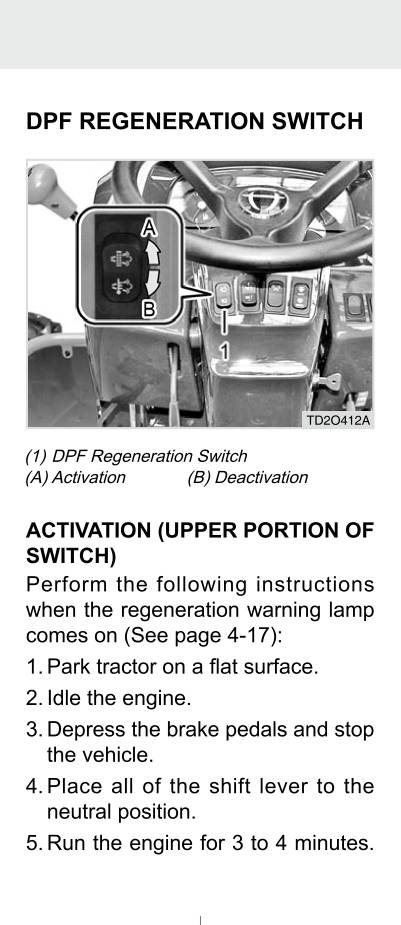

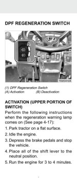

Is there anything on the console to your right? Most cab models have the switches to the right of the operator, and I believe most open station models have the switches to the right of the operator under a translucent plastic cover.
   / DK5810 question #7
I pulled the current Kioti Au manual for the DK5810SE, with HST transmission. You have many more switches than the PTO switch. Here is where your regeneration switch is located. Below steering column, left side. Likewise, your backlight dash shows in upper right is your regeneration lights. These should stay off - OR blank until a regen is initiated.
