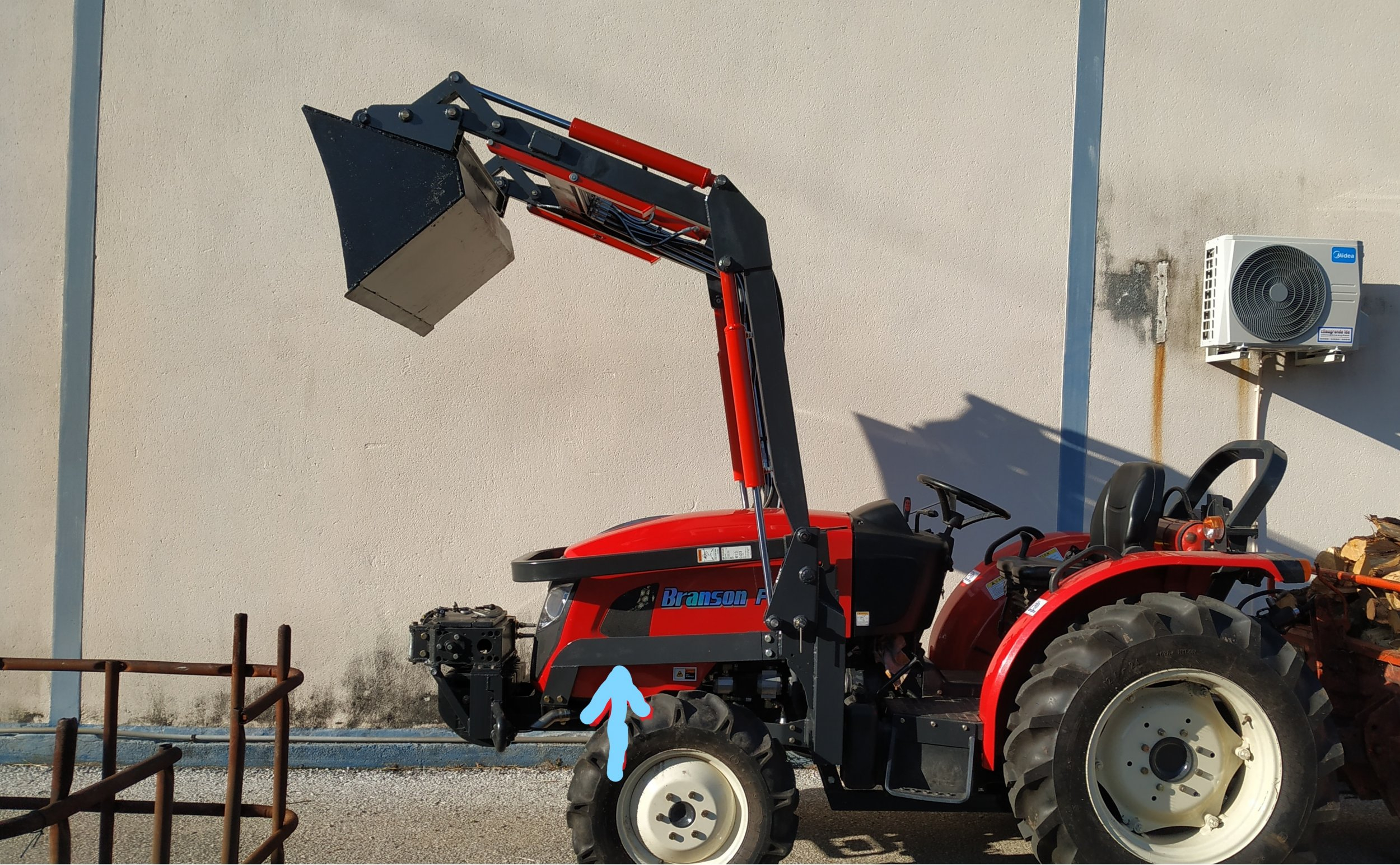

An easy and simple fix for that would be to add some support bars going to the front of the tractor to help spread the load instead of concentrating everything on the center of the tractor.
Like they used to do but decided to stop doing it. Now broken and loose bolts on loader mounts are getting more and more frequent, along with cracking of the loader mounts on higher hour tractors. Sure it may get slightly in the way when doing maintenance but that's a minor inconvenience.
