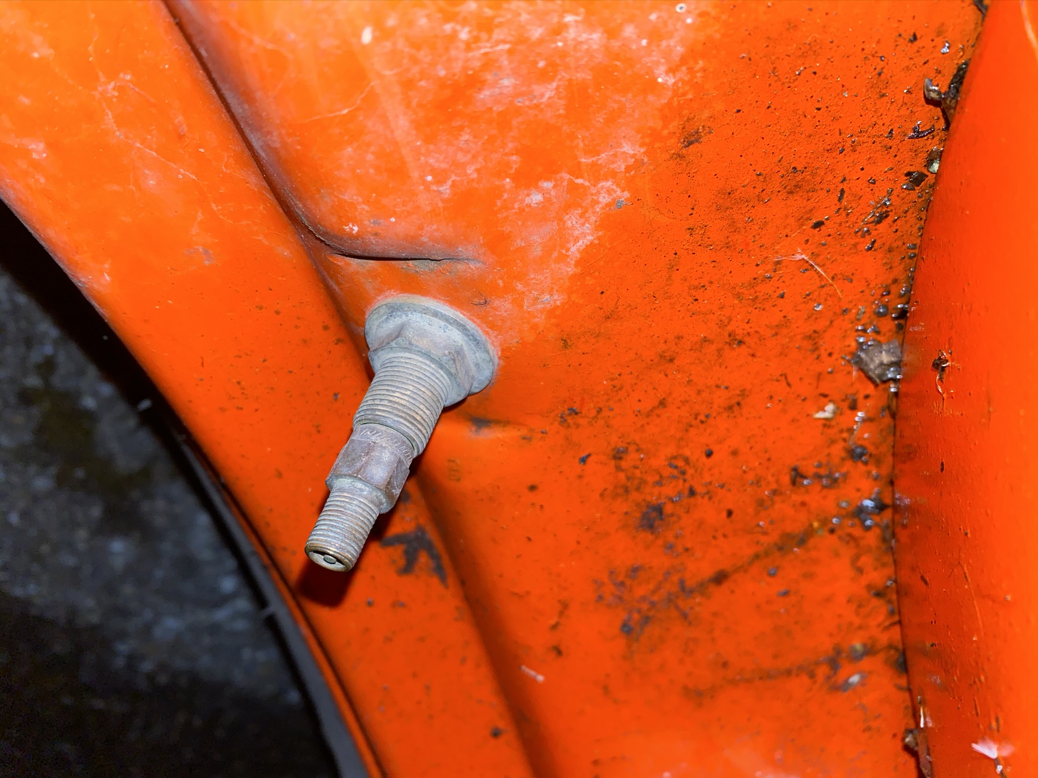

I have a leak in one of my rear tires - Goodyear 41x14.00 20 NHS. Do I have tubes in the tire or will I need whole new tire? I can't find much details when searching for the tire and I don't see any tubes anywhere.

I tell the difference on my Kubota M6040 by the type of valve stem. The front tires are tubed - the stem is all rubber and can be pushed side to side and in all directions. The rear tires are tubeless and have a rigid metal stem.
/ Do I have tubes in my tires? #4
Post a picture of your valve stem.
Tubes made for liquid fill and many but not all tubeless valve stems both have retaining nuts visible. Most tubes use plastic nuts, tubeless valve stems using nuts are usually metal nuts. Tubeless stems not for liquid fill are usually all rubber. None of this is without exception.

Here is my a picture of my valve. Looking at the pictures on the previous post I think I have tubeless tire. IMG_1425.jpeg
/ Do I have tubes in my tires? #9
Yes - looks exactly like my rear tire tubeless valve stem.
