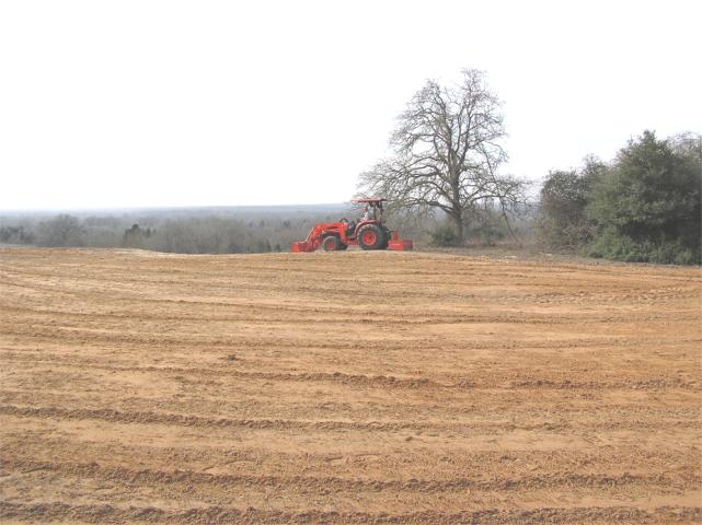

I have a chance to pick up a used 6' landscape rake for $300. I have been working a lot with dirt the past month and I am questioning if one would benefit me. I don't know of anyone in the area that has one. Most of the soil is sandy and I am becoming quite efficient with a Top & tilt box blade. I'll post 2 pictures of my box blade work and pose the question: Would a Landscape rake benefit me? How?
pic#1 leveling out building site.

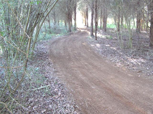

Making a trail.

Txdon, if you wouldn't have posted the followup picture of the trail, I was going to ask if you were scraping your on turnpike??? Your tractor looks kind of small way across the other side of your "pad"!!! /forums/images/graemlins/grin.gif
Yes, Just what are landscape rakes used for???

I'd say you HAVE become quite proficient with that blade Don, you can come help me out any time! Having said that though, I'll confess that my landscape rake is one of my favorite implements. It's much more foregiving than a blade. Think of your blades as shovels and the rake as... well a rake. Once you've got the rough work done with the blade, do the final smoothing with the rake. Seed then turn the rake around backwards to rake the seed in a bit. I also use my rake for grading my drive, the tines to a better job of stirring up the fines in the stone.
$300 is an OK price for a used one but you can get a low end (King Kutter) for not much more than that new.
Again, it looks like you've more than mastered the grading touch /forums/images/graemlins/smile.gif

Great job on the grading with the box scraper... There are just some jobs that seem to need that final touch that only a rake can give. If the one for $300 is a sturdy one from a "brand name" then I would go with it, parts will always be available for it. It's not overpriced. A lifetime of use is left in it and you will find new uses for it on a regular basis. I use mine with a 3pt universal QA on my FEL to reach in and pull brush and vines from along my trails. I like the idea of going in forward and being able to see what I am doing.

It looks pretty darn clean to me! While a guy can always use another toy, er implement, I'd say an old bed spring or section of chain link fence would be faster and more efective unless there are a lot of rocks or debris that I do not see.
