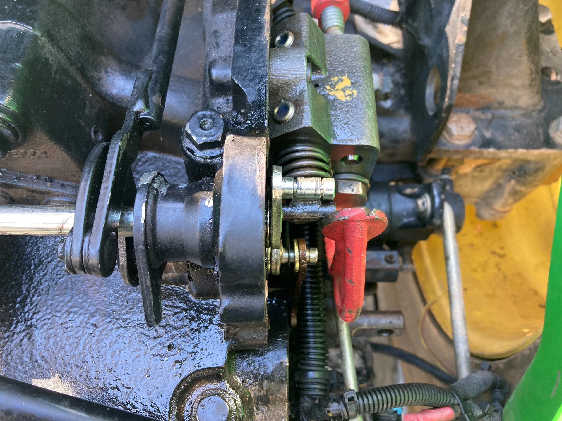

I have a JD 3203 that I am not speaking to nicely...getting close to breaking out a saw and cutting her!

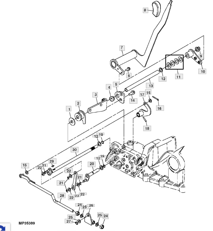

My RCV is leaking where the control shaft (#30) projects through the RCV housing. You can see the shaft in the pic below protruding out of the position limiter to the left of the housing. The external washer (#1) between the housing and the position limiter (#2) has broken down to the point where only about 1/2 of it is still in tact. I've drained the fluid and have a new o-ring (#19) and washer on hand. I've opened the RCV and pulled apart the linkage but can't seem to remove the position limiter from the shaft which I believe is preventing me from pulling the shaft out of the housing. I believe there is a key between the limiter and the shaft...maybe this has frozen over time or is there something I'm missing that I need to do to remove the shaft from the housing???
I've tried PB blasting it a bunch of times, heated it up, pried, banged on it pretty hard, and used a clamp from the limiter to the end of the shaft to try to break it free with no luck. Am I missing some important step, or is this thing just a PIA?
Appreciate any help or suggestions, including a good replacement tractor since I have work to do and this thing isn't helping me cross any projects off of my list.
