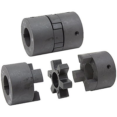

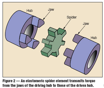

------------- I found the drive input shattered on the pump. Not sure what the assembly should look like but I have about half of a bowl-shaped casting with a gear molded into the bowl, loose on the frame where the pump bolts in. So that leaves another bowl-shaped coupling on the drive shaft, unattached to the pump. Can you direct me to where I might get a schematic of this hydraulic pump and drive so I can determine what should be there and what I need to order to get her together again?
Your description doesn't sound like a Lovejoy type, but they are the most common.
   / Do I need to bleed hydraulics after running out of fluid?
#9
View attachment 409456 View attachment 409457
I haven't done anything more for the last two days as it has been in the single digits and wrenches freeze in my hands. Thank you for the picture of the love joy coupling. Though that's not what is in my loader presently, if I found one with the right keyed shaft size, I may need to adapt to that.

Thanks for the tip on Lovejoy Couplings. I spoke with a friend locally who advised to go to Grainger too. I looked up Lovejoy couplings and found mine. It is called an S-Flex Shaft Coupling made by Lovejoy. As soon as I remove this pump, I can measure the shaft size and order the complete assembly which includes the left and right cast bowl gears and the rubber insert.
