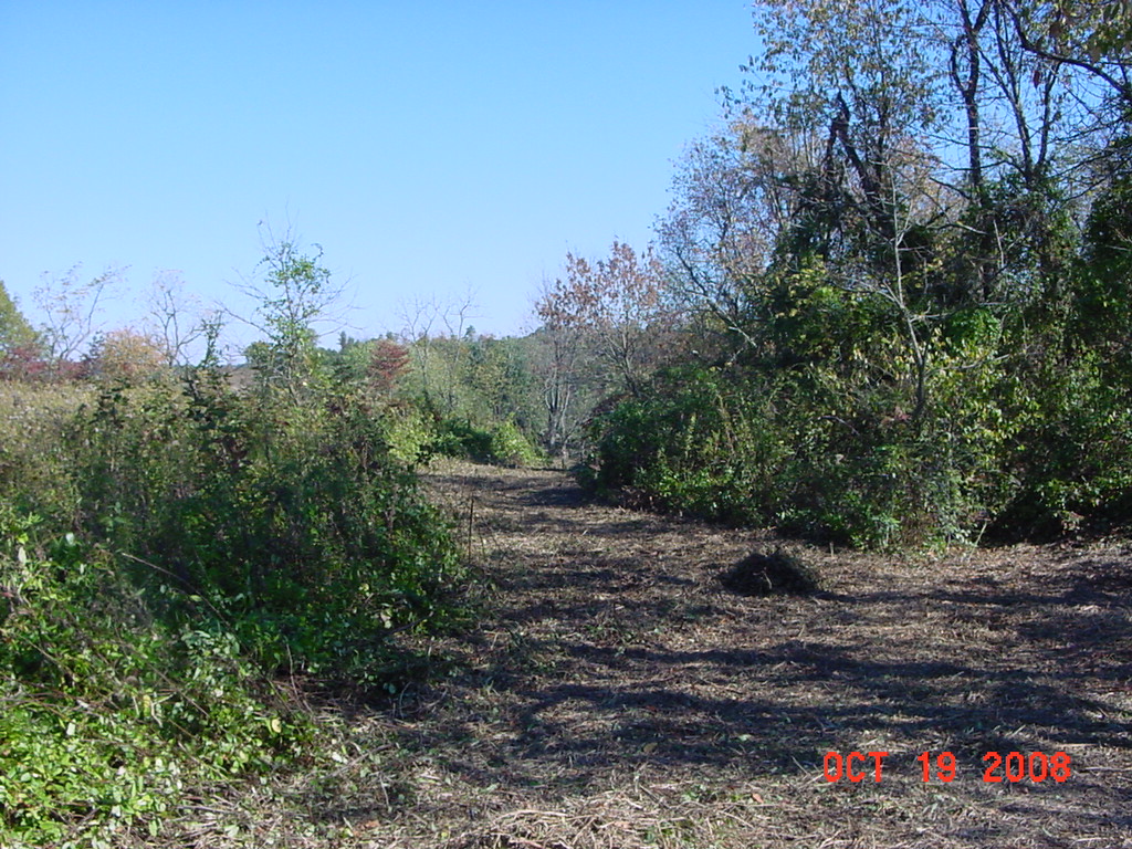

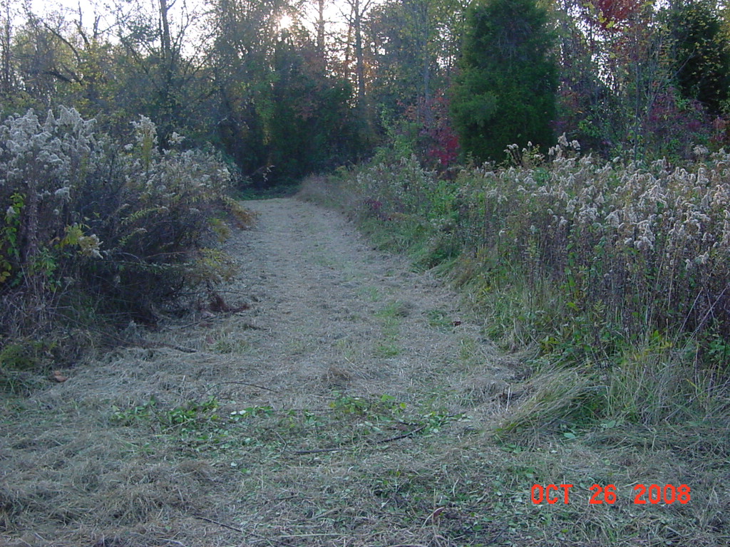

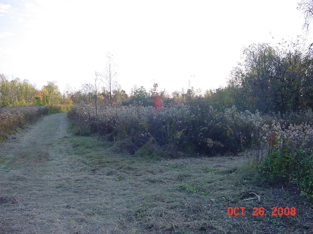

i did what you are doing last fall.....the fail mower actually did better on brush/vines/briars/small saplings (1" or less) than dense grass.....
a buddy of mine called and said this, " i hooked up my 6' bush hog the other day and cut the back behind what you cut and i really like how your flail cut it better"......he said that a week after i used the fail, he took his kubota zero turn and started cutting it like a yard......his bush hog left large, dense windrows of grass (i assume he should just raise his zero turn's deck but he didn't mention it).......i actually has my flail set so low, that it was removing the top 1/4" or so of soil, so i think that will help kill out weeds......i didn't mean to and changed that later.....the flail will absolutely pulverize all the clippings.....you'll really wonder where all of that stuff went......
here's a pic.....most of what i cut was 10-15 years of growth, briars, tall grass, smaller trees, twisted vines that were probably 30+ years old......over-all growth probably averaged 6' tall...i used my FEL about 1' off the ground to push things over.....this is one pass...
i honestly think the flail uses less power than a rotary.....i would say that a rotary cutter could take more abuse...

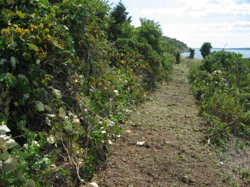

I've been doing almost exactly the same type of land clearing. Started with a rotary cutter and then upgraded to a medium duty flail. Flail handles essentially the same material the Bush Hog did but it cuts much cleaner so I got rid of my finish mower too. My flail doesn't have quite as fine a cut as the finish mower but it is fine for my purposes which is mostly pasture/field mowing with a bit of mowing around the house.

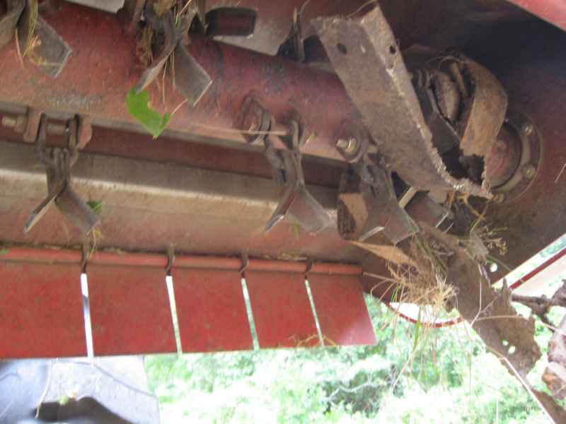

Flails do require a bit more mainenance than bush hogs but I think the trade off is worth it for the flexibility and decreased storage space as well as the biggest advantage which is safety. I have a Caroni TM1900 flail on a 41hp tractor. The flail cuts 75 inches. Photos below show one pass with the flail through an area of bullbriar and 1-1.5 inch brush and also an old angle iron that the flail picked up, wrapped around and stalled the tractor. Unwrapped it and kept on going. No damage other than a few nicks in the flail knives.
I have a season and a half of mowing about 15 acres on my flail now and will not consider flipping the double sided flail knives over until at least next year so I figure you get at least three years minimum from a set of knives.
