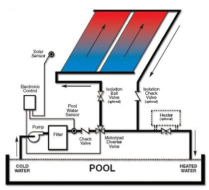

What is the solar heating method that some of you are referring to? Do you basically make your own heater using a bunch of black plastic pipe laying in the sun to circulate water through?
Does anyone have any pics of what this type of system looks like?

Here is the system I've priced for the pool in FL (winter) but haven't pulled the trigger yet.

I'd suggest you give consideration to having an entirely separate pump and plumbing for the solar heater. That way you can run a small low cost heater pump during the day and only run the big filter pump when you really need to.
The heater pump doesn't have to pump hundreds of gallons a minute to be effective. A properly sealed solar heater needs minimal pumping to keep the water circulating through the system. Once all the air is out of the system the water returning to the pool 'sucks' water up into the heater (as long as the inlet and outlet are both under the water). You then only need a 'relatively' small pump to keep it moving.
My last pool was plumbed like that. But note that it also had an automatic 'floating ball' valve at the top of the solar panels to let the water drain out when the pump was turned off. And the system I describe is only suitable if all the pipes and solar panels are 'rigid'.
