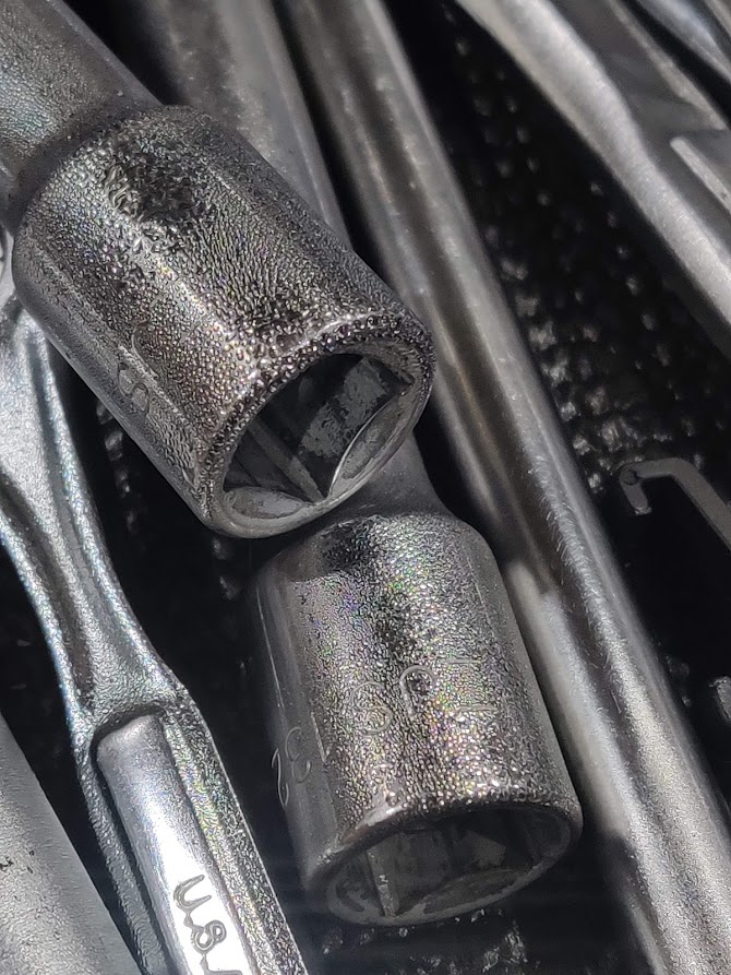

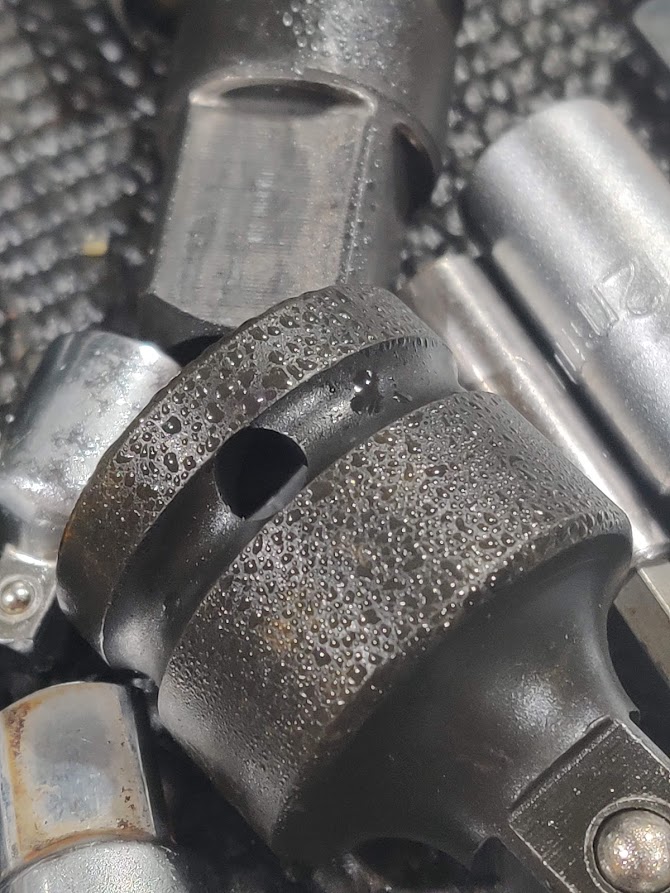

I live in AL and sit above 90% humidity for much of the year.
I went out the other morning and the entire tractor (under cover) was sweating and soaked.
Even the tools in my toolbox in the garage were soaking wet.
I worry about condensation in the fuel tank. I have a MT240 with a dash water/fuel filter warning light.
I have (2) 5 gallon fuel cans in my shed, they were sweating too. I don't use a lot of fuel, I fill the tank 5 gallons at a time, and that lasts several weeks, to a month or so.
I could top off the tractor fuel tank after each use, but I'd still have the condensation on the 5 gallon fuel cans.
I took some pics of the tools in the toolbox inside the garage, but not of the tractor. The tractor was much worse, under the carport.
Should I be concerned with water in the fuel filter before the light illuminates, or just wait for the light and not worry about it until then?
