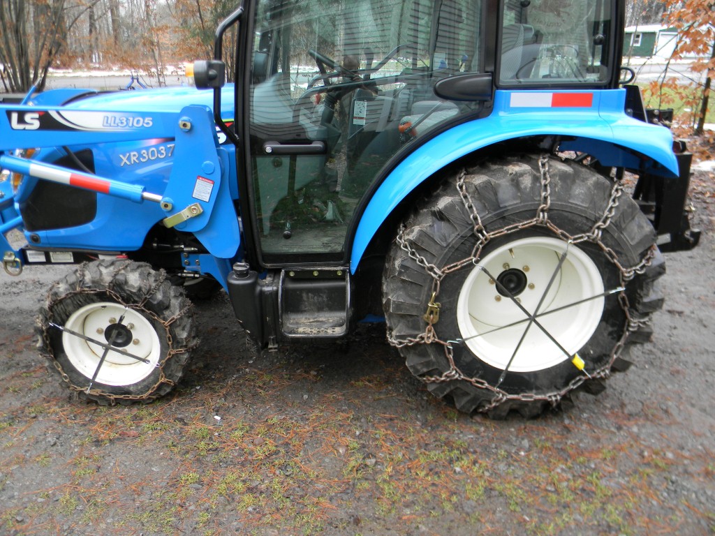

I am posting this in the LS section because you guys are a lot more helpful and knowledgeable. Also because you all know that my new Boomer 37 Cab is really a LS XR3037HC. To the point, the distance between the inner metal fender wall
and the side wall of the turf tire is just over 1 3/8". My chains are 2 link 3/8" twists that probably will tear up the inside fender wall? Does anyone have any experience with chains on theirs? Do the R-4's have more room on the inside or are they clearing?

Sorry, I somehow missed this post the other day.
I do have R4's and standard ladder chains fit without spacers. I do not know anyone who has R3's on a 3037 (or Boomer) so can't really reply if there is room for chains.
I can say this. The sidewall of my R4 is 2 1/4" from the fender and the top of the R4 lugs is 3 1/2" from the fender so the ladder chains fit. If your clearance is similar, chains should fit yours also. Since you only have 1 3/8" clearance I think they would fit but would be really close.
Jack up the rear of the tractor. With trans in neutral set the chains on the tire and roll the tire around then hook up the end links. after that spin the tires by hand and check clearance. I'd personally opt for 2" spacers with your Boomer set up.

Thanks George. I did order a pair of 2" BORA Tractor Spacers from Motorsport Tech (775-351-1000) for $280 including shipping. They will take about 2 weeks to get here. With the 9" of snow we got today and 2 storms maybe coming next week, I might try your suggestion of jacking the tractor up and test fitting the chains. With the ice base under the snow I had a lot of traction problems even with loaded tires and a 850 lbs. rear box blade.
Thanks again, I'll let you know how it works out.
