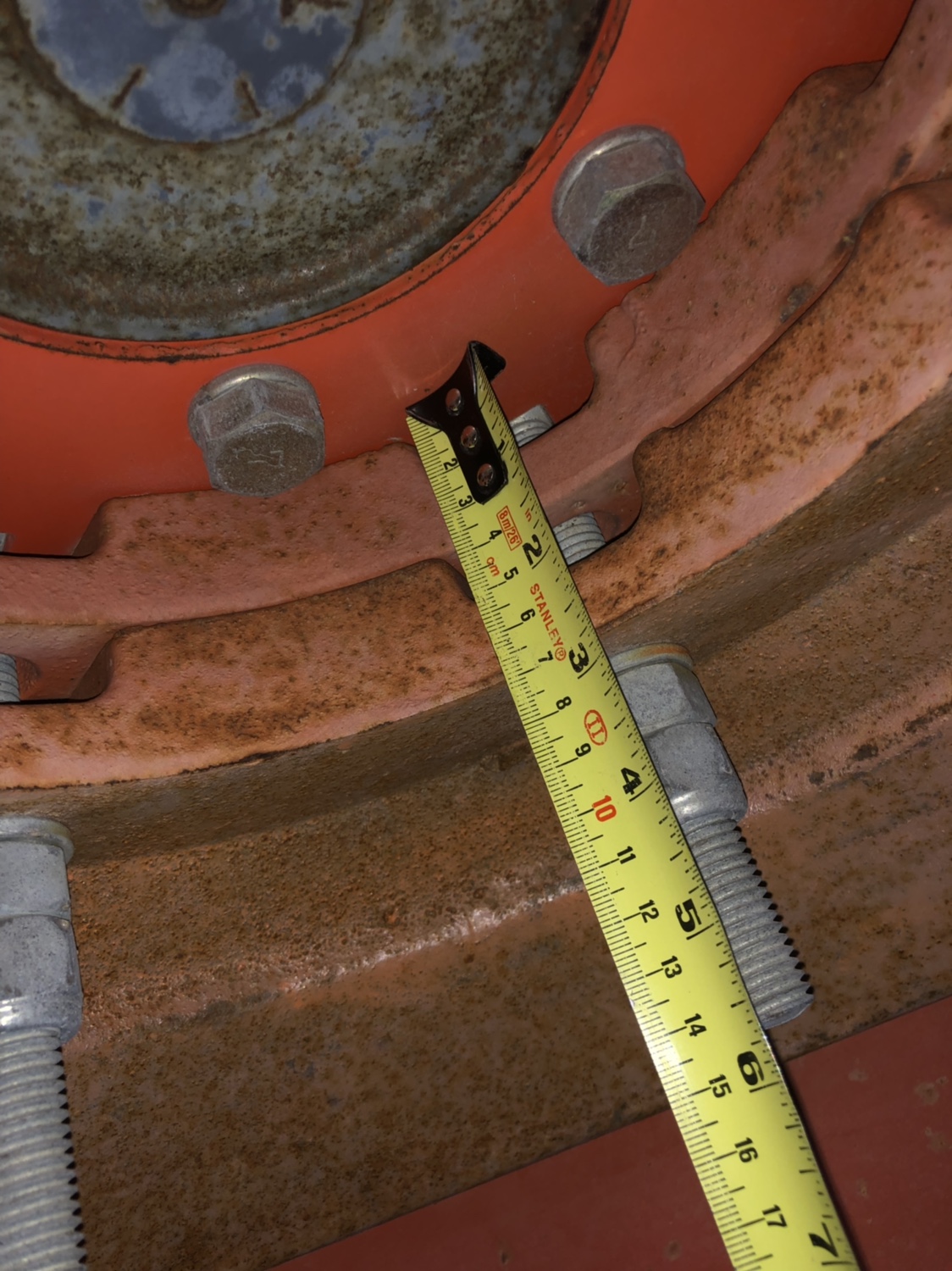

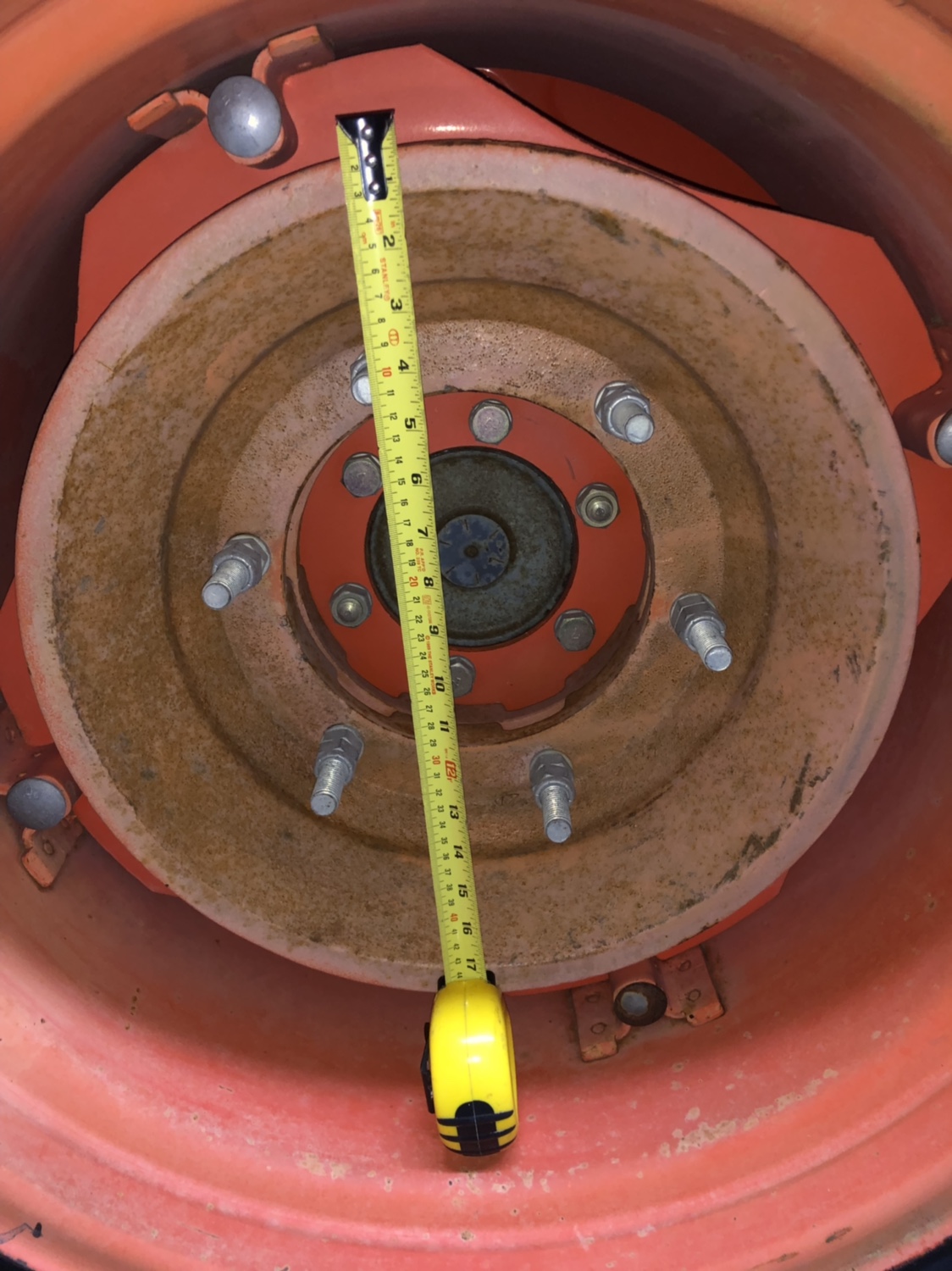

Hello all,
When I bought this tractor it had wheel weights installed in the 24” rims. I’d like to know how much each one weighs and know the brand so I can add a little more weight.
Does anyone recognize what these are?
Thanks!

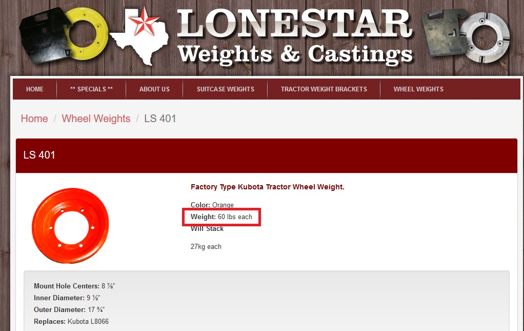

The weights look like these from Lonestar at 60# each.
If you added liquid ballast, the additional weight would be: 14.9-24 47gal 392#
