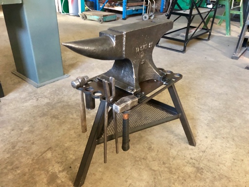

I have little need for an anvil,, but, I might be able to acquire a 200+ pound anvil.
I surely do not want that monster taking up shop space, to end up collecting dust,,
so, a SUPER HEAVY DUTY cart would make the anvil useful, but, still be able to be moved out of the way,,
Is an anvil cart even possible? or does the anvil stand need to sit directly on the floor?
Obviously, I do not know much about anvil use,,, But, I stayed in a Holiday Inn Express the night before I bought a couple sledge hammers,,, :D
HELP. what should I do?? :confused:

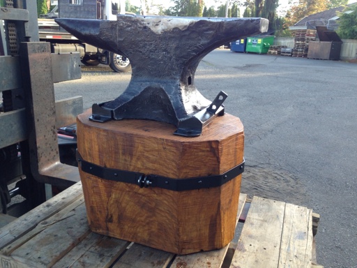

Do you have a pallet jack in your shop? If so, mount the anvil traditionally on a stump and chainsaw “shelves” or tapers on two sides for the forks to lift.
I did that for my 300# Peter Wright but it is quicker just grabbing hold of the anvil and “walking it around”. And I’m NOT a big guy.
This 3 legged stand with a 200 pounder is also easily moved with a pallet jack.

The Harbor Freight hydraulic lift table would be a good mount for your anvil. A little modifying it to put stabilizers under it for when its in use would help. But it'd sure be portable with height adjustment capability.

I got tired of mine taking up space inside my shop and mounted it to a large pine log cut to about 24" long. I just placed it outside my shop doors so it is out of the way. I can roll it around if needed but it is a small anvil of around 80# I would guess. I found it in a pawn shop 10 years ago for $40. Flea market close by had one about twice as large but they wanted $400 for it (stupidly priced) and it was all chipped up. Mine is pristine and serves me well.
