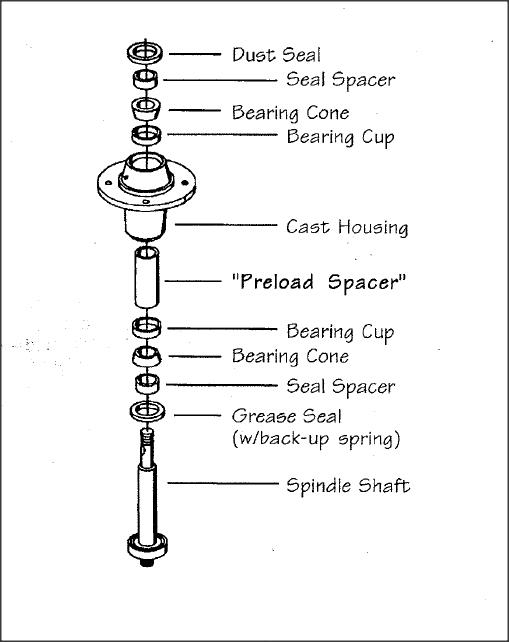

I don't know about 1850 deck but the US made RC72R-F30 deck on F3060 uses standard 1 inch spindle trailer wheel conical roller bearings L44643/L44610 (Set A14)
The bearings dimensions are: 1 x 2 x .56 inches (25.4 x 50.29 x 14.22 mm)
The last time I bought them was five years ago and they were just over $4 each on eBay!
