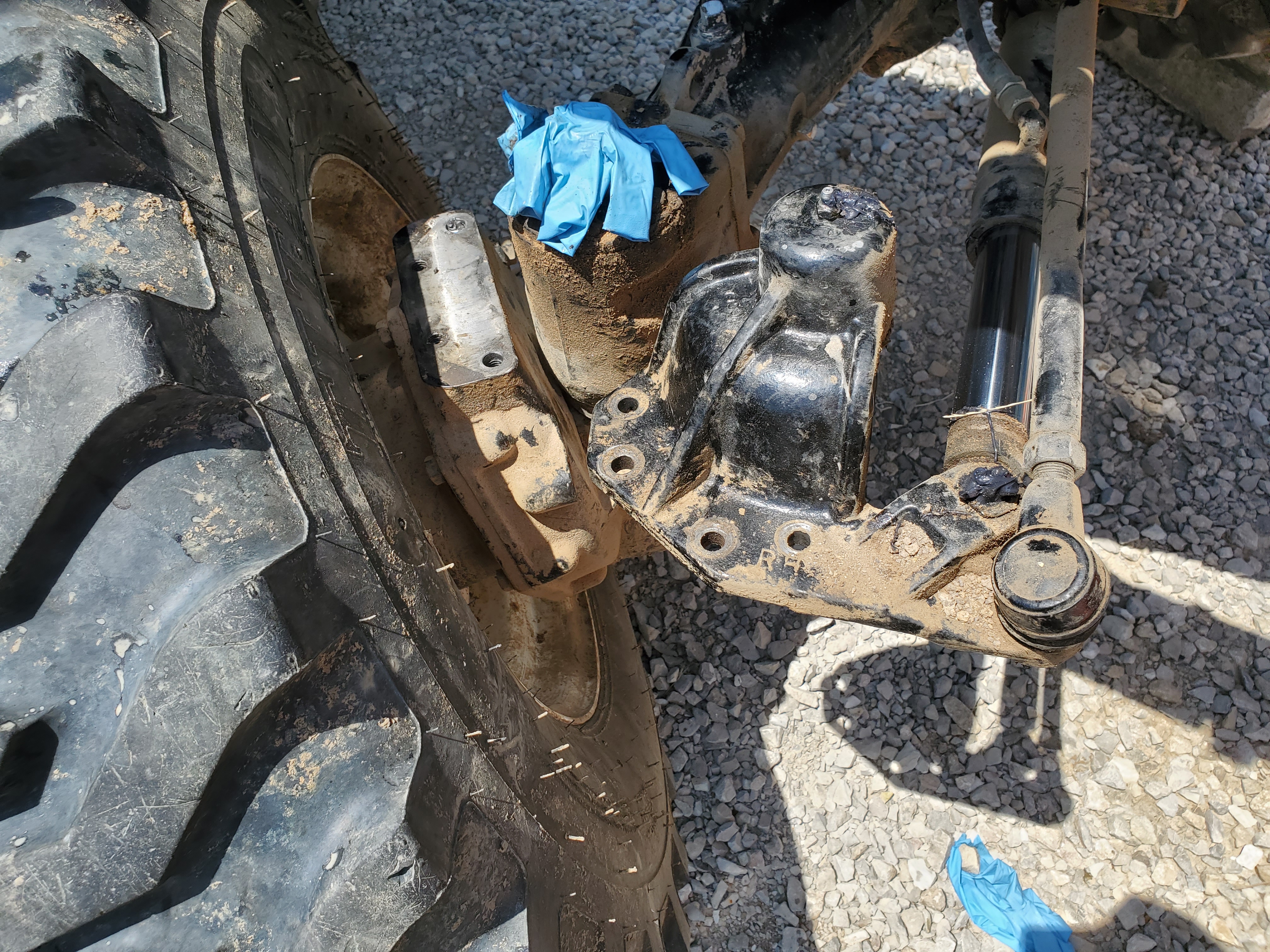

Greasing the tractor and a bolt head literally pops off where the wheel connects LOL (really not funny)
Check the other 3 and 1 other is basically broke off just sitting there. 4 tiny little bs bolts holding this thing together. Unreal.
Thank goodness the bolt extractor worked for 1 and the other was pretty loose in the hole so I got it out.
Trying like **** to get this all lined back up and bolted back together. Does anyone have any idea what these are torqued to? Or at least and educated guess?

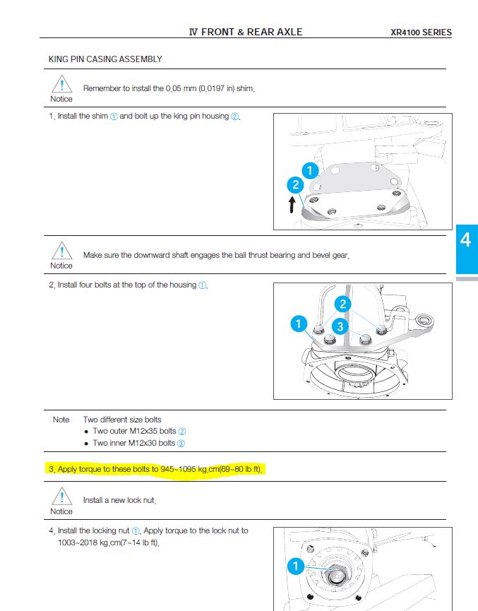

According to the manual (see attached) they are torqued to 69-80 ftlbs.

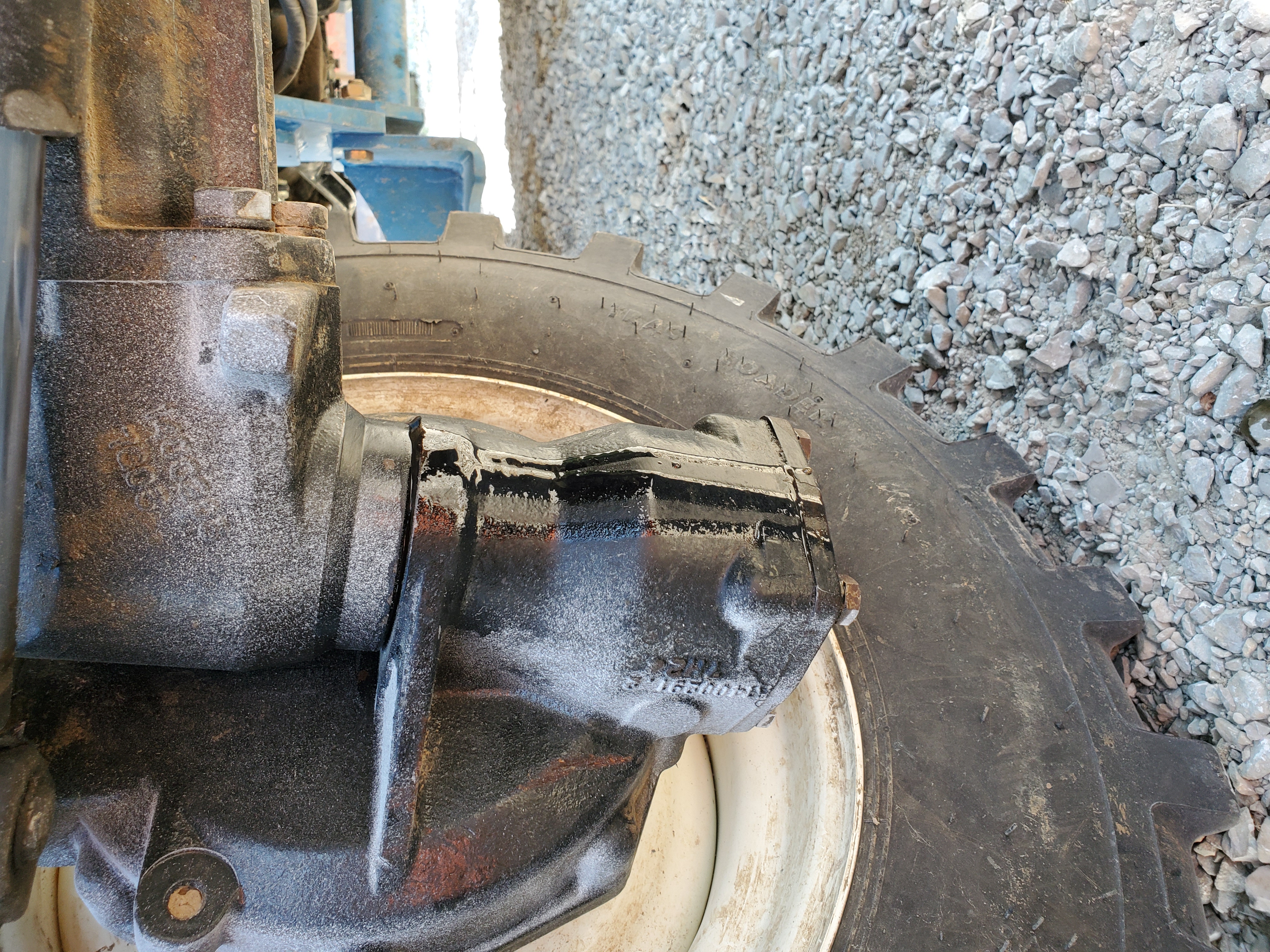

I got the new bolts and got it all back together. Easy enough fix (LUCKILY with those broken bolts) but super frustrating. Thanks again.
