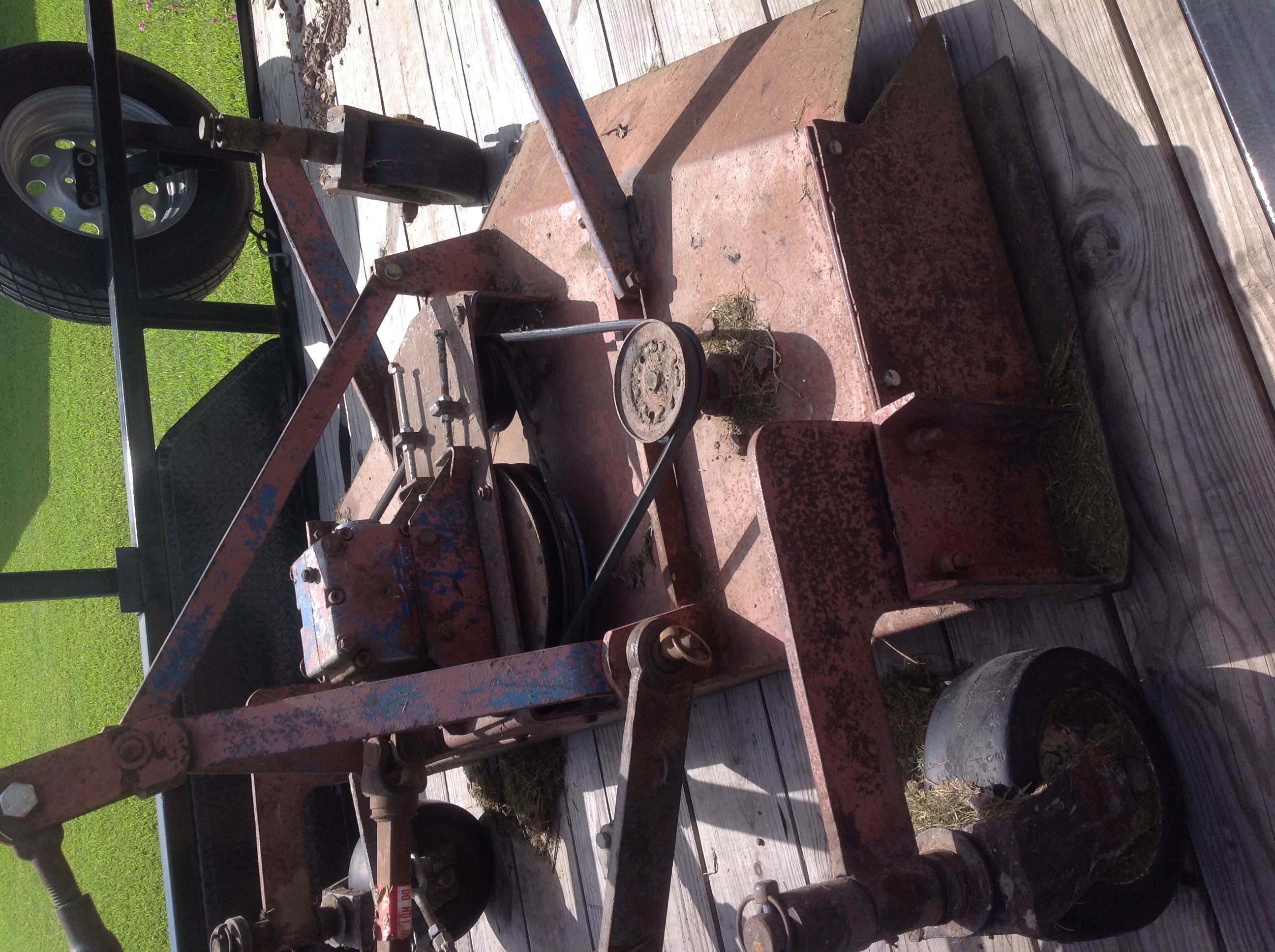

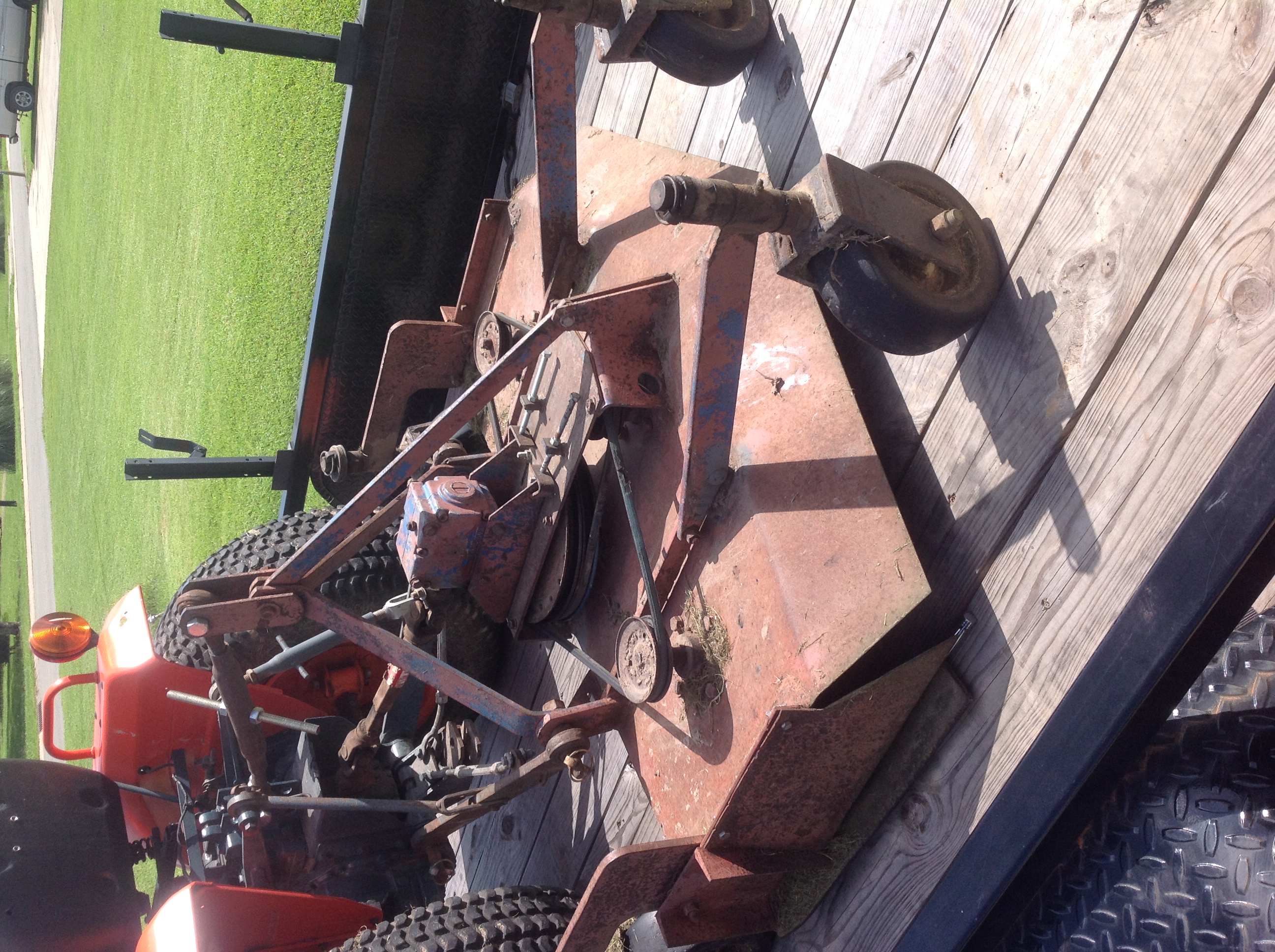

Rear Finish Mower Does anyone know what Brand of mower this is?
   / Does anyone know what Brand of mower this is? #1
Rampidinla
Jun 16, 2016
1
Baldwin, Louisiana
Kubota B6200
I purchased the tractor and mower together, but I do not know the brand of mower. The owner did not know the brand either. It is a 4 foot mower with a Superior gearbox. The tractor is 1986 B6200. Any help is appreciated.
   / Does anyone know what Brand of mower this is? #2
Welcome to TBN..........................
Looks like it might be a Superior finish mower since it has their gearbox.
I found this website for Superior. May be an older model of their EM series.
Finishing mowers - Superior Equipment
First thing I'd get are a pair of replacement belts and cover plates to go over them for safety.
Check gearbox fluid and grease any fittings.
