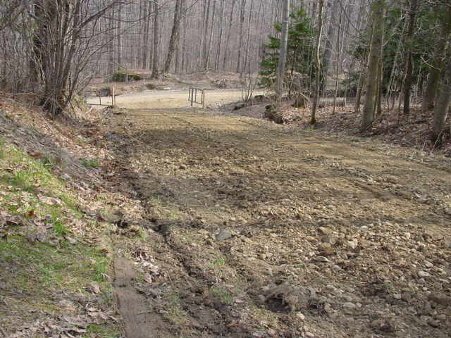

Like Maddog said , I think a Box Scraper is the best tool to use when leveling dirt and gravel etc. The scarfers help in tuning over that little bit of uneveness and the boxes blade levels it nicely..
