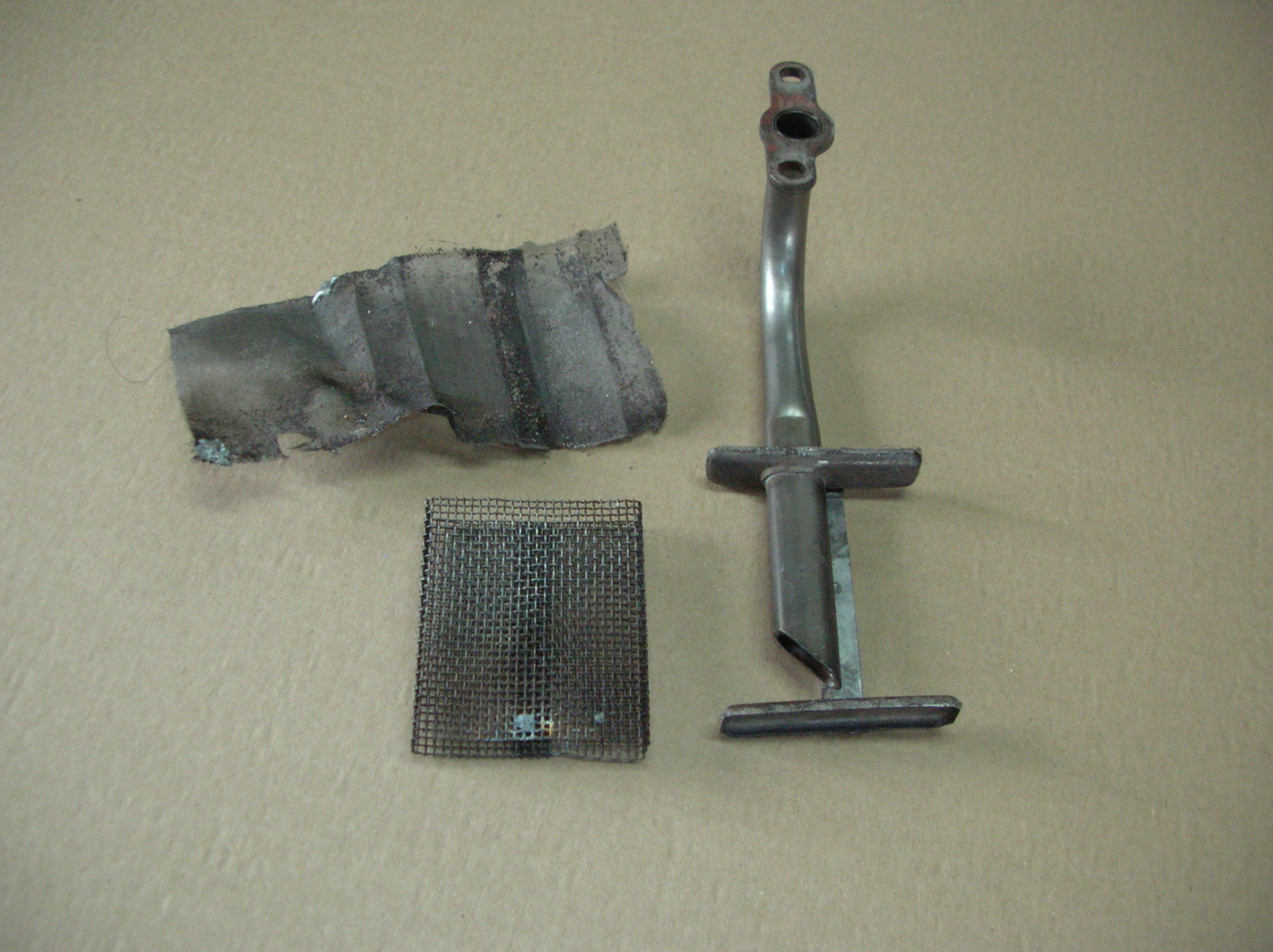

The safety wire must be cut to remove. If it has never been removed before, the factory wire is wound pretty tight. The wire must be replaced or the screw may come loose and the filter cover can jam up the pto lever linkage. Have seen that here. My filter screen was deteriorated and needed to be replaced since it was not filtering the oil.

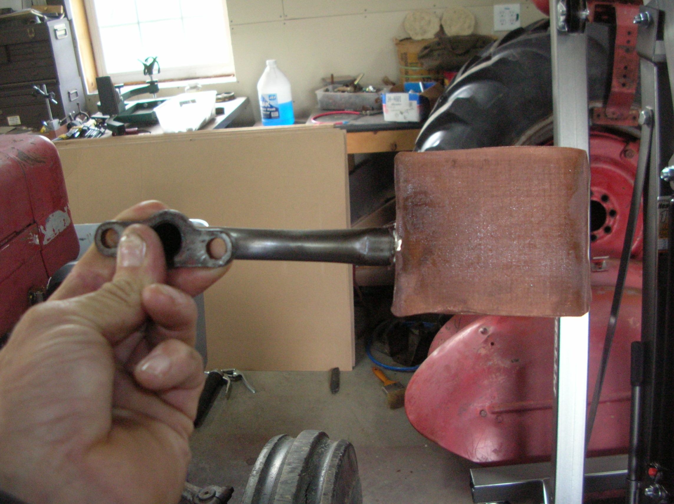

I rebuilt my filter using some new copper mesh from McMaster Carr. I used copper so as to be able to solder the folds.
