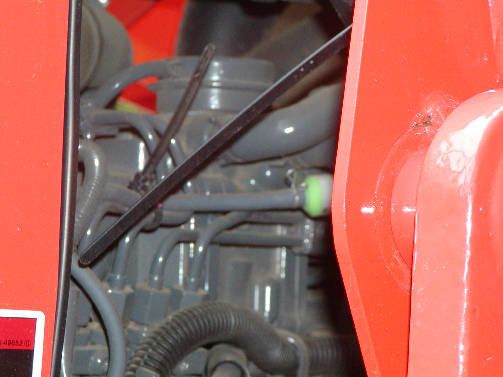

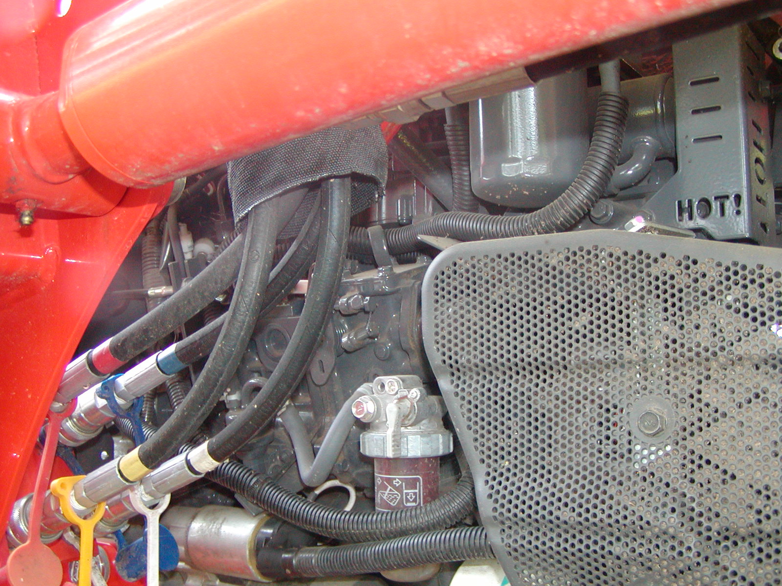

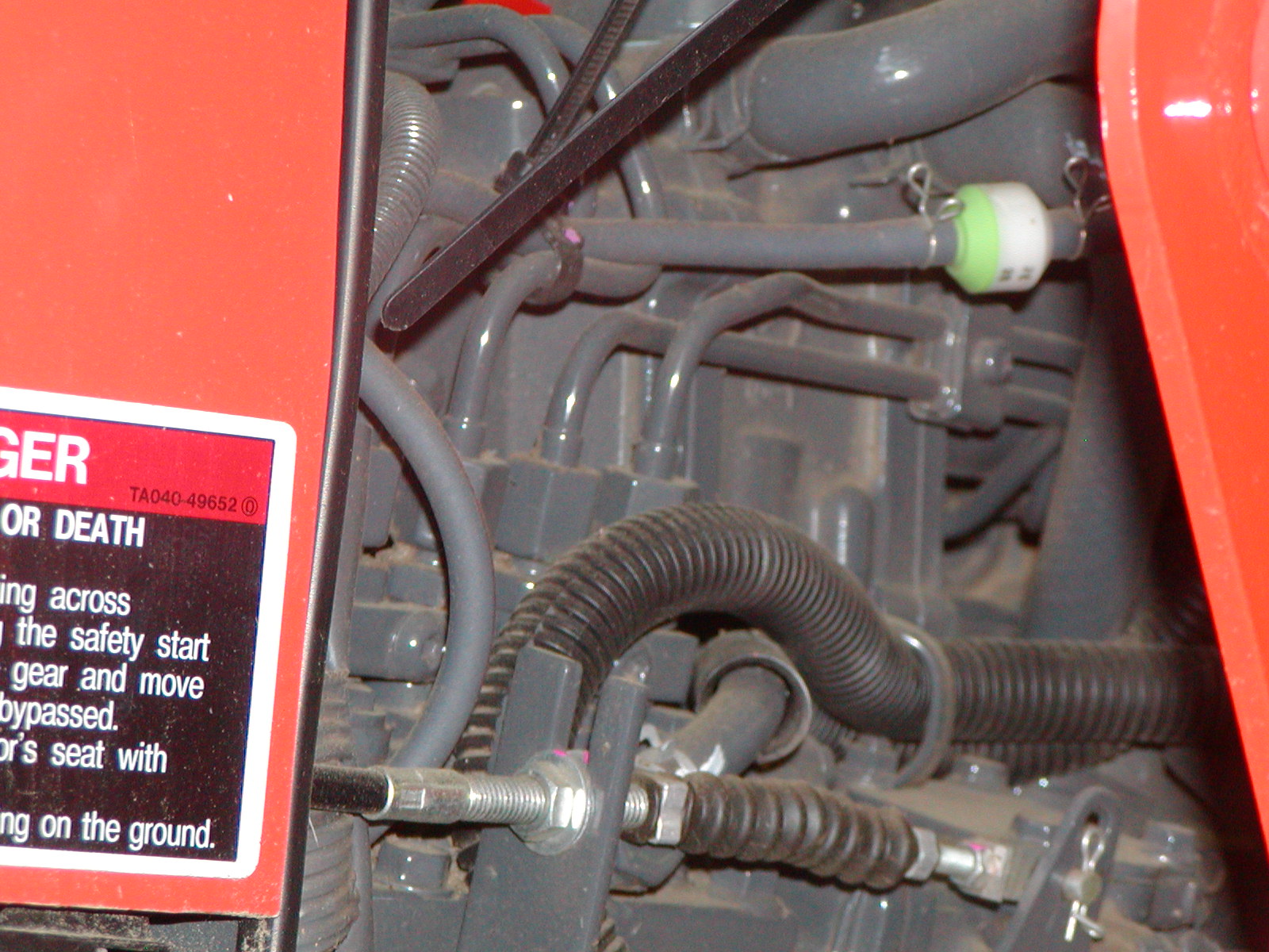

Got my M7040 from Barlows in the fall of 2012. I thought it had none of the eviromental stuff on the engine. I've since found out that some of the late M7040 models might have had a EGR engine installed in them. Anyone out there can tell me if this engine in the pictures has a EGR valve or is that round thing the turbocharger?:eek: EGR 006.JPGEGR 002.JPG
   / Does my M7040 have a EGR engine? Pictures to help! #2
I don't see a turbo in any of the photos. It would be mounted to the exhaust on the hot side and air intake past the filter on the cold side. Not sure what round thing you are referring to. Likely as not, you don't have any EGR emissions equipment on a 2012 engine.
   / Does my M7040 have a EGR engine? Pictures to help! #3

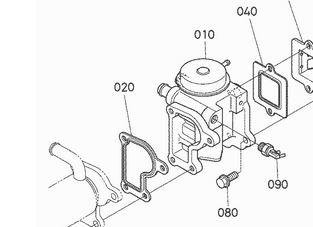

Hi Gary, The one picture with the fuel filter showing in it rite in front of it notice a guard that says hot on it if you look to the rear of it there is a tube shaped object that is connected to a external EGR VALVE.You have the same engine as I do in my M7040 witch has the EXTERNAL EGR VALVE. The turbo is on the exhaust side of the engine off the EXHAUST MANIFOLD because a TURBO is driven by EXHAUST GASES. So yes you have a EGR EMISSIONS ENGINE witch is not all that bad the newer TIER IV engines have EGR PLUS A PARTICLE FILTER. Are as DIESEL PEOPLE CALL it a DPF.Not to worry just use a MOTOR OIL RATED API CJ-4.
   / Does my M7040 have a EGR engine? Pictures to help! #4

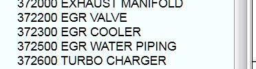

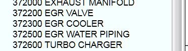

If your tractor a M7040HDNBC? if so it has a EGR valve. Round white filter looking thingy is a check valve.
