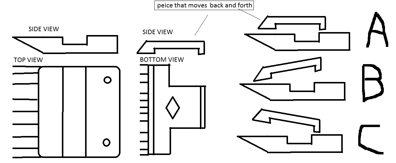

i have sharpened the bottom blade, (one that does not move) and then upper blade (one that moves side to side) a couple other times, and it gave new life to the shears.
but this time around, the shear is pulling hair, (tried on myself) and i have to force the shears through my own hair, and for the one pup it won't even cut her hair.
A = both blades are nice and even with each other
B = the teeth of both blades, grind together some
C = there is some space between both blades so they don't grind each other.
i currently have A, or at least i think i do.
not sure if i am grinding enough off or not from both bottom and top blade portions maybe?
the spring clip, i don't have scale right at moment, to test how hard it is to slide the top blade back and forth, i had it set at 2lbs maybe 1 lbs or was it ounces? what ever i got off of some youtube videos. everything seems to be setting nice and level with one another including the spring clip. and i still have a lot more i could grind off of each blade, compared to videos i saw on youtube, that had the blades down to point there was no grove on bottom or top blade.
am using a new flat stone for sharpening knives with. so it should be grinding evenly and i am not getting any sort of teeter tottoer between the 2 blades.

I use Oster A5 clippers on my dogs. I've used them for several years. I have dog teeth marks on my clippers.
I keep at least ten #10 and a couple #40 A5 blades. When a blade becomes dull (won't cut or pulls fur), I change the blade. When I have ten blades that need sharpening, I send them to Oster Direct, 904 Red Road, McMinnville, TN, 37110 tel (800)830-3678. The last I time sent blades for sharpening (2013), the cost was $5.50 each plus shipping, handling, and tax. The blades can be resharpened many times and Oster will repair if necessary. Personally,I am not going to fool with disassembling and sharpening blades myself.
In my opinion dog hair is harder to cut than human hair. Some breeds, like Shetland sheep dogs have a very fine undercoat and a coarse outer coat. Other breeds like Maltese and Poodles have a very fine, thick single coat.
   / dog shears not cutting/shearing like there suppose to #3
Clipper blades are hollow ground. I take mine to a sharpener that does clipper blades. They have a grinder specially made for clipper blades that has a convex stone. You can go mailorder as noted above. Agreed, a dog's coat is way tougher than human hair. Clipping a poodle is somewhat like shearing a sheep.

picked up 2 sets of wahls blades plus oil for 10 bucks a piece, free shipping if ya don't mind the 1 to 2 week delivery.
i didn't have the old blades set right 1/32 difference between blade that doesn't move, and the blade that does. (moving blade 1/32 from edge of other)
regardless my sharping skills vs new blades woozers. there is a difference.
normal clippers i use of wahls, i had to do some fine tuning with a dremal to accept the "moving blade" blade shape was different. *shrugs* started with that got about 1/4th into it and had a soldering come undone right at the motor for a wire. it has a slighly higher RPM / beefer motor than other clippers. seems to run smoother as well. so placed that aside and got out the 15 plus year old clippers of wahls, fudge around with it a bit to get the new blades lined up correctly. and went at it. a couple days latter finally got both dogs done, cleaning up the little areas i missed. more like dogs got so stir crazy and happy to get the fur off i couldn't keep them still and behaving.
