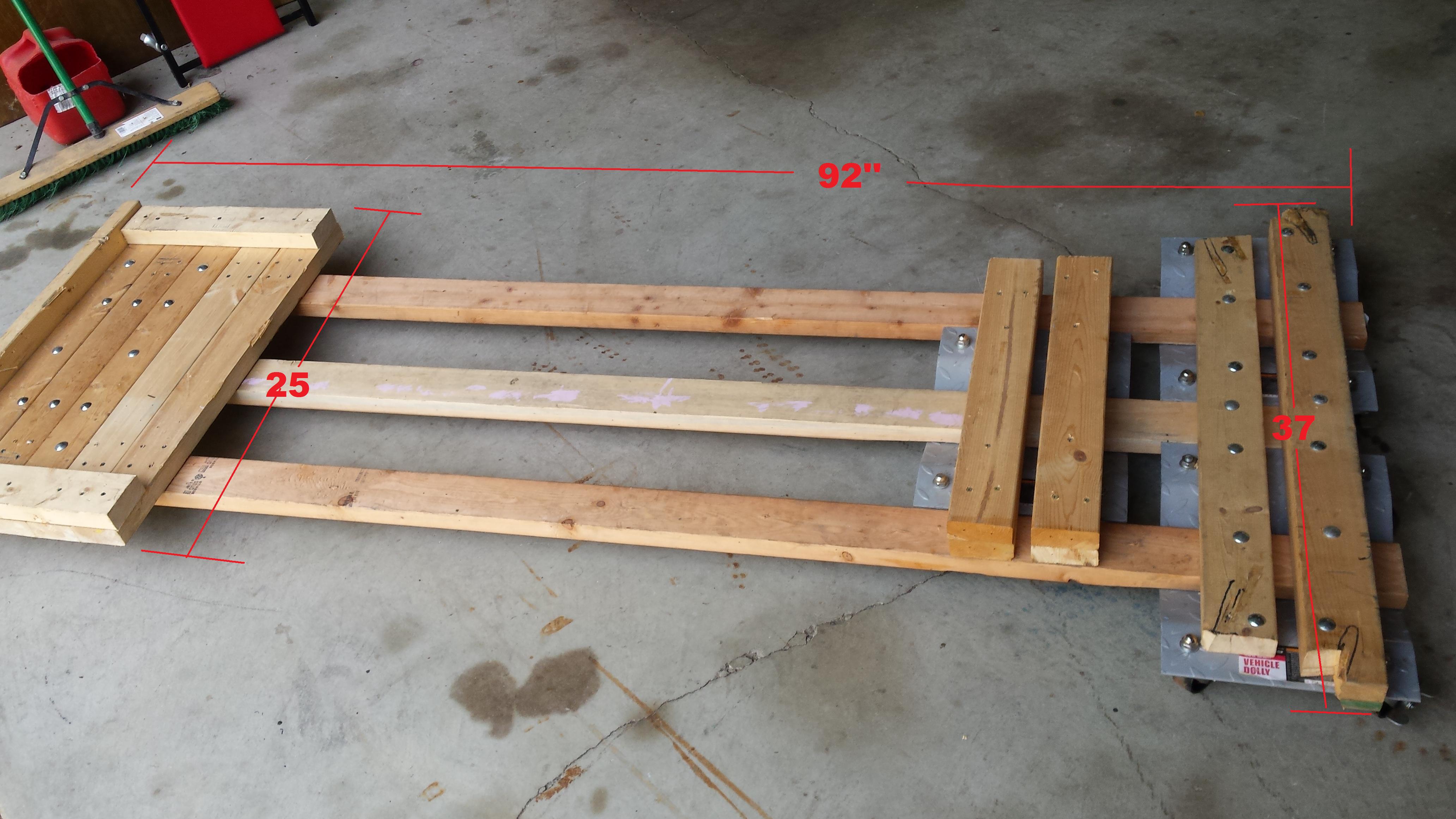

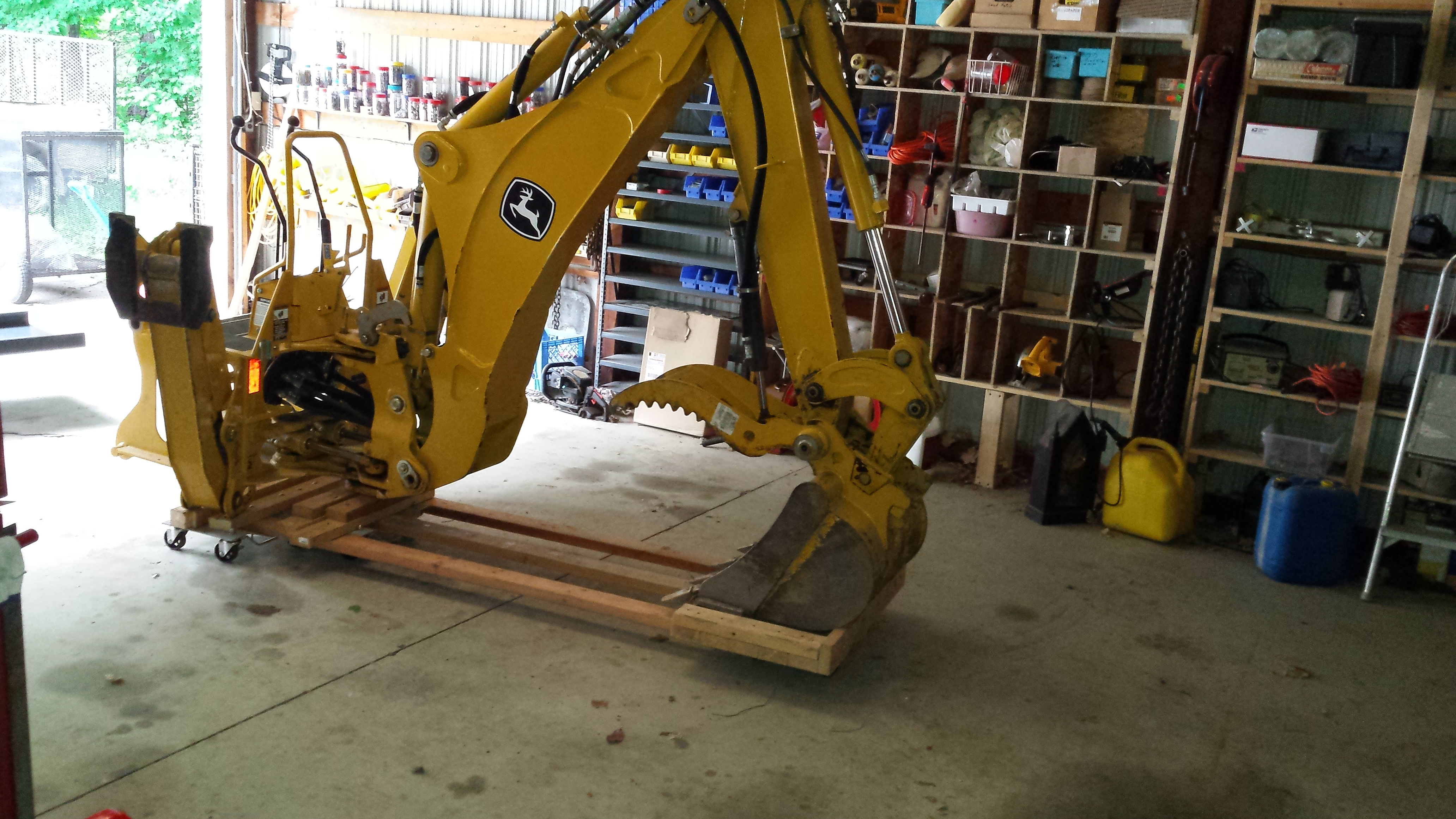

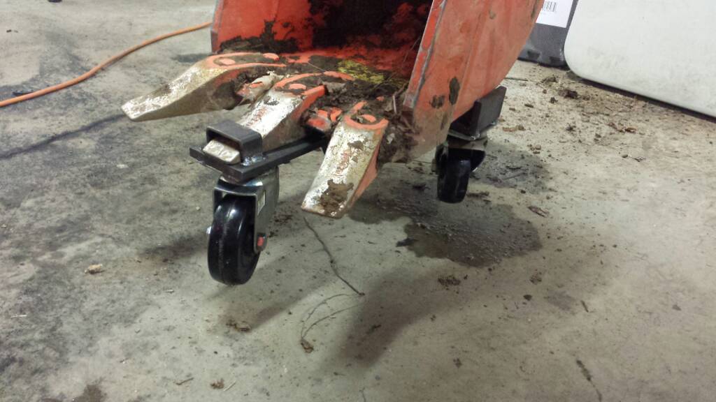

I used some HFT Dollies and 2 x 4's
/ Dolly for Backhoe? #22
Nice improvise... but those little diameter casters I think would give me fits. Need pretty smooth surface with no pebbles. My dolly casters are 5in diameter and function very well... I think that is a key design parameter if you build one.
I agree...the larger diameter wheels will make it easier to move on rougher surfaces. As I mentioned I had these hanging around, and being on a smooth surface, the unit can be moved easily.
/ Dolly for Backhoe? #23
Just watch your garage door height...that's what put the stop to my storing inside on a dolly.
My backhoe is a Deere 448. It weights about 1500 lbs, so any dolly would have to be pretty stout. The weight didn't slow me down...but the measurements of the garage door sure did!

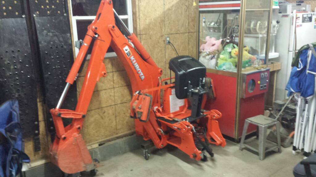

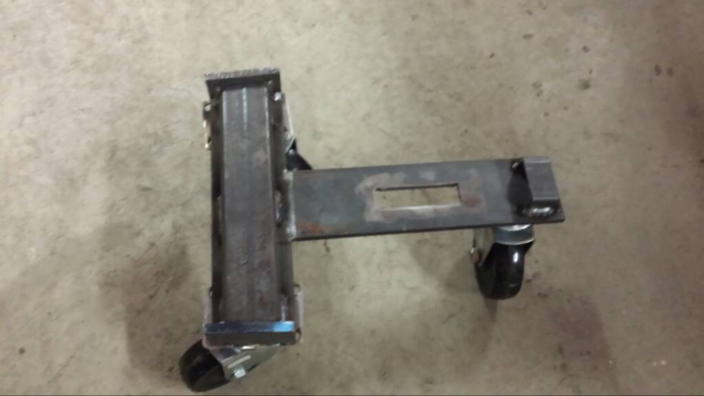

Awe man, now I got to re-do mine and it's your fault! That's a great idea, never crossed my mind.
Garage isn't very big and that backhoe is about 7ft long sitting on the ground if I remember right. I have to add one wheel to help stabilize it a little more but it works better than I would have thought. I just used steel I had laying around around harbor freight casters.

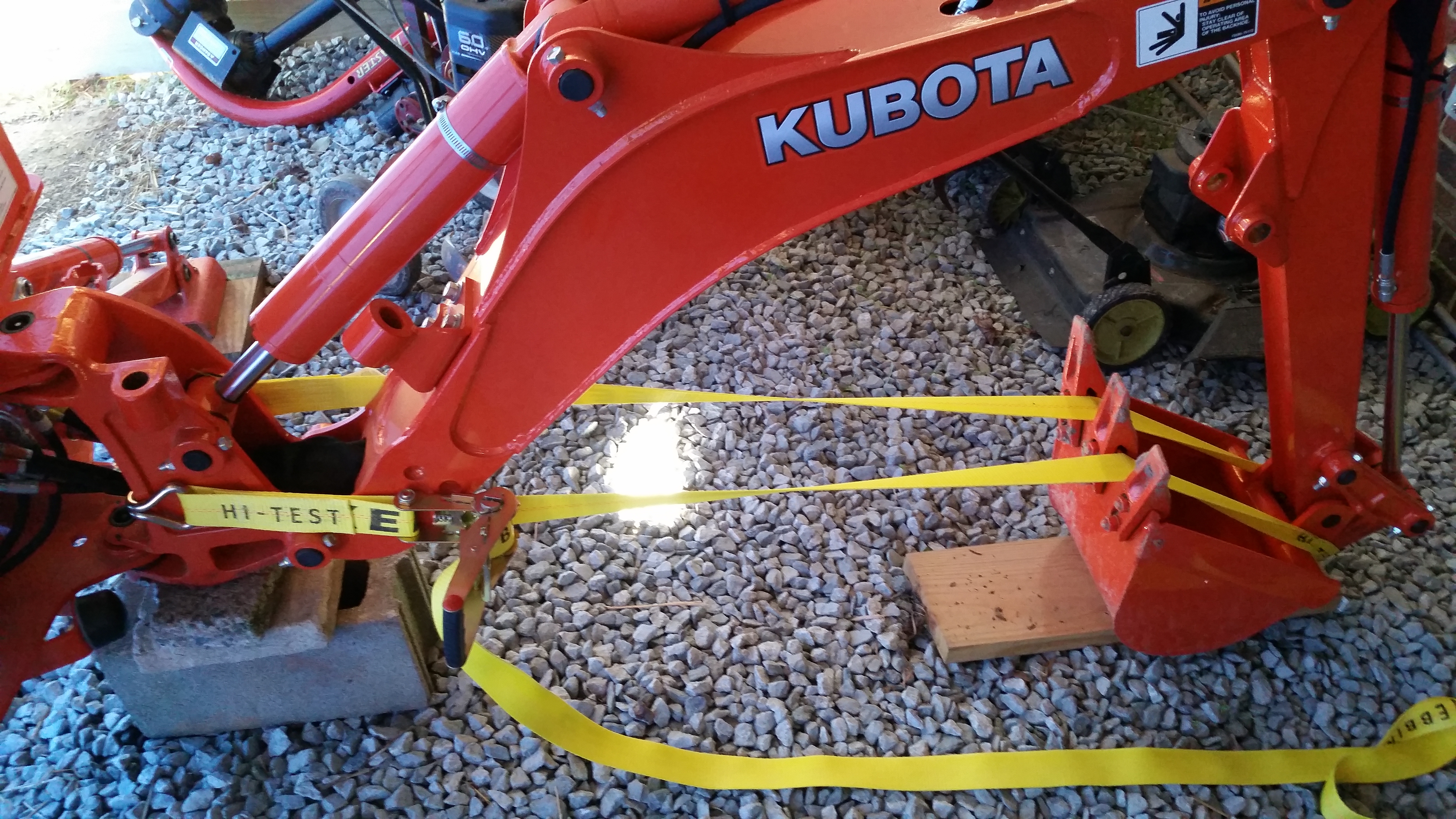

This is what I do with mine:
To move it around, you could put it on one or more dollies.

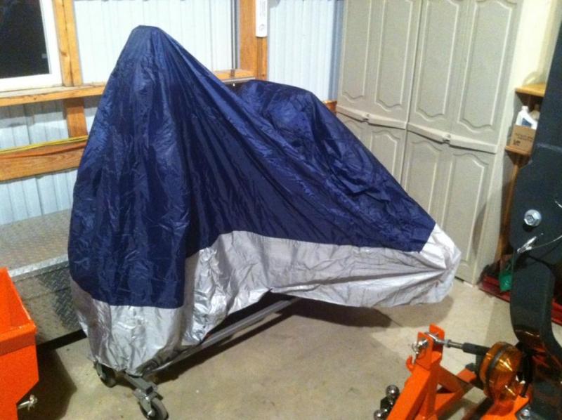

There is some great looking dollies here, I opted for Bxpanded since I dont have a welder. Mine is inside and on concrete so it made since. Easy to move around to clean up the shed. Since its off 95% of the time I decided to cover it up too. A $20 large motorcycle cover did the trick. This is an old pic and have secured the outriggers better.

I believe my Backhoe attachment is over 1500 lb, I used HFT Dollies and 2 x 4's
/ Dolly for Backhoe? #31
I had a lighter bh and made a dolly using 3 moving furniture dollies and some 2x4 to hold them together. The rig would move on cement if the floor was very clean Lowes sells the furniture dollies I prefer the wood as the plastic has a tendency to break. Good luck
