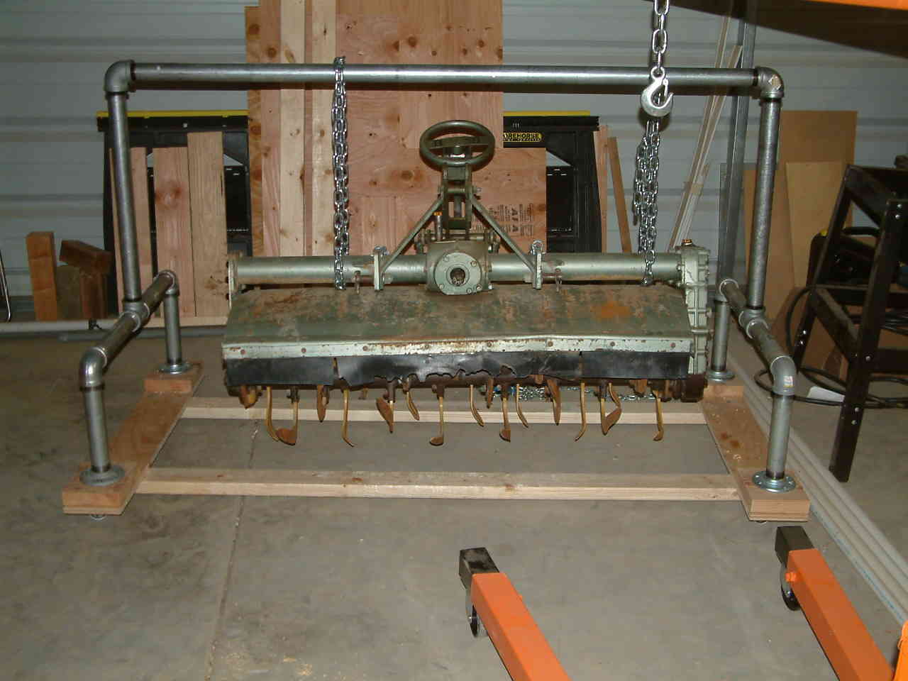

Here's the gantry-type dolly I built for my pre-owned Yanmar RS1200 rototiller (48" wide) that I use with my B7510HST.
Used 1.5" pipe fittings, which is probably overkill. 1.25" or 1" fittings would have been enough.
I used $3.50 metal swivel casters from Home Depot. Don't use plastic casters.
Total cost around $100, largely for the steel.

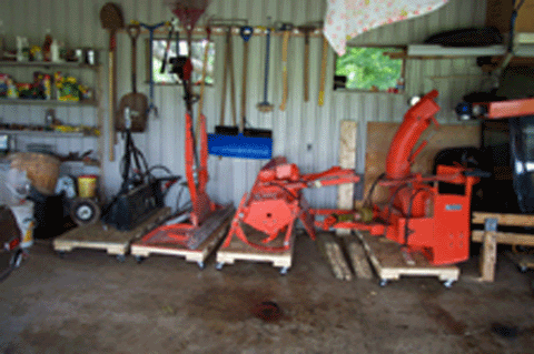

My dollies are much the same as ronjhall's, except I put plywood floors on mine. The attached shows four in use in my garage, loaded from left to right with an aerator, a dozer blade, a tiller and a snowblower. I also have one for my rotary broom. /forums/images/graemlins/smile.gif
