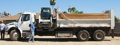

I'm doing more tree work and I don't have a second driver. I was thinking of loading my bobcat ct 120 in my rack body dump truck with loading ramps along with my stump grinder

A ct120 is the smallest compact tractor I know. It is about 3,000 lbs.
the idea is to take the tractor, the stump grinder and the chipper to the site in one trip. Get to the job unload, Cut down the tree down chip it and load the rounds. Go dump come back load the equipment, connect the chipper and go home.

Whats the weight of the bobcat? Whats the empty weight of the truck? The GVWR of the truck? As long as those all line up weight wise you should be good. I would make sure you have some good ramps. Back when I drove trucks 48 state I hauled alot of the conversion vans on a 48' flat bed. I bought a set of Aluminum ramps to load, worth thier weight in gold. I would add a way to secure the Bobcat while in transport also. In Texas you can also add weight to the registation of the truck. I am legal for 5k on my 1 ton with the uprate. Truck never has had a problem and it has 350k on it now. Some states allow uprating some dont as I understand it.
That's what I was thinking. And maybe some good tie down points.

One man's solution:
