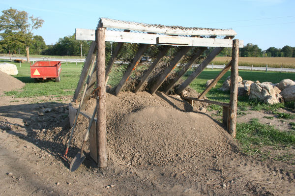

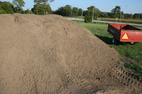

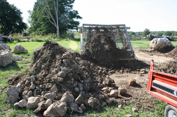

Here are a few pictures taken last summer of my screen in action. It has a large footprint of 10' x 10'. I have lost count of how many yards of soil I have screened with it. My ground is littered with rock between the size of golf balls right up to 5' x 6' so when ever I do any dirt moving I always run into lot of rock.

That's what the rake and shovel are for. After every bucket I have to get off the tractor and pull the roots and branches off the screen. Easier than it looks. It goes much faster if you have a helper knocking off the branches as you go.

I got my finished soil from one ride down the slope of the screen.
Admittedly, it doesn't sepearate everything and you still end up with some good stuff falling with the rocks and debris. The spoils could be re-screened a 2nd time, if you want to get all the good stuff out of it.

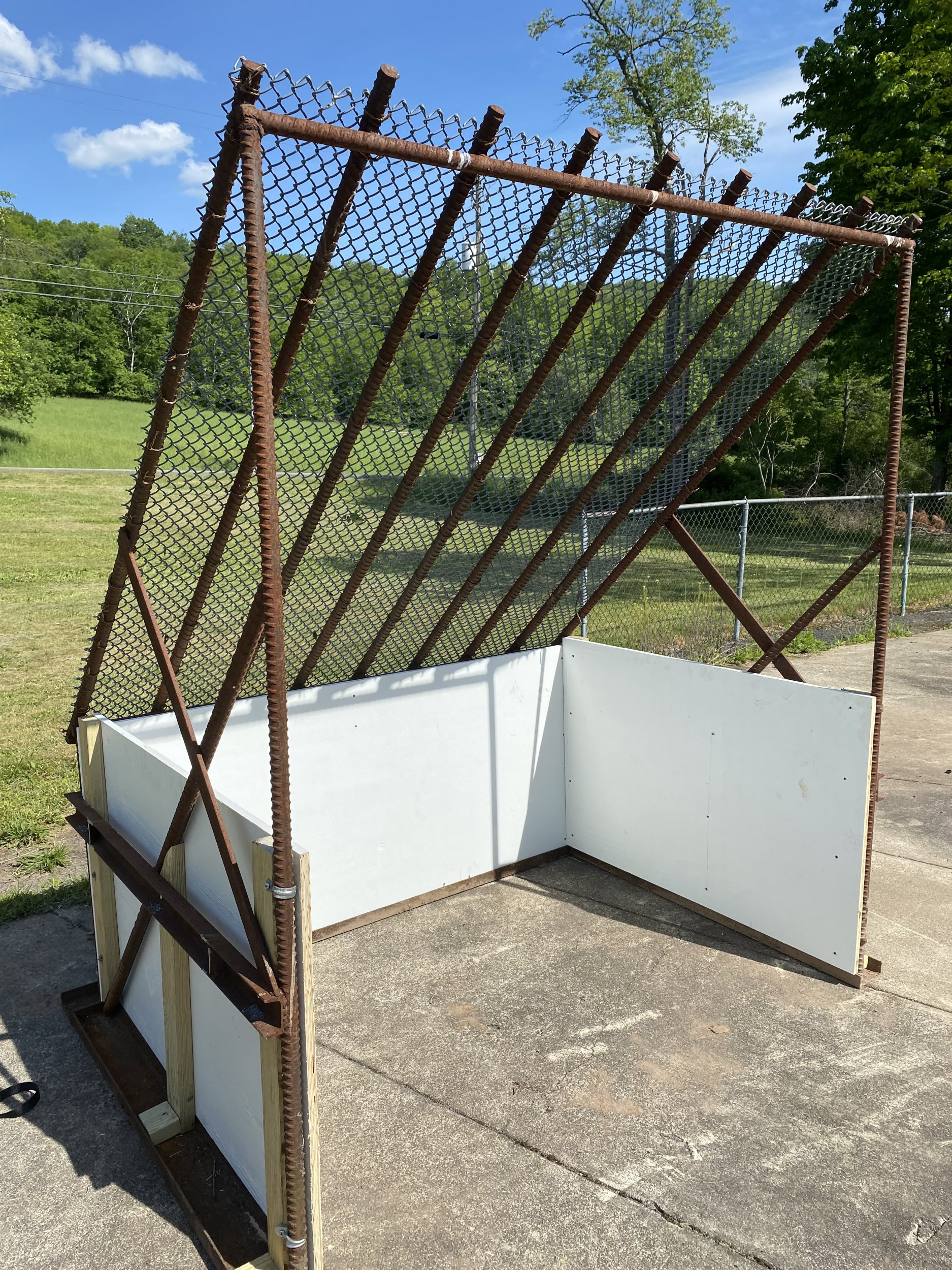

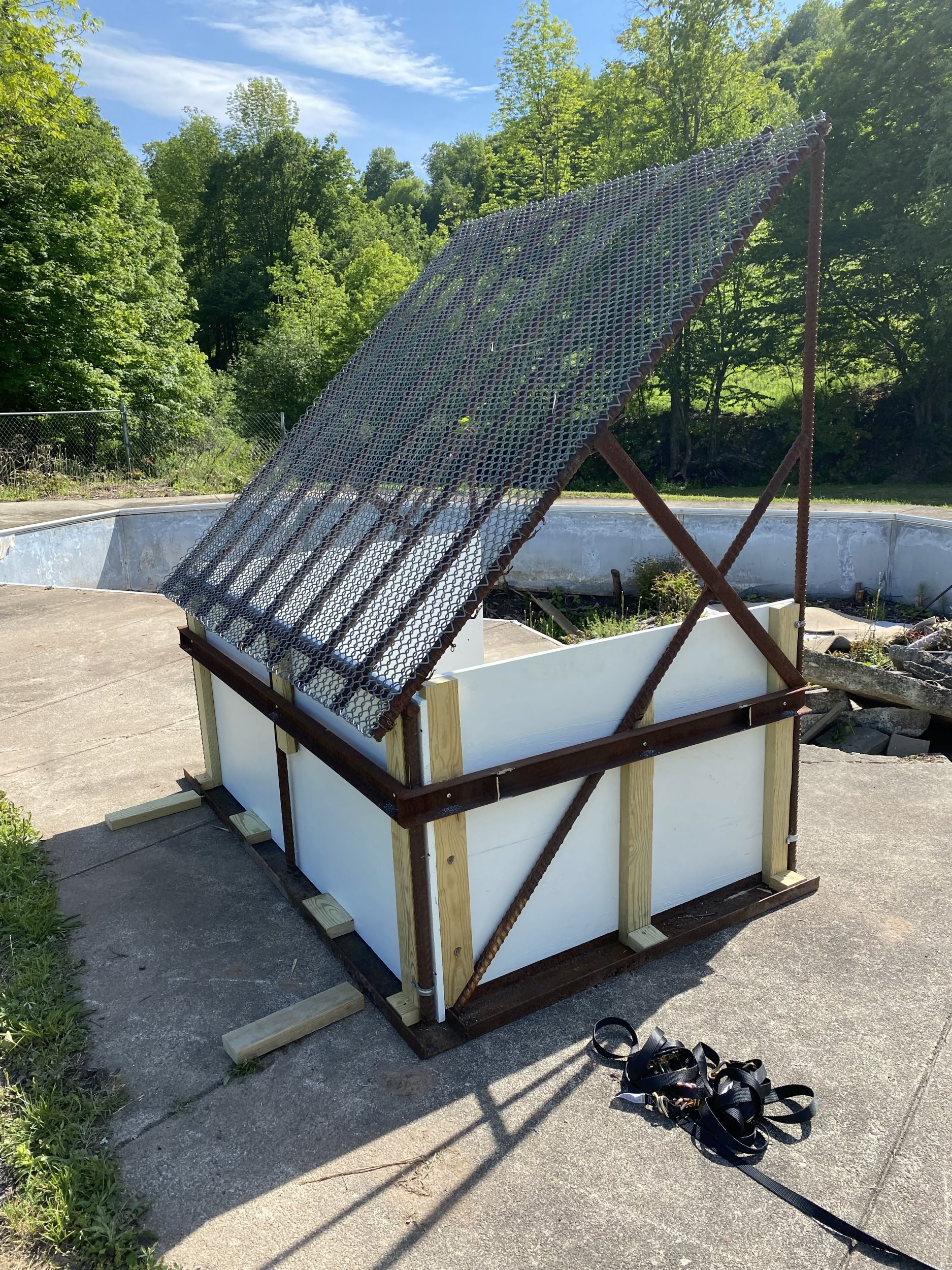

66” wide simple word for me
