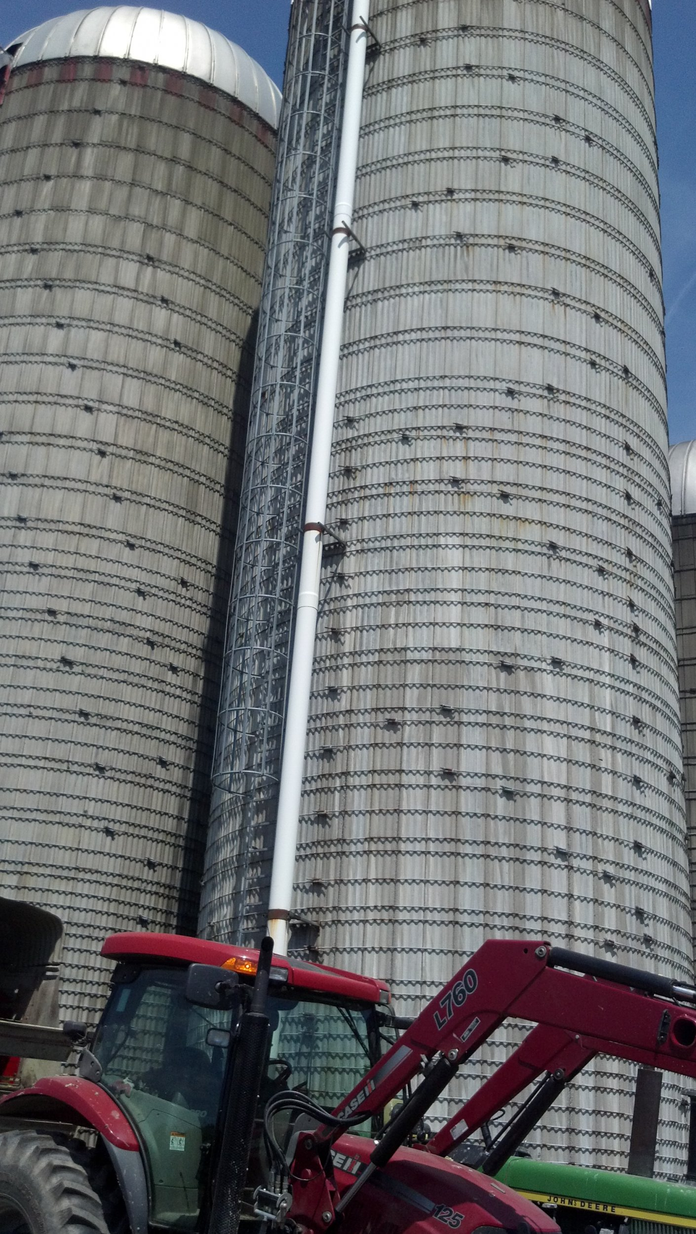

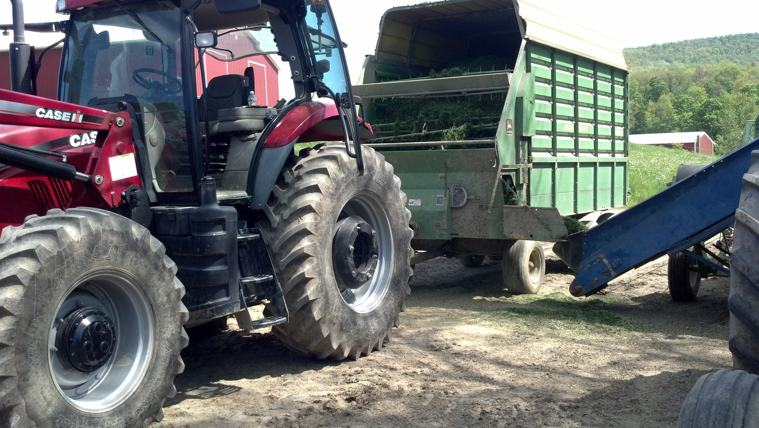

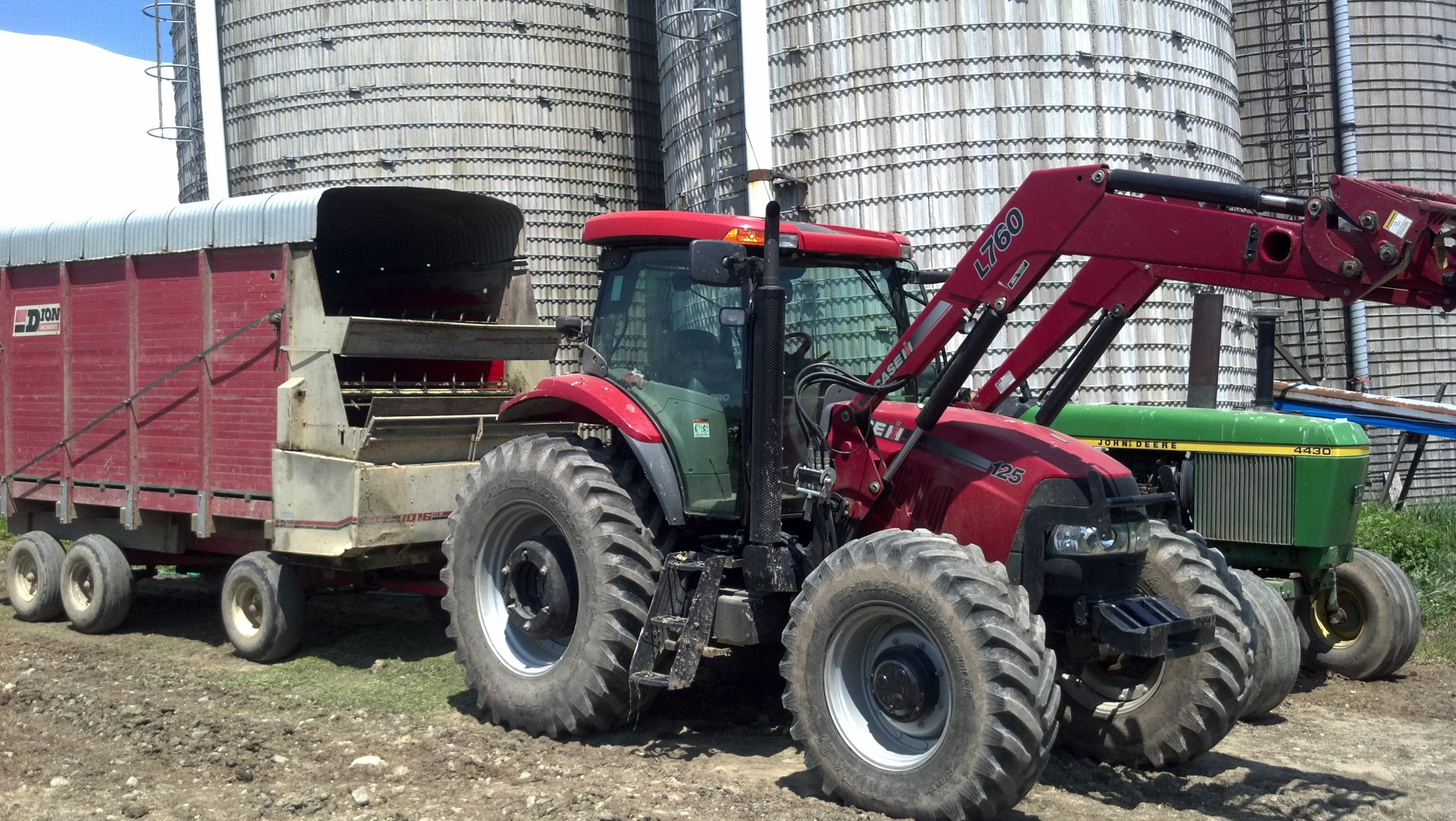

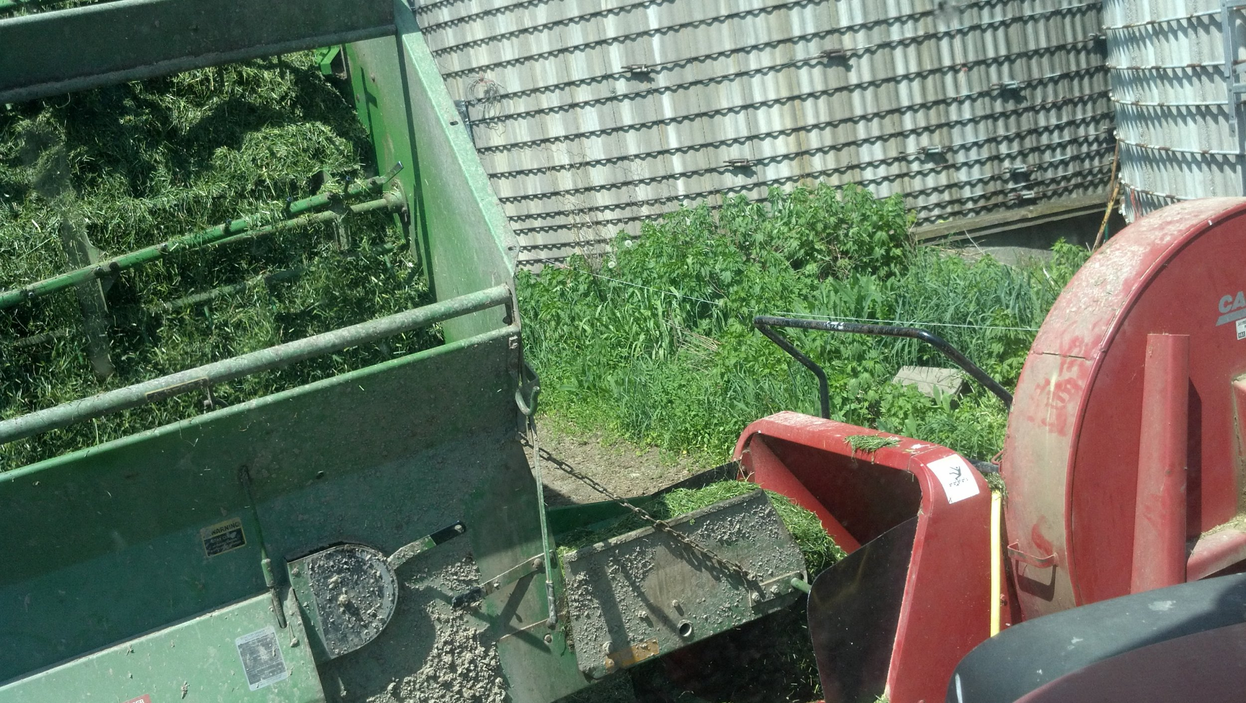

Or the immense fun of standing between two tractors with running PTO's one on a self unloading wagon to operate the
controls for the beaters the feed conveyor (discharge) and the apron speed, with the other tractor on a forage blower at full pto speed
to blow the silage up in the silo. Then all of a sudden a big slug gets by you into the blower and the blower tractor starts bogging down and you know it's going to plug the blower pipe before you can clutch the blower table or stop the pto on the blower so it's not packed tighter then heck for 20-70 feet of pipe, which is going to take an hour to unplug which means shutting the whole operation down, two to four more men and tractors.
Talk about working in close proximity to potential hazardous conditions, and having to maintain safe operation.

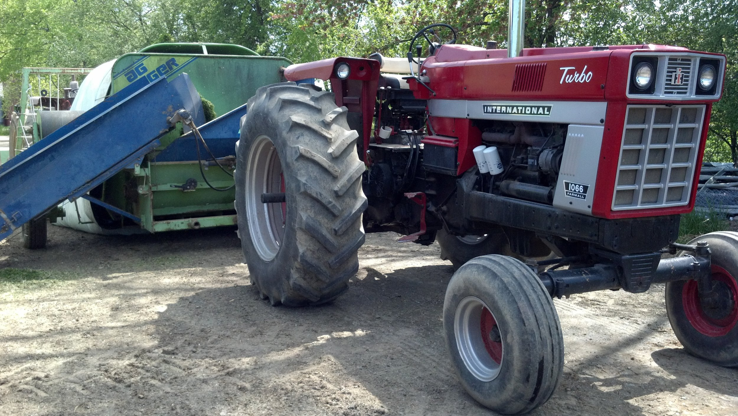

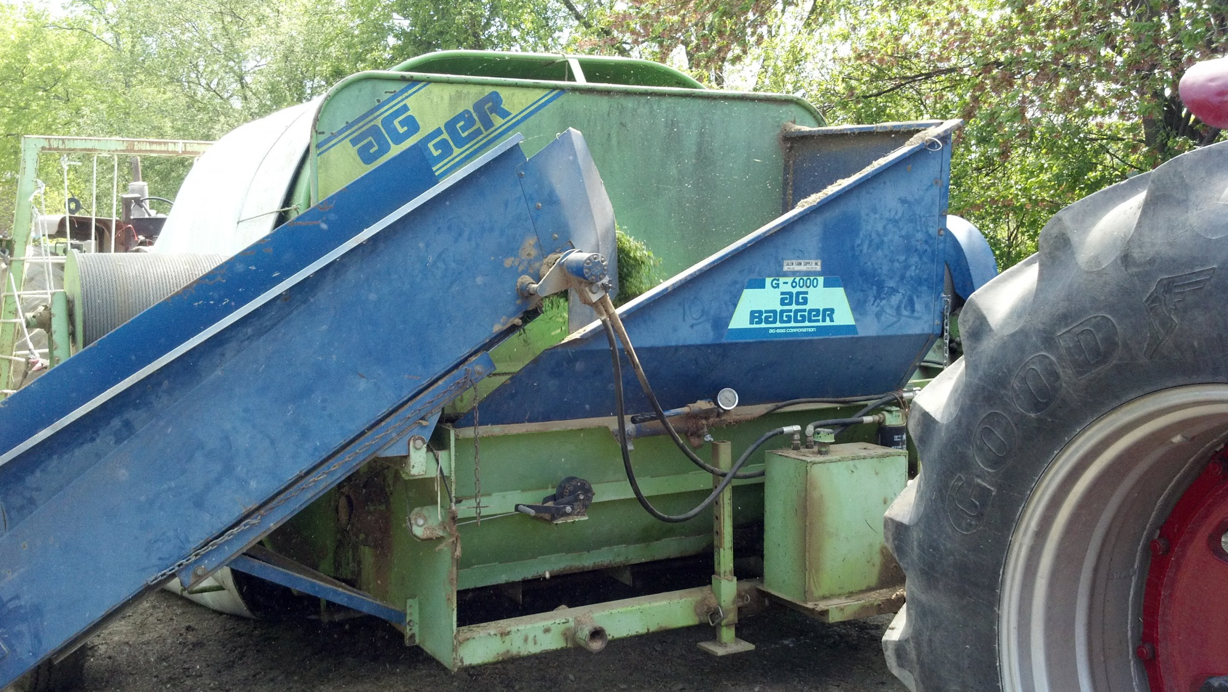

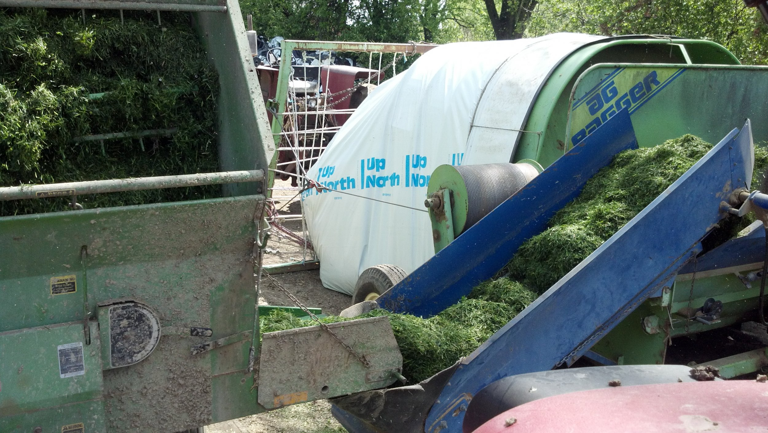

Our forage operation is both summer and fall. We don't use the upright silos anymore instead we use a bagger to make 200 ft sausage rolls.
While the milk cows were on the farm.
And also a few bags of feed;
1st load going into a new bag
3rd or 4th load into the bag
about 200 tons per bag,
last year they had 9 or 10 bags full.
