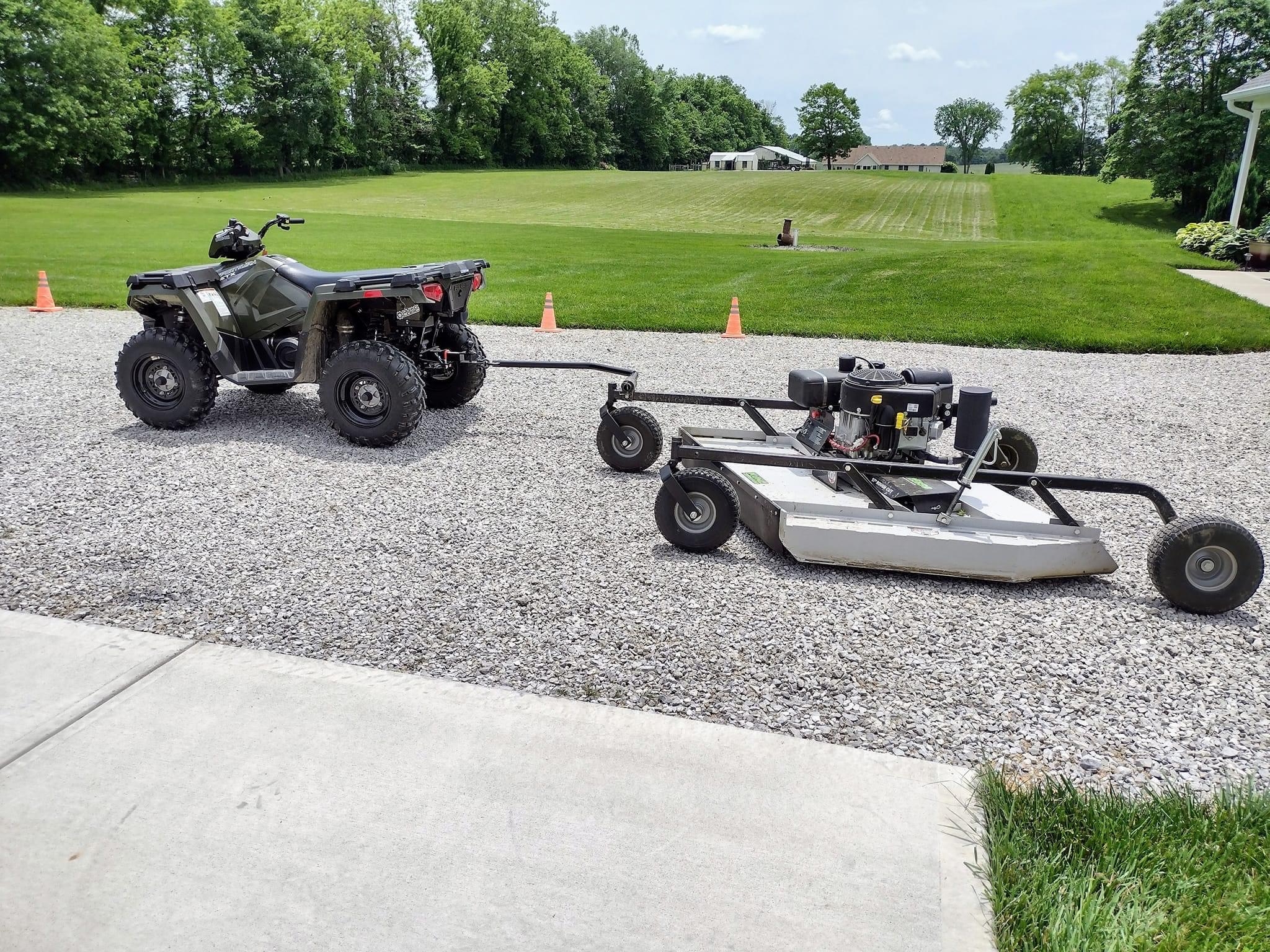

Has anyone experience with the DR Field And Brush Mower? I do annual bush hog work but am looking at this for lighter work. It can be pulled with an ATV or SCUT. I am looking at Model Pro 44t.
It is claimed to be able to cut up to 3 inch brush. Is this a capable machine? Can it handle rough ground? Maintenance issues? Any help and advice is appreciated.
