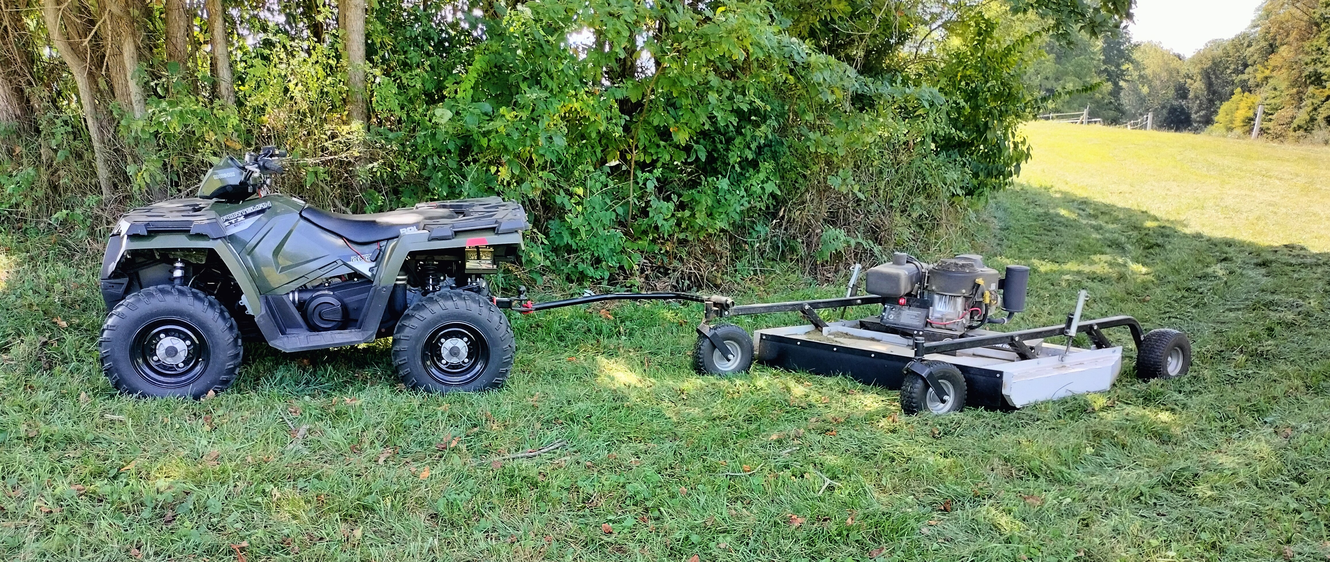

Don't want to change topic but has anyone used DR pull behind mower. I have an area near a pond where my tractor will sometimes get stuck in softer ground. Was thinking the pull behind would be great since my 4-wheeler wouldn't get stuck as easily
I bought one many years ago. A complete disappointment compared to the walk behind. 4 wheeler couldn't pull it on mild, damp slopes.

I've used one of these rough cut walked behinds once, and swore I'd never do it again. Wrestling those things around in anything but grass on smooth ground, is terrible IMHO.
I gladly spent $5k on a 28hp tow behind cutter the next week. Weighs 700lbs, 28hp, it is a monster. We have some decent slopes and the ATV doesn't need 4wd to climb them.

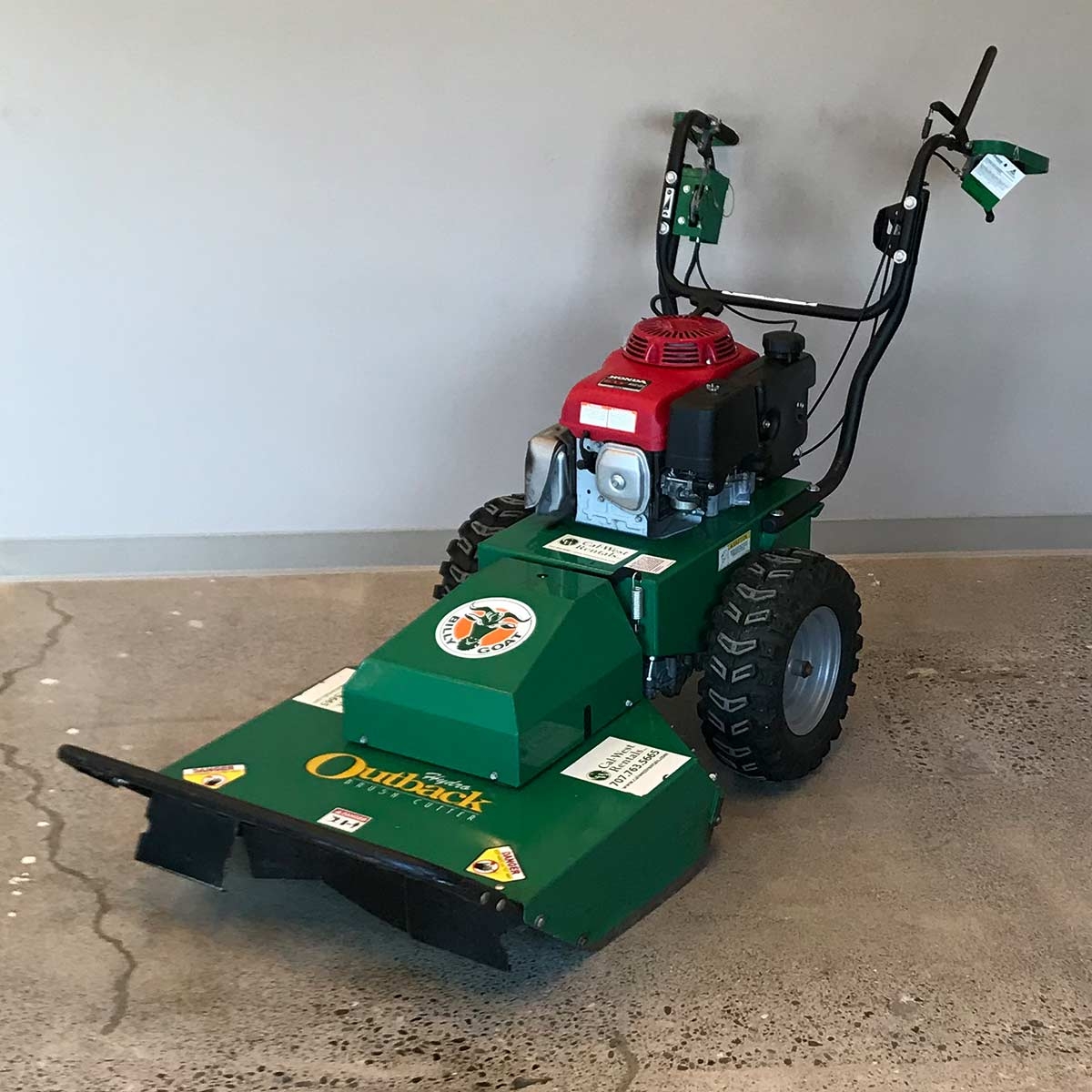

Buy a BillyGoat field mower! 13hp Honda engine, 24” cut, weighs 300 or so pounds, cuts incredible. Will take out 3” saplings like nothing, three forward and a reverse gears. Look them up in action, will do everything you want with it. Just looked them up, now have B&S engines, can’t say if better than Honda. If you can find used will save lots. Don’t get caster wheels, get what’s pictured.

I have, and they are terrible to attempt to wrangle on uneven terrain, and they will not bend over a 3" tree... That's why we bought a 800lb pull behind with 28hp.

I can handle the BillyGoat just fine, I’m not dainty. Any machine in rough terrain is going to throw you around, even my backhoe and skid steer bounce around. And I do use BCS for my landscaping business.
