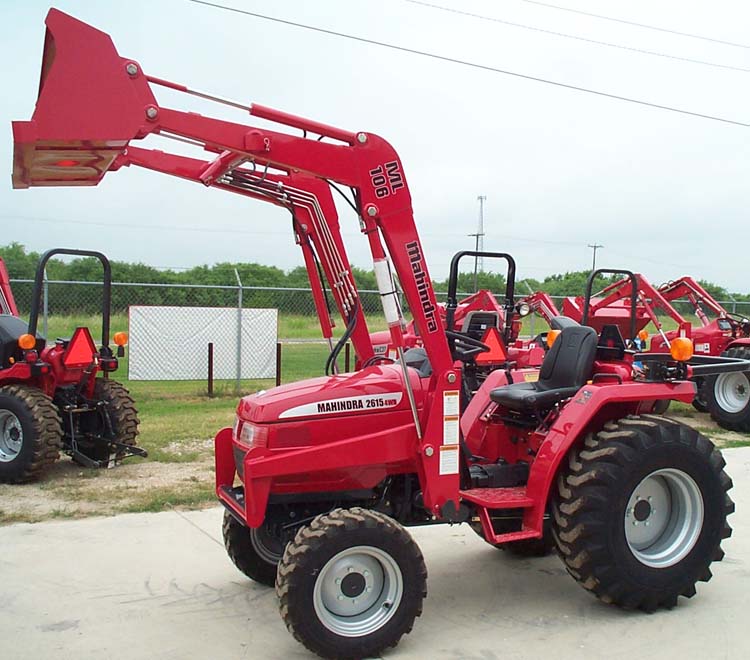

I got my Mahindra 2615 in march and am very happy with it! But I have tried e-mailing the company a couple times about getting a draft control added on to it. But have had no response back. Can any one tell me if the draft control has to be fractory installed or can it be done at my dealer? And at what cost if dealer installed? Hey and I just wanted to thank you guy's on this sight. I done a lot of reseach before buying my tractor. And this site was a big help!!!! /forums/images/graemlins/confused.gif
