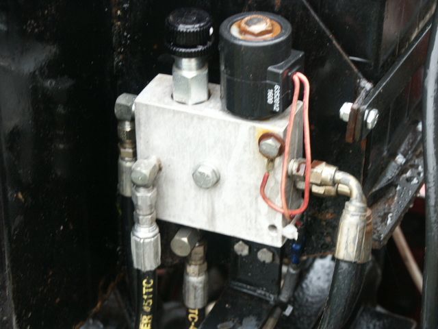

I'm not very good at this, but let me try to explain ( after some time trying to trouble shoot) how I think this all works.
First just the physicals. Woodlandfarms posted a pic of the draft control unit. Thanks. connected to it are five hoses. two come from either side of the tram pump. Mine are actually teed off the wheel motor circuits. One hose goes to the hydraulic tank. and two lines go to a splitter block in the front of the tractor for the lift cylinders. Also on the draft control block is the adjustable valve (small one) and solenoid valve connected to switch on dash. The splitter block in the lift circuit has two hoses from the lift valve (joystick), two hoses to each lift cylinder and the two hoses from the draft control block.
So here's how I think it all works, and I reserve the right to change my mind at any time. First when you switch on the draft control, the solenoid operates and opens two hyd paths. one is from the lift splitter block back to the tank. so if your not stepping on the tram the loader is , for all practical purposes, in float and theirs no lift being applied to the loader. The solenoid valve also opens a path thru the adjustable valve from the tram circuit to the splitter block, so when you step on the tram pressure is applied from the pump to the splitter in the lift circuit. I think the amount of lift applied is determined by the difference in flow allowed thru the adjustable valve and what can flow back thru the return which is probably restricted somewhat.
like I said, this theory is not official. just my trying to think it thru.
Reg

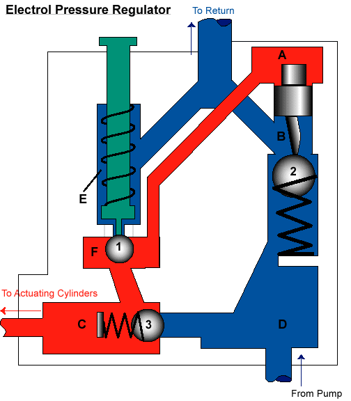

Dear RegL,
I think that is pretty close. The draft control is actually a pressure regulator, so as you turn the knob, the pressure in the lift arms rises or falls, controlling the amount of weight transferred to the tractor. To do that, the pump (engine) has to be going fast enough to generate the required pressure, which is usually somewhat above idle.
To make that happen is hydraulically a little complicated, but there are two examples on this page, of which this image shows what I think we have;
I hope that this helps.
All the best,
Peter
