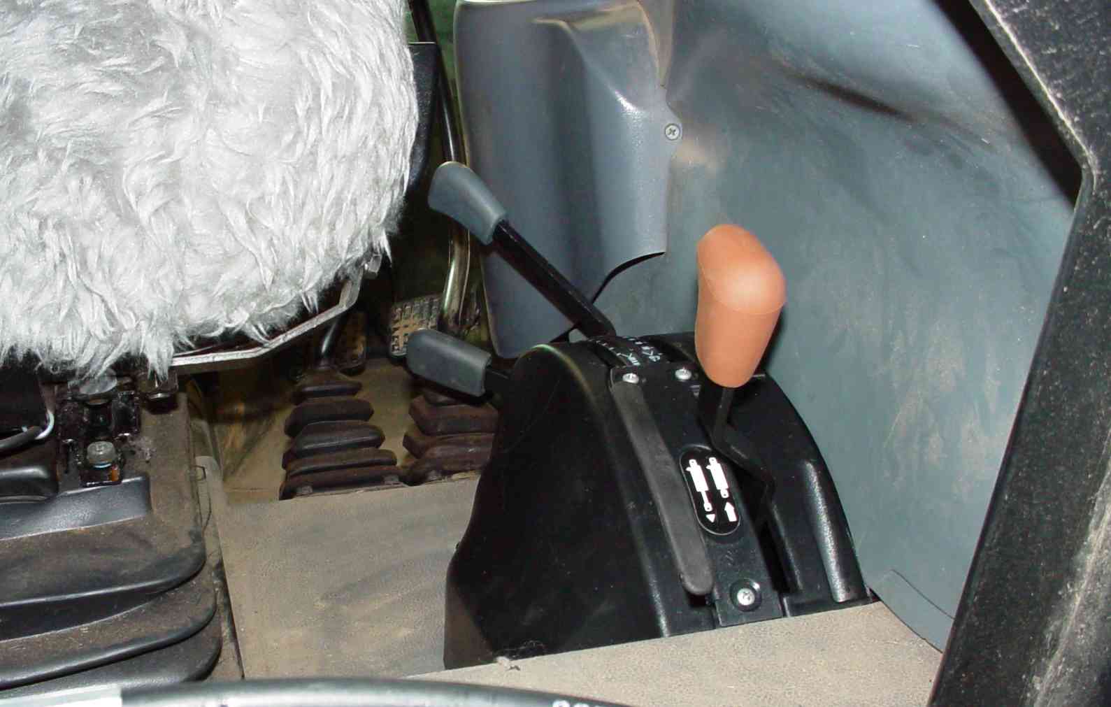

I have this on my TN.
In the picture you can see three levers. The one with a brown handle is a hydro remote. One of the others is draft control and the third is the three point lift.
The draft control works just like the other guys say.
I use it with my rear blade. This 9' blade can drag this tractor to a halt in 4wd if you take to much of a bite. So i set the draft control such that it lifts the blade a bit when it begins to strain the tractor.
The only negative with the setup on my machine is that since its hydraulic its a little slow in response. But a very handy thing to have for plows, blades, etc..

   / Draft control??? #8
Interesting picture - but what the heck is that big furry thing in the cab? My first thought was a geriatric Chewbacca, but I've never seen or heard of one driving a tractor...
