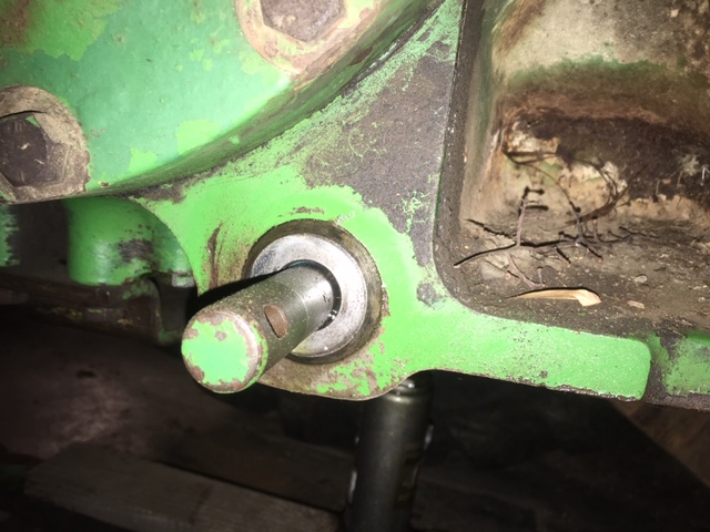

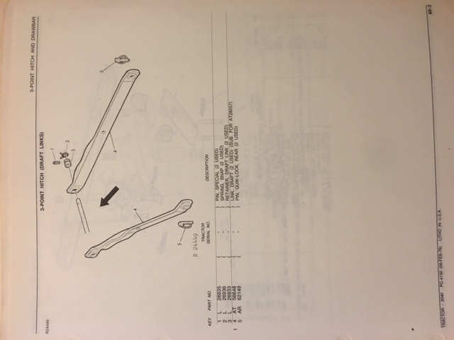

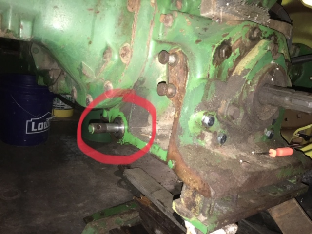

I was trying to remove both draft links for space reasons in the shop. Got one off with out much issue but couldn't get the other side. So I had the bright idea of just knocking the shaft through from the now open end so I could get at the stubborn pin better. Had NO idea the shaft holding them on went through the transmission thus giving me an unexpected fluid change. I was able to get the shaft back in but now it leaks. I'm guessing I screwed up some seals in there. Or I just made an existing leak worse?
How does one go about correcting this sort of mistake? All the info I致e seen looks to be for newer models and set up different.

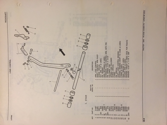

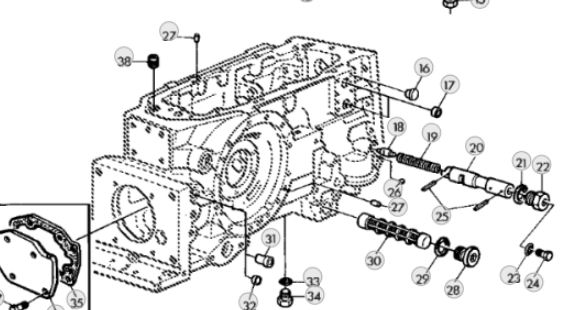

You need to drain hyd oil,place L/D lever under seat in "D",remove shaft,R&R seals,reinstall shaft & hyd oil. Parts required are 2 ea-T22098 & 2 ea-A4730R. Add shim washers so as to remove any side to side motion of shaft after draft links have been installed. This would be a good time to check sump screen(key 30) while you have hyd oil drained.

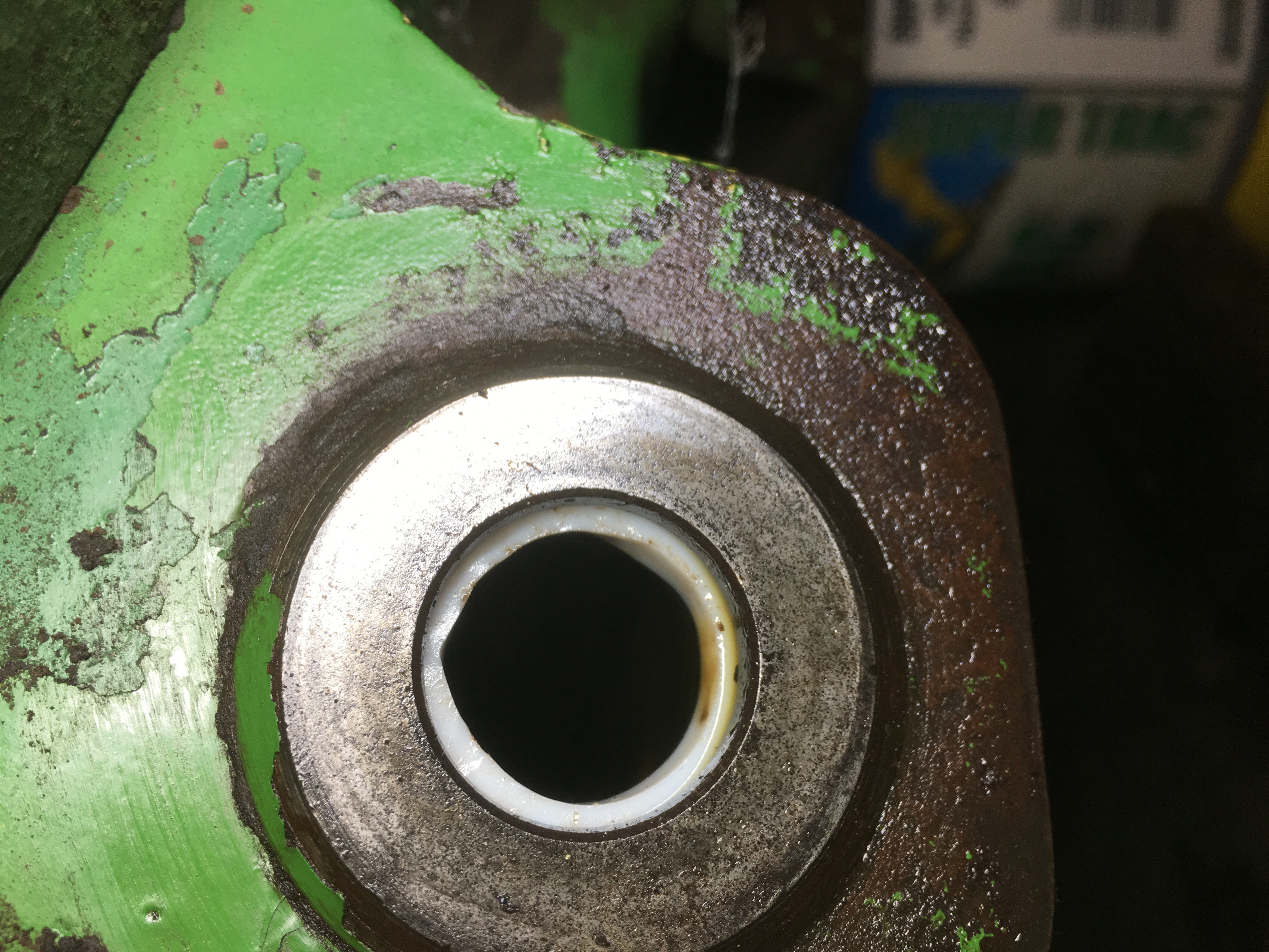

Well, I got them in. Hopefully they are ok, one Looks a little kinked.
   / Draft Link Shaft Leak '76 2040 #7
Maybe easier to change that kinked-one out now, rather than have the inevitable leak. ........or not?

From your picture, I would replace.
