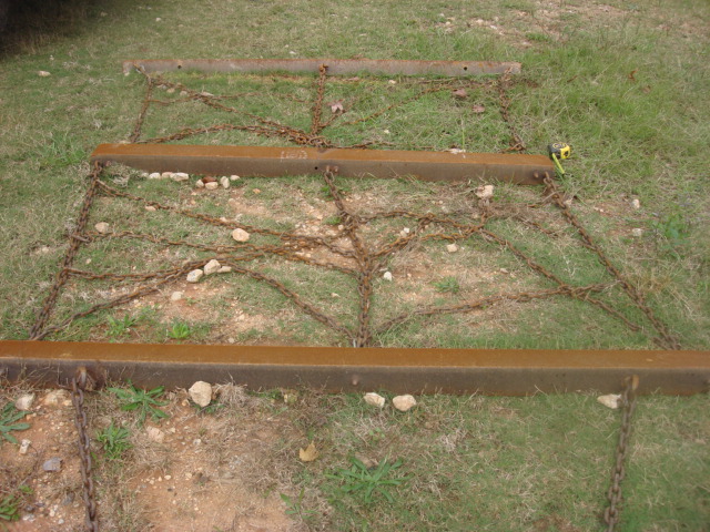

I am looking to build a relatively inexpensive drag for behind my disk. I want it to smooth out and break up clods. I was thinking about an 8" pipe filled with concrete with a chain running through the middle. Would this work? Or is a chain harrow worth the investment?

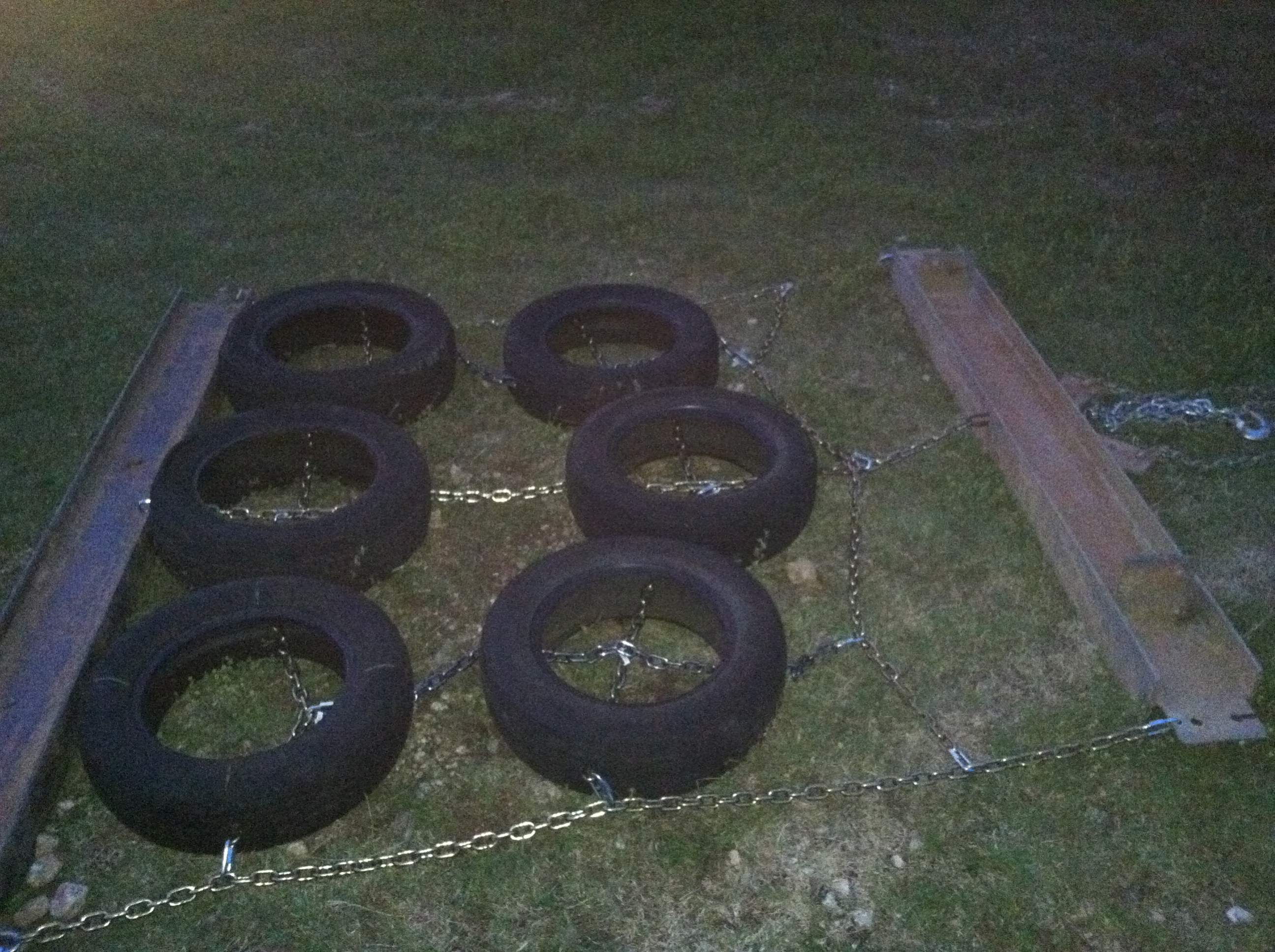

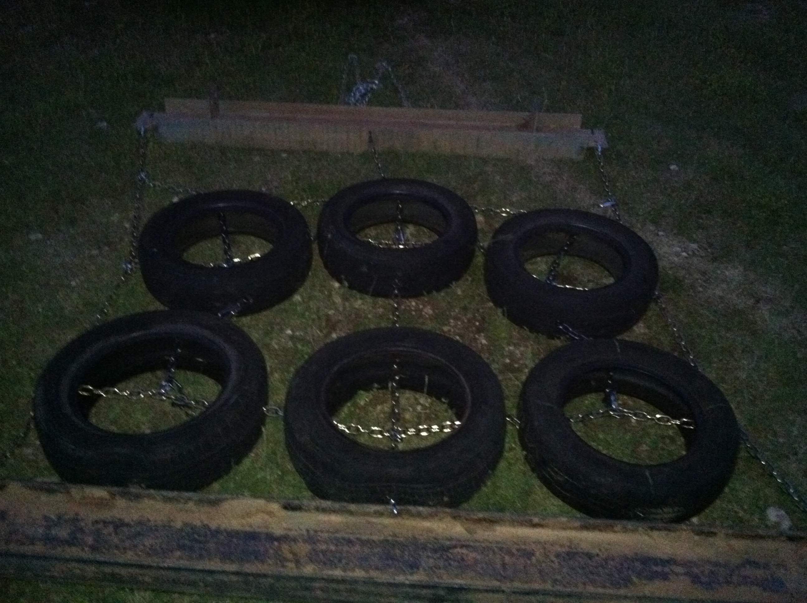

drag harrow007.JPGI made a simple drag made of parallel pieces of scrap angle or even I beam, linked with a "net" of cross-linked chains. One also had some old tires suspended in the chain net, by drilling holes in the tread and running the chain thru them. It works great. Was cheap, and effective. It does surprisingly well even leveling and cleaning up the dirt roads and is bombproof

no welding required. Just drilling 1/2 " holes for eye bolts. I did no welding on these. The edge of the angle acts like a scrape blade, probably better that a round surface for leveling
