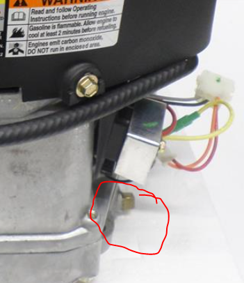

It is in a very tight spot. The engine sits on the frame and pug is at the bottom of the engine. Here is a picture of the engine. This reminds me of the thread about greasing a tractor....You have to wonder who designed this.
I am working at getting an extension for the plug for 2 reasons: access and less of an oil spill.

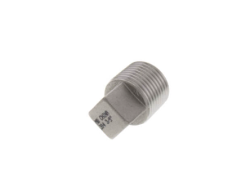

Trying to recall where I have seen plugs with recessed square heads? Conduit plugs?
Look at the fill/drain plugs on older cars rear end pumpkins. I have a double ended wrench to take out those plugs that has seven different square tips on it. I restore antique cars, and have used most of those tips at one time or another. The common sizes are 3/8”, 7/16”, and 1/2”. My wrench ranges from 1/4” on up to 5/8”. Crazy tool, I inherited it from my father who worked as a mechanic back in the late 20s to the mid 30s.
