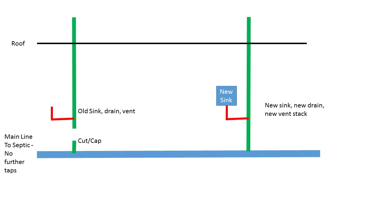

A drain vent question -
I attached an artful drawing for your enjoyment.
I moved our kitchen about 15' further down the line. Installed a new sink, new drain, and vent up and out.
I am thinking I can just cut and cap the old drain and vent. It served only the old sink.
What gives me pause is the fact that it is the last stop on the main line before it exits the house. It is a 2" vent, so I dont think it was ever intended to be a mian system vent.
I would rather not have to keep it - I am eventually going to add a window to the wall it traverses, which means re-routing the entire vent stack.
So what do you think? Cut and cap that sucker and forget about it?

are there any other fixtures on that branch that you left out? the IRCs will tell you how many DFU's you can have per branch and per vent. I don't see a problem with it as long as nothing has been left out. MAKE SURE you have slope in the vent!

No need to over complicate this- cut and cap the old drain. That vent (by code) doesn’t serve anything else.
Fixture units don’t apply in this case.

Cut and cap the vent. Remove the vent pipe from the roof and patch the hole.
BTW - the "artful drawing" is better than two paragraphs of words.

I agree. Cut and cap.
They ALWAYS apply. I was unsure if there was more to the situation than the drawing implied.

Cap it and 'foggeta bout it'.....

Cut and Cap!
