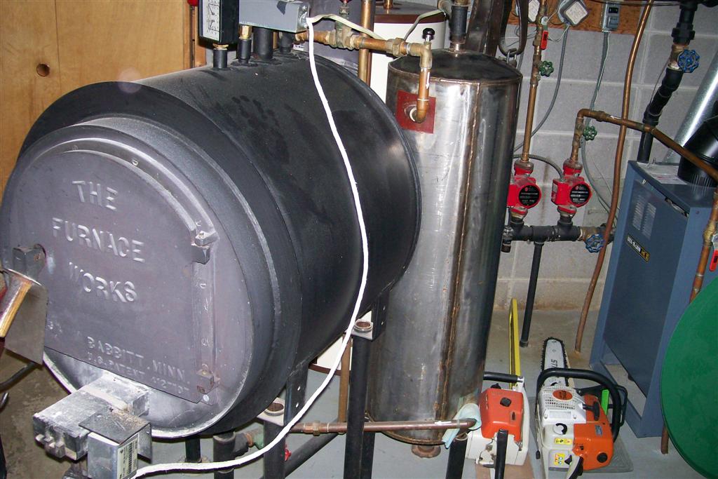

I pre-warm the cold water before the house hot water heater using a 30 gal stainless tank that has a 3/4 copper coil that has wood boiler water circulating through it. During the winter heating season, that water is 110 - 170 deg F and it works quite well. Shown here to the right of the woodburner (water system).
