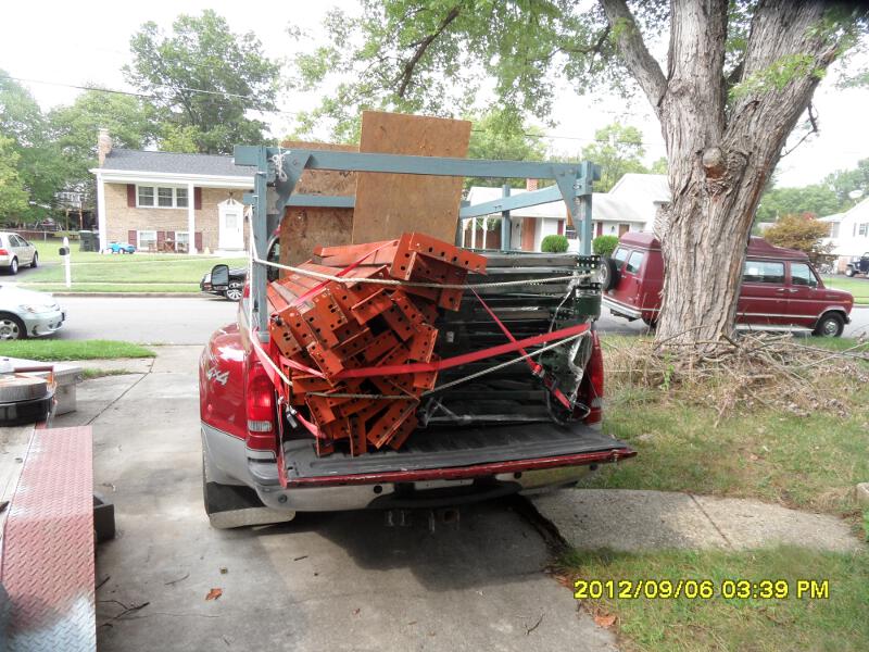

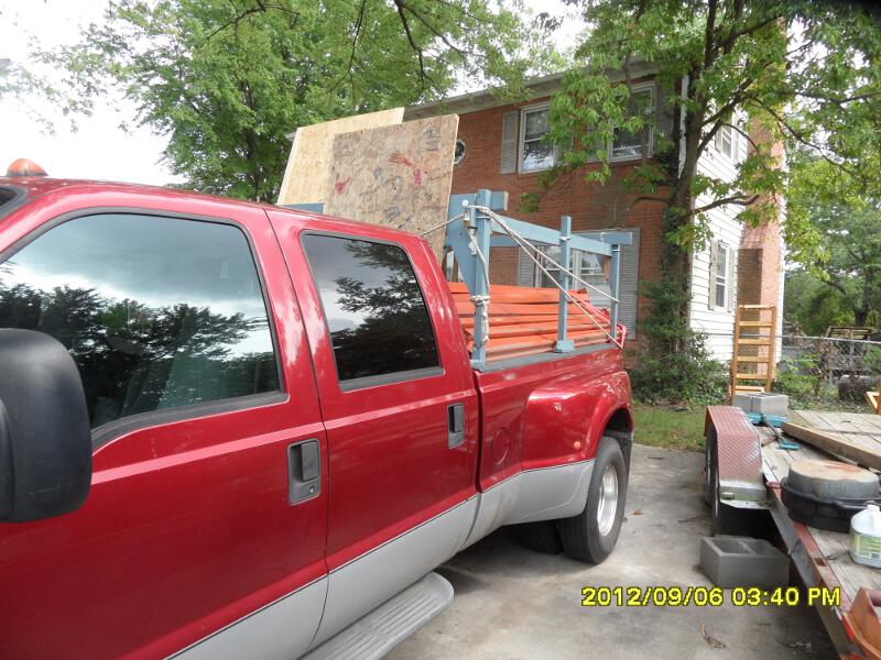

Thanks.
1. Have not even tried the hose. All my other vehicles have an "anti-siphon" device.
Can't fill anything else - per the policy the fuel HAS to go into the vehicle, otherwise I'd just use jerry cans.
Installing an aux. fuel tank takes up bed space. Sometimes I need all I can get.
2. I know the HPOP oil is circulated, but on the other forum some posters have written of significant "sludge" found.
