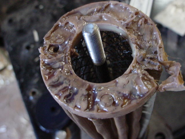

   / Draining the Hydraulics #7
My filter did not have any "glue" holding it together. It was made up of three main parts a cap with a thick rubber washer on it, a cylinder with holes in it wrapped with a very fine brass screen and the bottom assembly with a tube passing through a flat plate with a rubber washer on it. Basically the cylinder with holes in it wrapped with a very fine brass screen is clamped between two plates with rubber washers on them; a bolt clamps the assembly together. Honestly it is not a bad design very service able and sturdy. But my Jinma is new made 12-2004, I have noted a lot of design differences between mine and earlier Jinma’s such as a different oil filter, the filter mentioned above, permanently sealed bearings on the water pump, Ect. Also for reasons I cannot explain I do not seem to have very many metric bolts on my Jinma. I am a very experienced Volkswagen mechanic and of course most of my tools are metric , However most the bolts on the Jima that I have worked with were in inches (American ) I really cannot explain this as most manufactures are going the opposite way. Any one have any thoughts.
