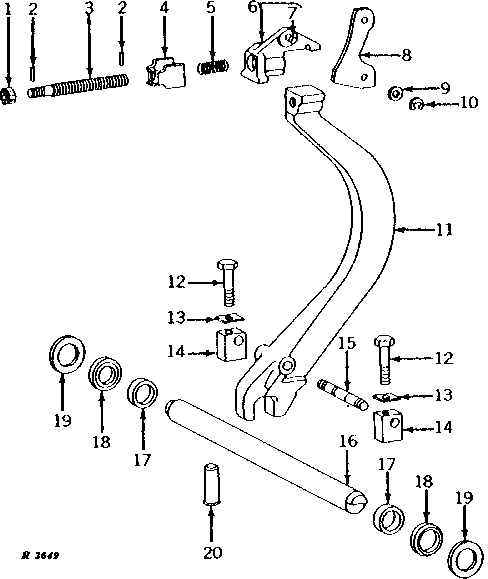

Shaft seals are called load control seals. Be sure to put L/D control lever under seat in "D" before reinserting shaft to make reinstalling shaft easier. There are better aftermarket bushings & seals than JD's design made by Boling Machine shop. 660-699-3717 Boling Machine

Also wondering how to get the front pin out for the front support. Manual shows a roll pin that holds the main pin in place, but I can't tell how it's supposed to be removed.
   / Draw Bar Hydraulic Leak #4
I can't remember how to remove roll pin but I'll ask a tech friend of mine & report back
   / Draw Bar Hydraulic Leak #5
Here's what one good JD technician stated.[/quote]I use a good squared off punch and shear it by hitting the pin, they are in a blind hole.[/quote]
Here's what another good tech stated.[/quote]With the drawbar support off the tractor, drive the roll pin through to the center of the bushing. The roll pin does not hold the pin in the tractor but holds the bushing from turning.[/quote]

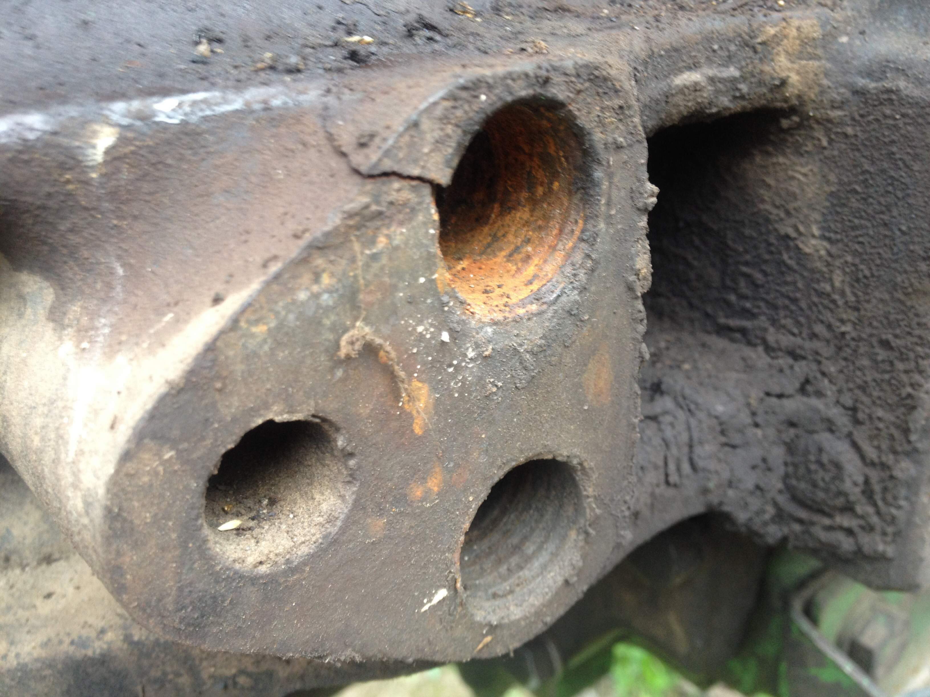

Since I got ya Jim, what do you think about drilling and tapping the loader mounts from 7/8" to 1". The one side of mine has stripped threads.

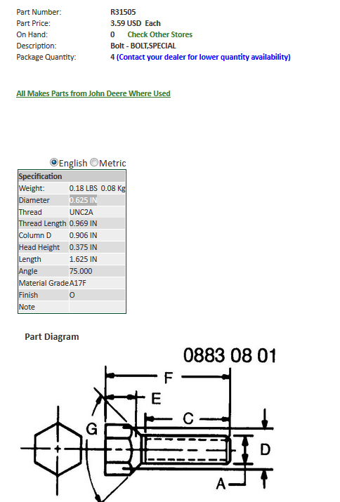

What loader 7/8 loader mount bolts are you referring to? Side frame bolts can give problems but they're 5/8 inch in diameter. On stripped threads in block I always utilized helicoils if possible to utilize original chamfer headed bolts.
It's the bolts going into the block. I priced out a helicoil set for $200CAD so decided to drill and tap one size up
#9

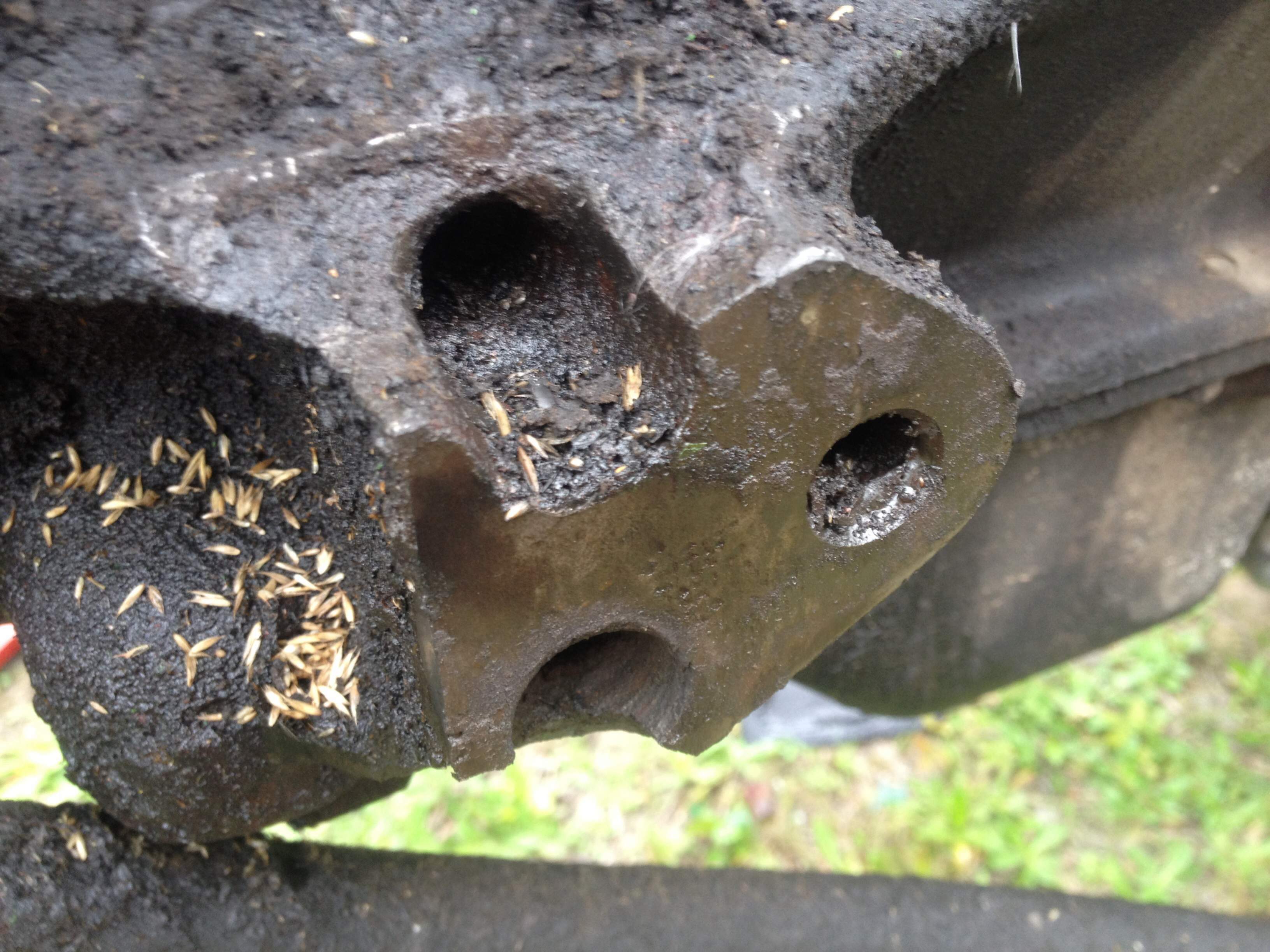

Here are my mounting holes. A little worse than just stripped. Suggestions?image.jpgimage.jpg
   / Draw Bar Hydraulic Leak #10

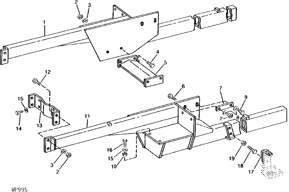

I'll suggest to add some extensions to FEL mounting brackets that extend to rear axle housings similar to photo.
