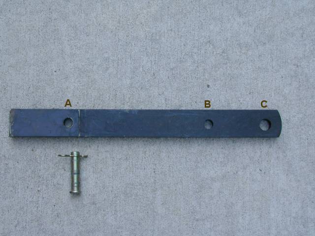

I found these dimensions on an earlier thread and wanted to know if anyone with a 71xx series Cub could verify that they are correct for that tractor series. I have a 7194 and do not want to pay $196 for a $20 piece of cold rolled steel with three holes drilled in it. I will build it myself.
Overall length: 19-3/16"
Overall width: 1-15/16"
Overall height: 3/4"
For these measurements, refer to the attachment:
From "tractor end" to center of hole "A": 4-1/16"
From center of hole "A" to center of hole "B": 9-15/16"
From center of hole "A" to center of hole "C": 14"
Diameter of holes "A" and "B": 15/16"
Diameter of hole "C": 1-1/16"
I will measure the receiver when I get a chance but am looking for some corroboration that this will work.
Duke

Duke, I have a 7234 which I thought was a slightly larger frame than the 19HP model but the drawbars must be almost identical. I'm not sure where you got your measurements but they are very, very, close to the size of the bar, Thickness, Width, and Length, and the spacing on the holes. The only thing that is different are holes A and B are what looks like 11/16" diameter and C is 3/4". I just went down and measured the holes with an inside caliper so they are pretty close. I have a 2" ball in hole C and the shaft on the ball is exactly 3/4". (I think it was a UHAUL ball but I may be wrong.) I can't lay my hand on my parts book but if I can I will see if I can add anything to your research. Holes A and B take a standard (?) pin that uses a Jesus Clip to hold it.

Thanks, Mac. I did some measurement on my receiver on the tractor and the two smaller holes are as you say, 11/16". The should take a 5/8" pin. Hole C is for a ball. I measured the one on my truck and it had a 1" thread. Seemed a bit large but it is as large a hitch as I can put on the truck so maybe it is the HD model. I sized the hole at 1-1/6 to give some clearance for the ball stud. I appreciate you getting back with me on this one. I am trying to get the thing drilled today so it will be finished.

Duke, I drilled my drawbar pretty easily with a 3/4" hole saw in my drill press. I added a 3/4" hole in the opposite end so I can keep a 2-5/6" ball on for moving a trailer around. A machine shop wanted $50 to drill it. I picked up a drill bit for about $5 on clearance and kept it well oiled. I now have the hole drilled and a drill bit to work on other items.
