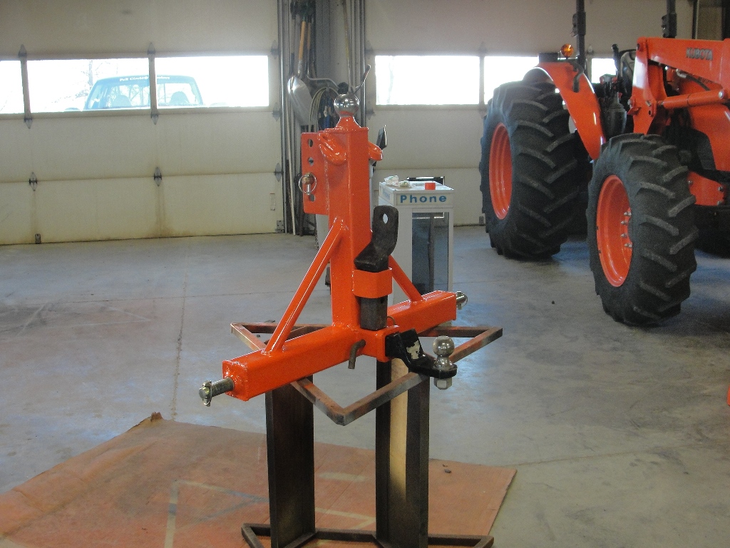

I built this hitch assembly a few years ago which works very well on the 3pt. But you risk it rising. Has never been an issue for me and I use it a LOT.
   / Drawbar for pulling pinned or ball trailer #4
Titian Attachments has several models. I got the one that will work with my goose neck, has spots for hay spears, and the receiver hitch.
ovrszd - I love your set up, especially the pocket to store the spare pin hitch. May I borrow that idea and get mine modified? I keep forgetting where I put mine.
