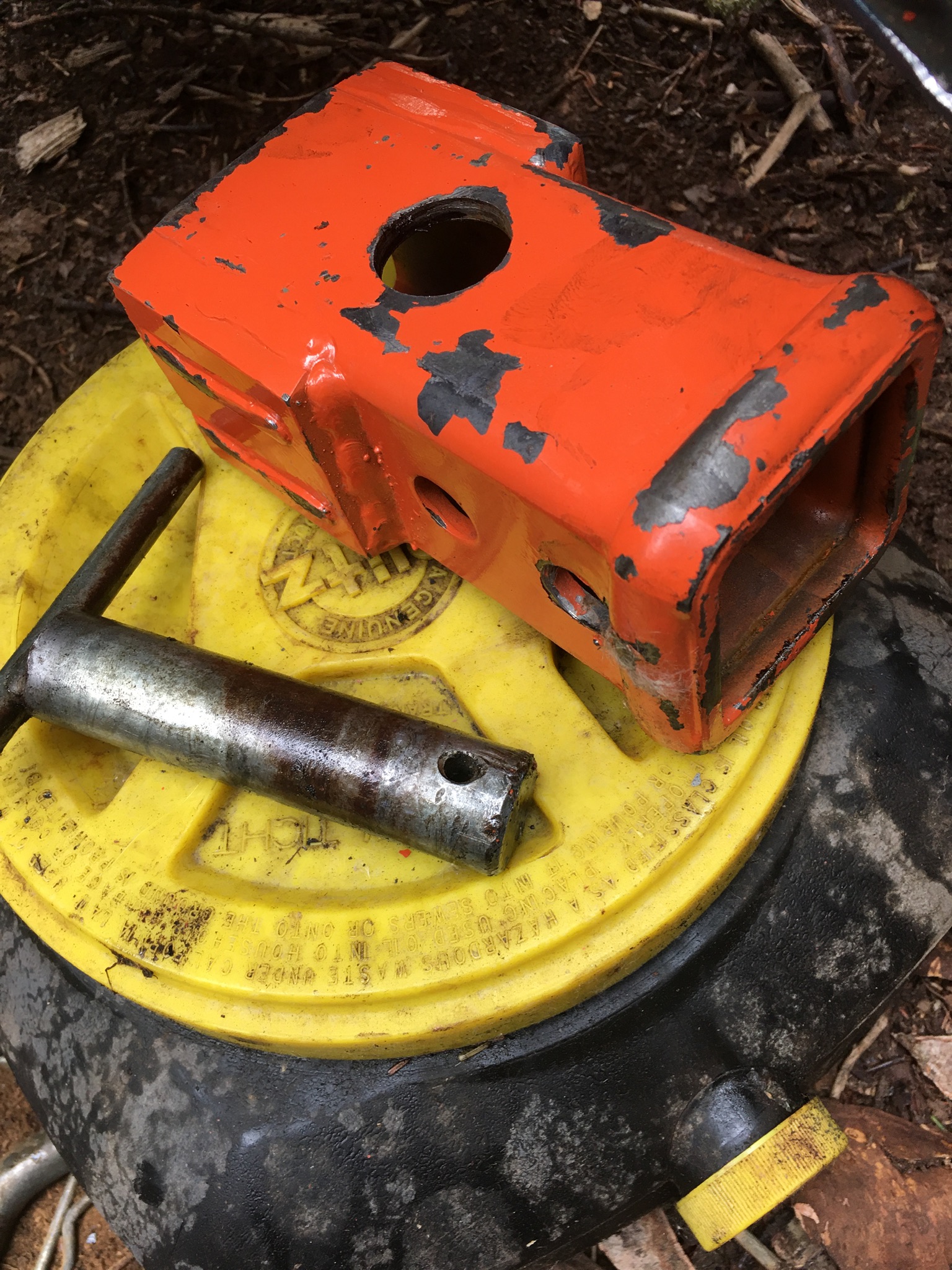

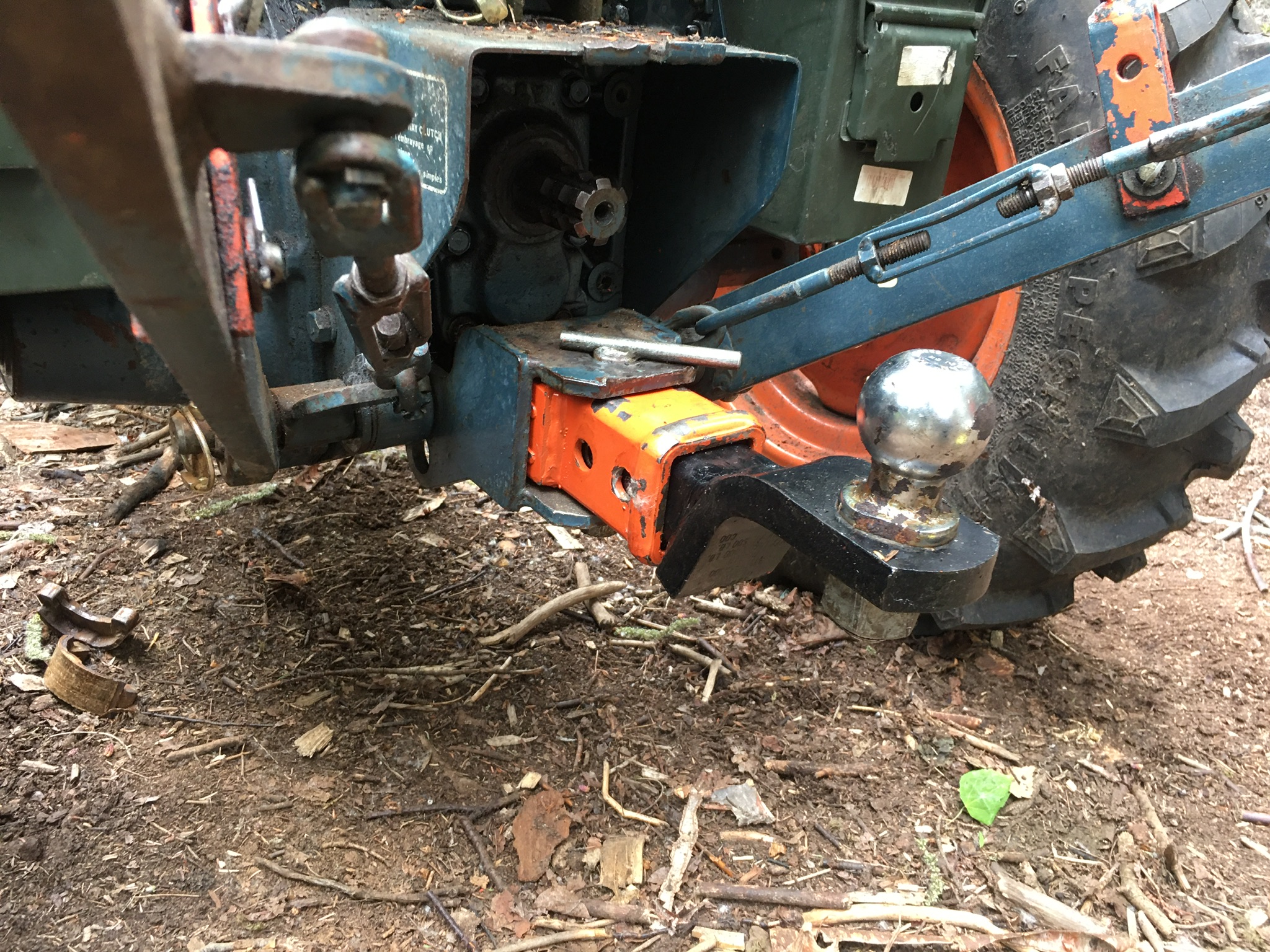

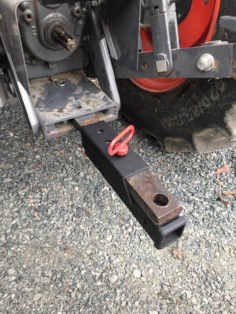

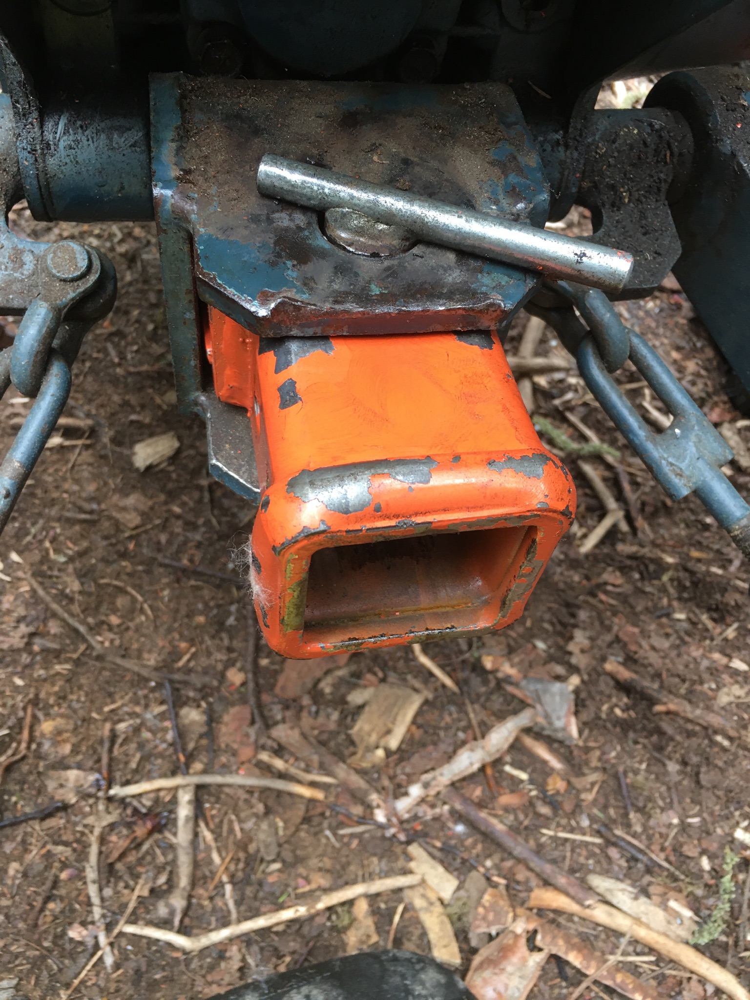

While Im at it I made this handy little adapter to put in the draw bar hitch of the B6100DP to adapt to a 2 inch attachment. It’s just a 6 inch or so receiver with 3/8 inch cheeks welded on the sides with weldments on those to fine tune the width and tighten laterally with the pin inserted. the concept will work on anything with a drawbar with some mods I guess. Here you go-
I put the pin in upside down so the clip doesn’t come out in heavy growth ground cover but here it’s in normal for the glamour shots lol

:thumbsup: Gooder-un.

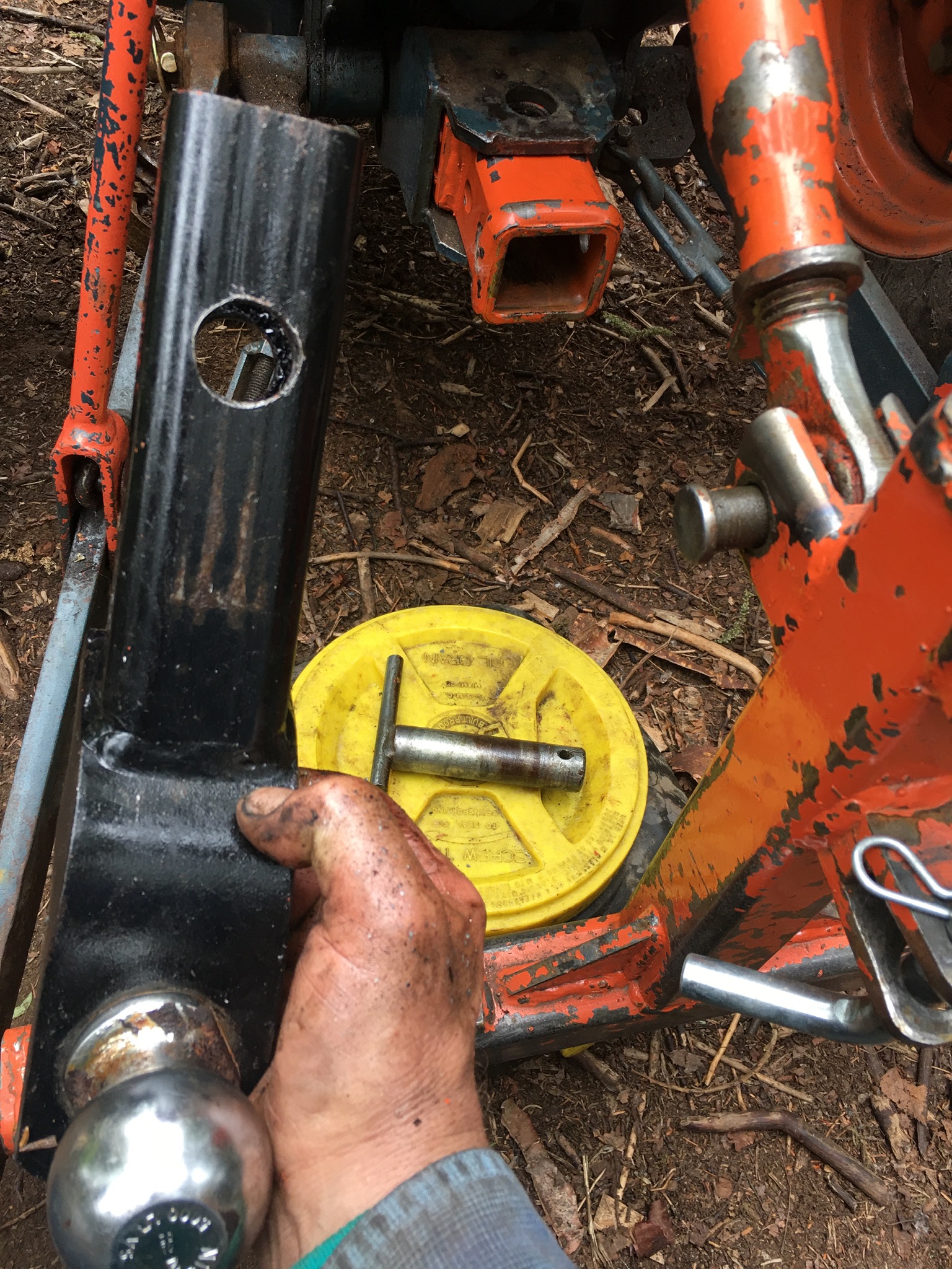

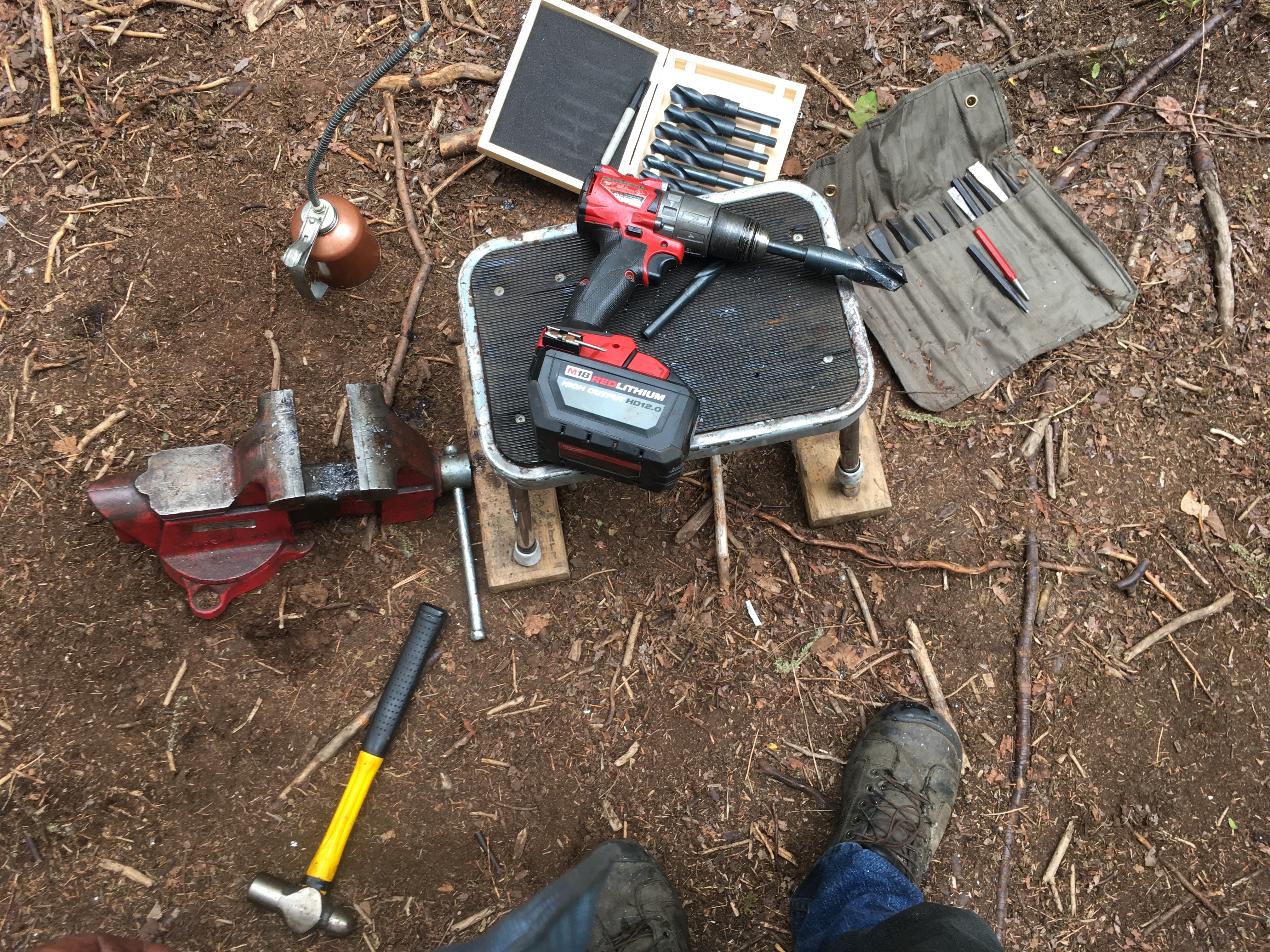

Here's the tools used (I'm off grid) and then a shot of the hitch being used on my new Muts Trailer! That thing is great, what a purchase:) I just chain the three point up out of the way and use the hitch which is right up close between the rear wheels.

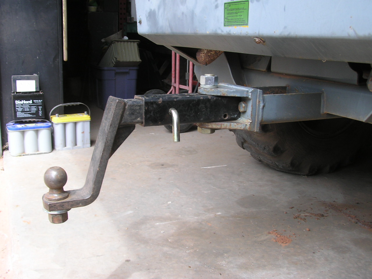

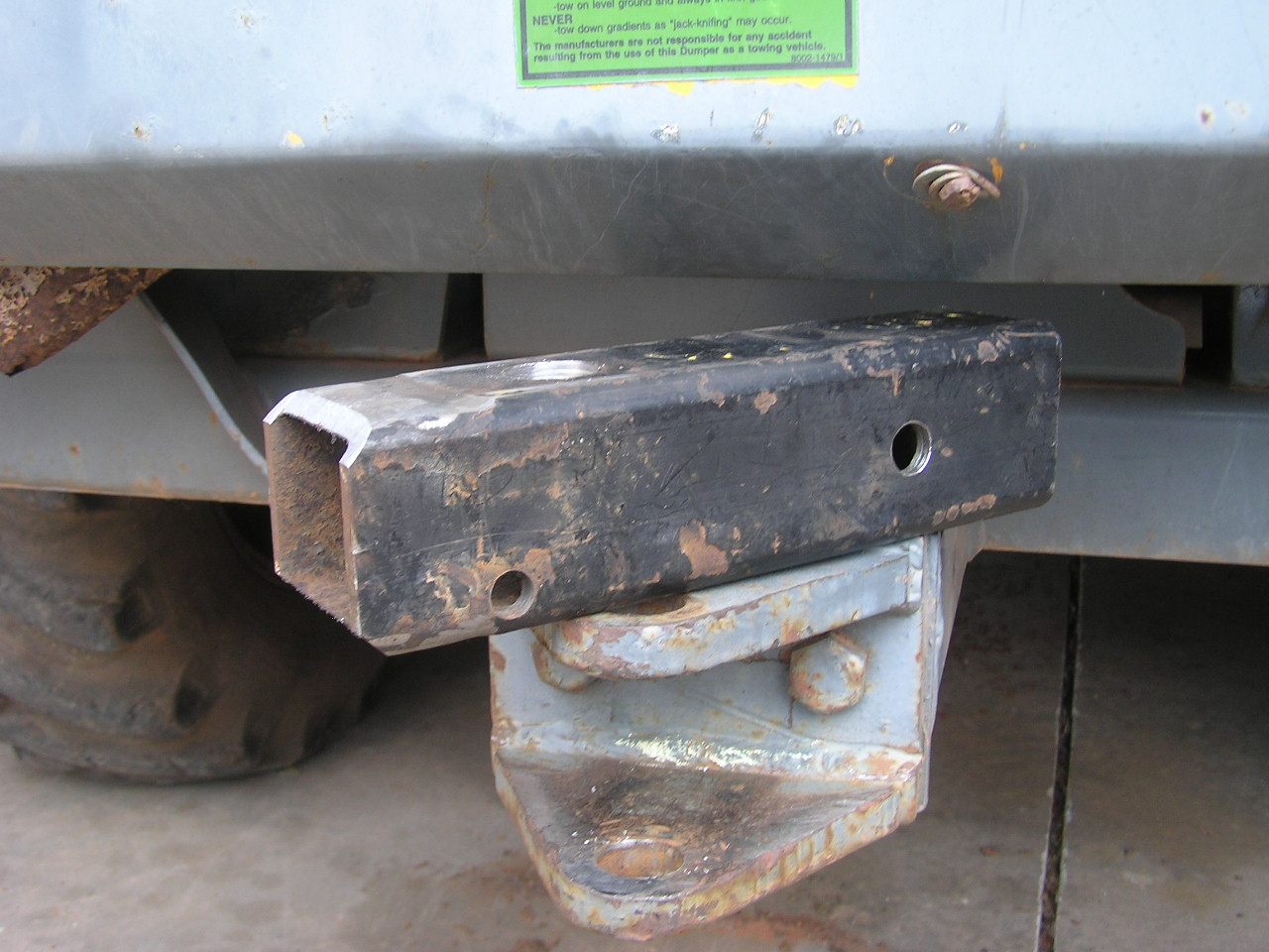

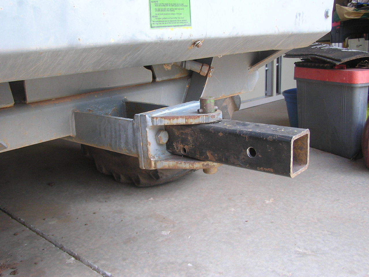

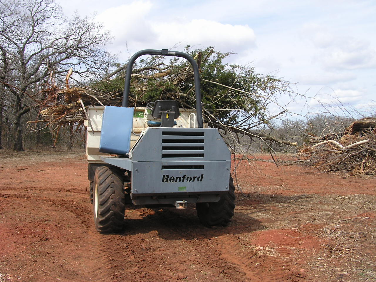

Your hitch project reminds me of the one I put on the Dumper:
   / Drawbar hitch to 2 attachment adapter #6

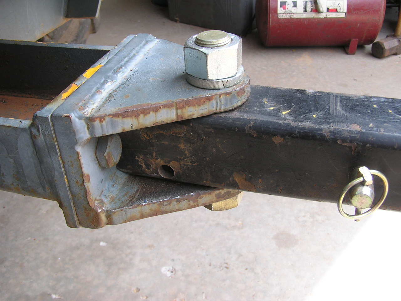

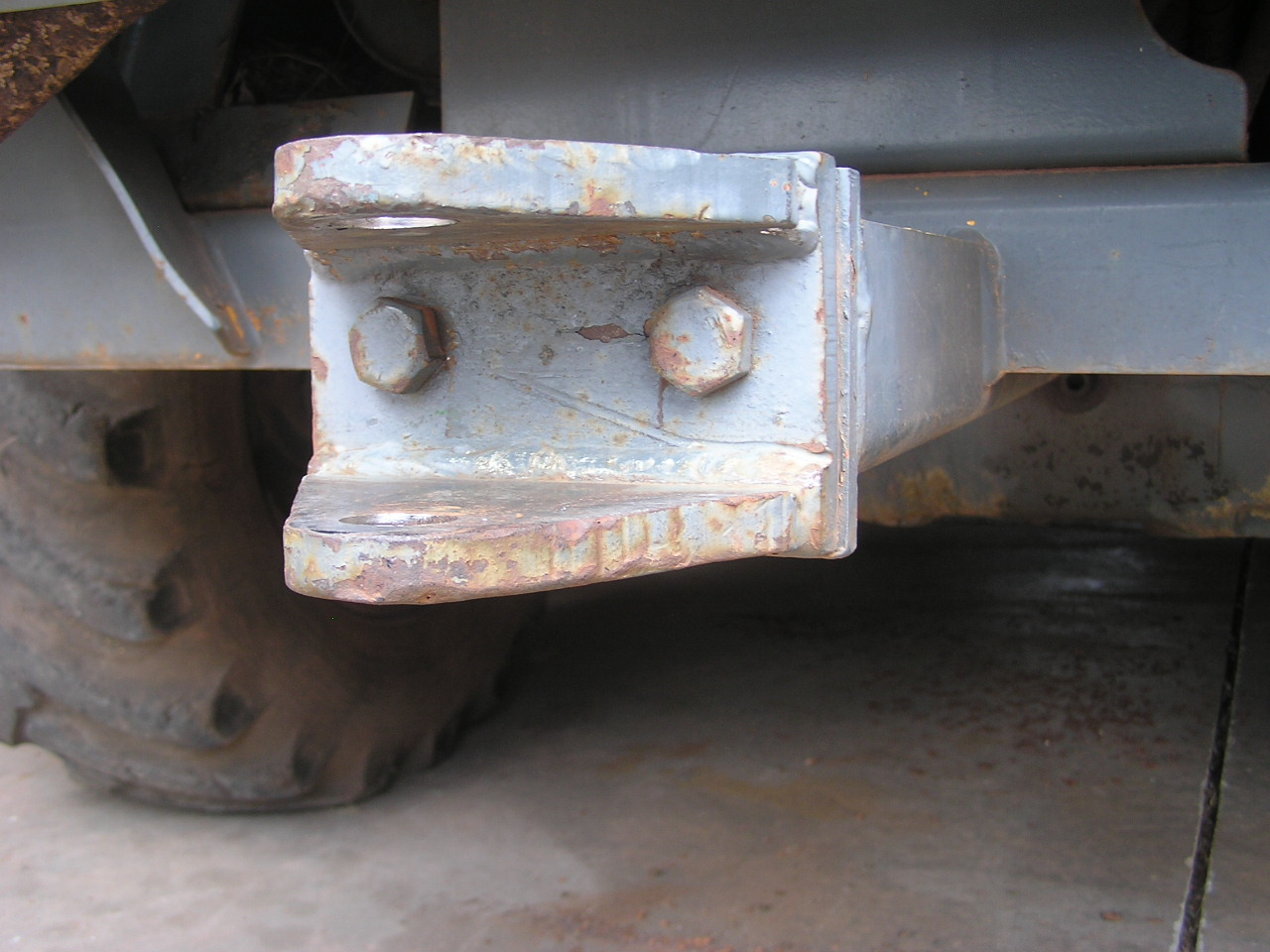

freezerburn, nice idea! thanks for sharing. It seems not too many aftermarket options for things like this, most searches point to a 3ot hitch trailer mover.
I've posted this elsewhere, but i will again for the searchers...
just slides over the drawbar to use 2" receiver accessories.
   / Drawbar hitch to 2 attachment adapter #7
Freezer Burn. Innovative design and great fabricating.

Nice one Xfax, the grade 8 bolt heads capture the piece. Thats cool. I see I'm not the only one to get outside the box. It's where I belong.
Thunder chicken that is a clever design. and the draw bar stays put the whole time. Yeah!

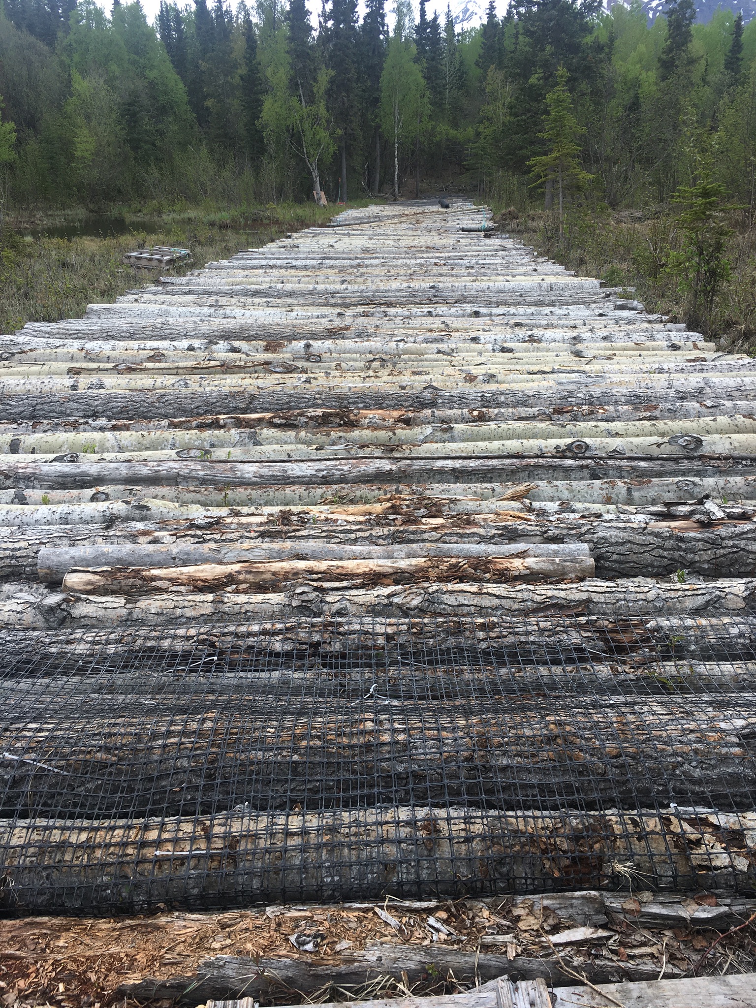

That is one heck of a corduroy road you built. Is that a swampy area or what?
Hello fruitcakes, that is about 1/8 of the road is all. Heres a pic I couldn稚 upload any pano shots so this is about 220 feet is all. The road is laid in there and I am now in the process of leveling it:) But the road is over 300++ feet long and is a grueling process and yes I am crossing Muskeg/wetland.
