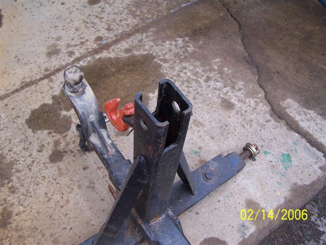

tried a search but not really sure how to describe what I'm looking for.
Basically my father-in-law is wanting me to make him a drawbar with a ball mounted on one side of the square tubing, then a 2" receiver on the next side, then a 2 1/4" ball on the next side..etc, etc...you get the drift. Who here has already made one? Tips? Ideas?
Thanks

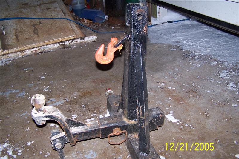

Make yourself a 3 pt. receiver similar to this then just buy the slide in the has a different size ball on each side. I already have several individual slide ins for 1 7/8", 2", 2 5/16" etc. that I move my trailers around with.

   / Drawbar modifications #5
George,
Like your hitch, but curious how the top link hooks up. Doesn't look like anything I have.
THKS.
ron
   / Drawbar modifications #6
Ron,
The top of the square tubing is notched on both sides to accept the standard adjustable top link of the 3 pt setup. I just drop it in and put the pin thru. I've attached a close up of the top link. The bottom is a standard drawbar.
George

   / Drawbar modifications #7
Thanks!
That cleared it up for me.
ron
