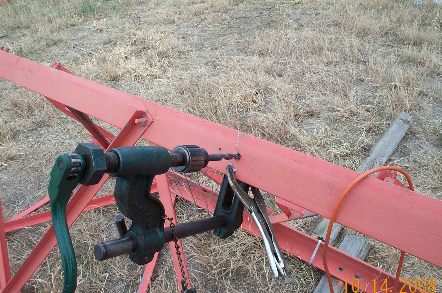

many people make a jack shaft and reduce the speed on shop drill press more than the factory settings,
on large holes that is to fast IMO, but on small holes it will work fine, keep some coolant on the bit,
I have never have over heated a bit using this press,
