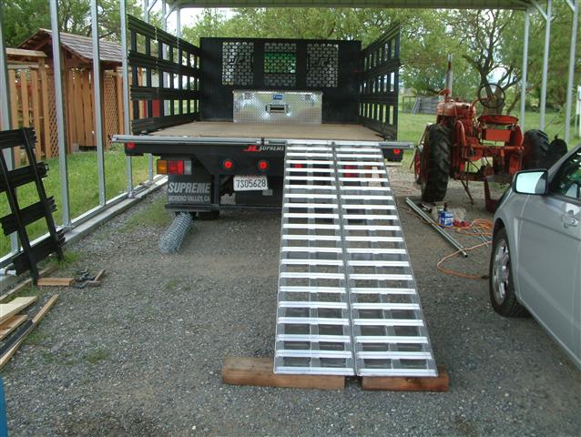

Or, consider aluminum ramps like these
Automobile Trailer Ramps & Ramp Systems
I use 10 ft long x 16" wide aluminum ramps to load my parade tractors onto my Isuzu NPR stakebed. Like you, the max weight of my tractors is about 3500 lb. Those ramps weigh 49 lb each and are rated at 5000 lb per axle (8500 lb max).

I think they are talking about ramps to drive a car onto to get under it (like this) rather than ones to load something with.
