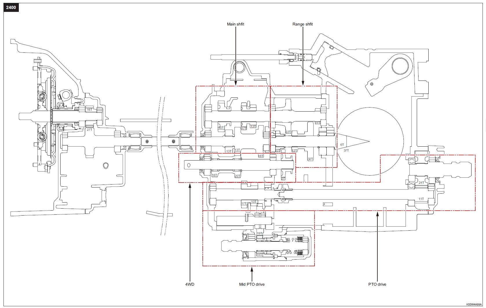

Branson 2400 manual gearbox. I have a clacking noise in the drivetrain when the clutch is engaged. It occurs even with all shifters in neutral and regardless of MFWD. Occasionally it will lock up and kill the engine, again even in neutral. If I disengage the clutch and lay underneath I can reproduce the noise by hand spinning the propeller shaft. Unfortunately I can't figure out which end the problem is coming from without removing it, because it carries the sound. Does this sound familiar? Could it be a ball joint at one end or the other?
   / Drivetrain clacking and locking up #2
From your description, looks like the noise comes from inside the transmission and most likely it's a broken tooth on one of the gears. Once it gets to that particular spot, it either kills the engine or makes a heck of a bad noise.
I was checking the service manual for that tractor and looks like that tractor uses sliding mesh style transmission, which means the gears will slide to engage whatever gear you choose.
This kind of important because you mentioned that it will do it even with everything in neutral. With that being said, the only other gear that will be spinning while everything else is in Neutral is the reverse idler gear. I suspect this is where your problem resides, either a broken tooth on the idler gear or a broken tooth on the gear of the primary shaft that meshes with the reverse idler gear.

The noise was initially worse in reverse. Does that support your theory? I wonder how that could have happened?

Bought it used. It has 220 hours. Is it reasonable to fix it myself? I'm pretty mechanical, but never worked on a transmission.
   / Drivetrain clacking and locking up #7
I believe this is the correct service manual for your tractor. It might give you an idea if it's something you can work or not.
I was going through that manual and found out that that model has the bellhousing separated from the actual transmission and rear end. Then just uses a subframe to connect everything together.
On the bellhousing side, it has a gearbox with just two gears. There is a possibility that your issue may be there too. One way to check, is to disconnect the shaft that goes from the bellhousing gearbox to the input shaft of the transmission. Then with the clutch depressed like tested before, rotate the shaft of this bellhousing gearbox and pay attention to any weird noises or something weird while rotating.

That was going to be my next step. (Just waiting for the temperature to drop.)
